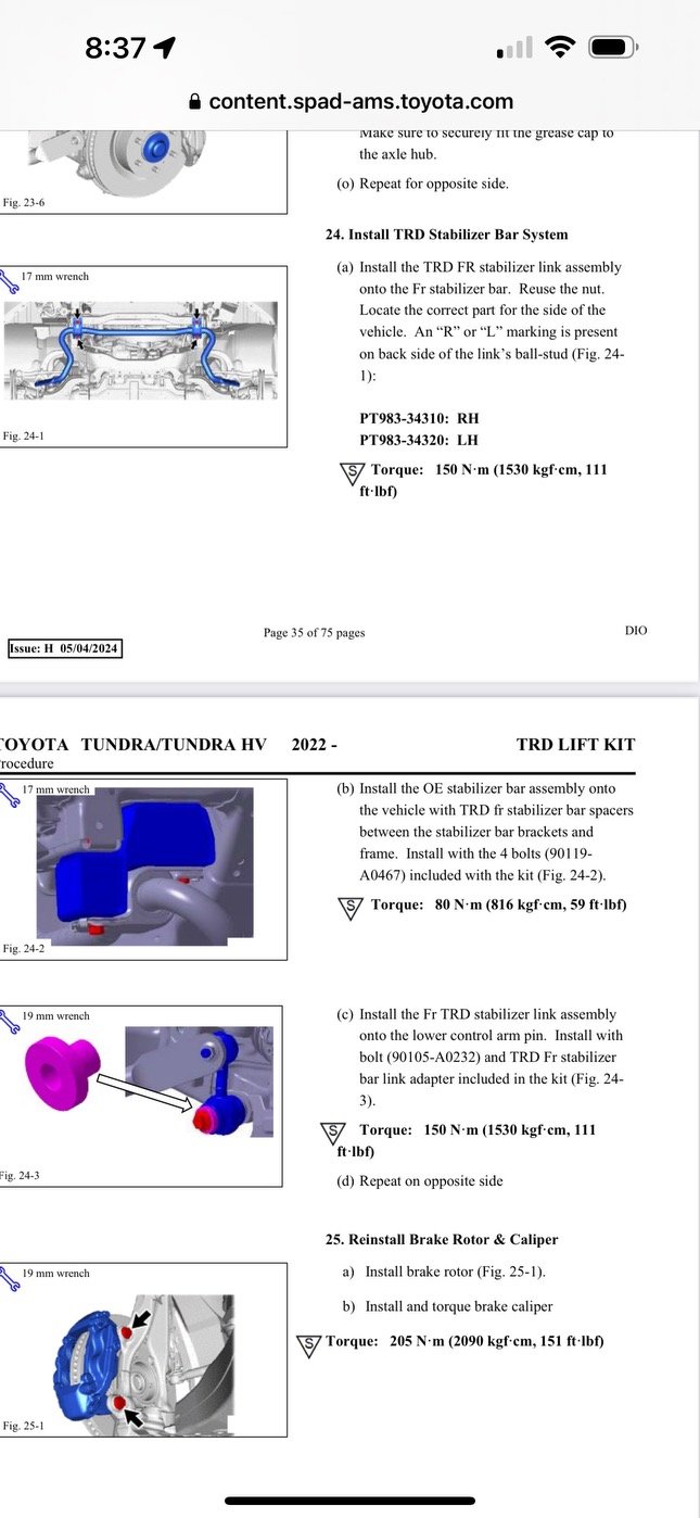

    I read the doc. as I should have the first time and here is what I identified.
    Fig 24-1 spec's a 17mm which isn't the correct size for either end of the sway bar end links, both are 19mm.
    Fig 24-1 points to the stabilizer bar brackets which in fact are 17mm, but should be torqued to 59ft lbs. per fig 24-2.
    Step 24 specifies how to install the stabilizer link to the stabilizer bar.
    My suspicion is this is a mistake on Toyota's part.

    Front sway bar links are 111ft lbs top and bottom? So the connection to the lower control arm torques to 111 and the top half of the link that is connected to the front sway bar is also 111ft lbs?
