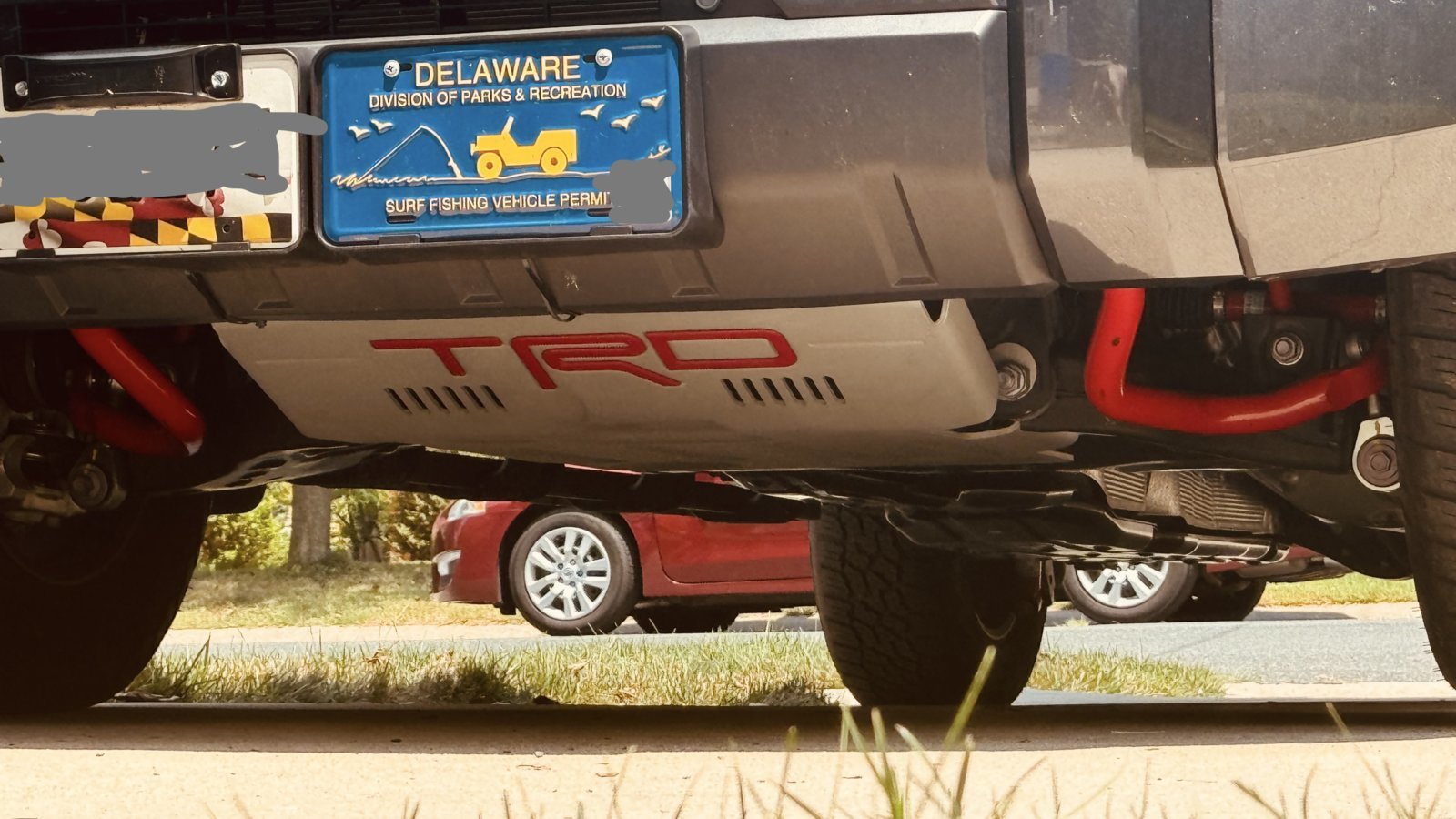

    Anyone have torque specs for the rear upper links for 2023 tundra? Highlighted in red

    The ones highlighted in red are the lower links

    Damn, you’re right! Lol thanks! I’ll go ahead and highlight the uppers!
