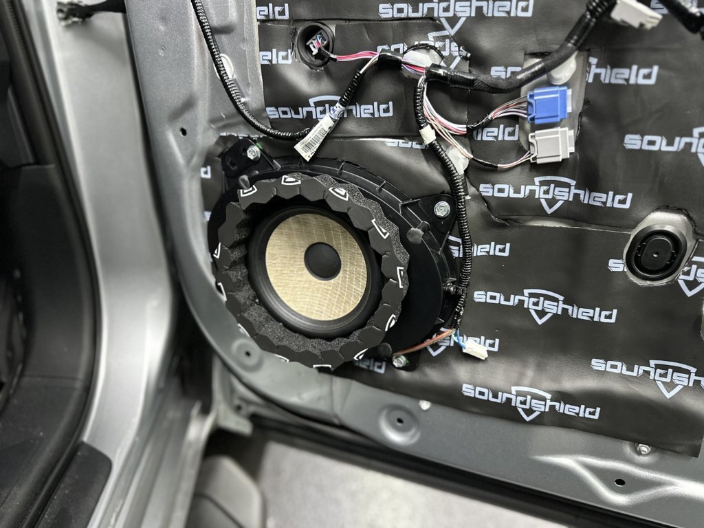

    I went with Focal PS165 F3E up front so that uses a 3in driver in each corner and then disconnected the OEM middle driver. I added the JBL a pillar sail to keep everything OEM looking

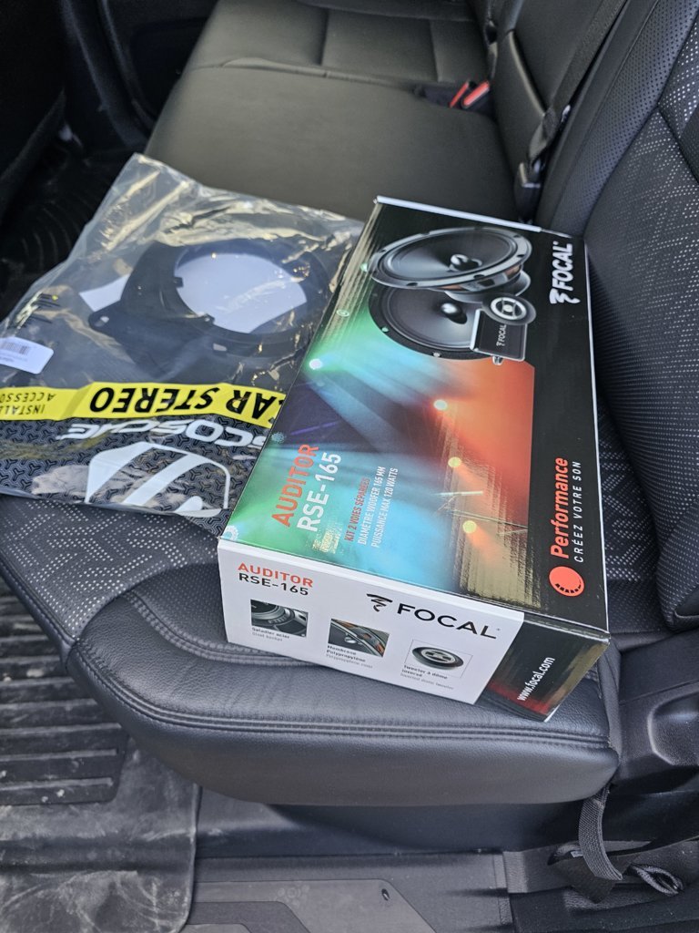

    Well, first set is delivered today, will install front ones first

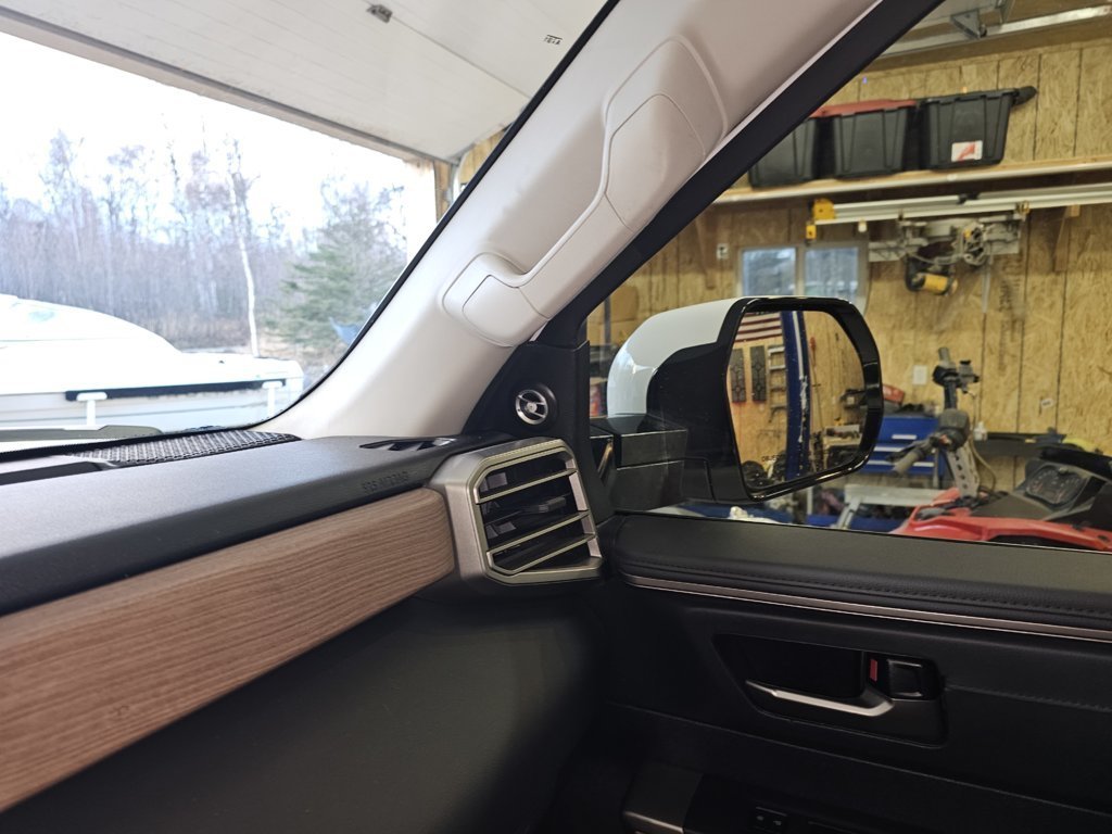

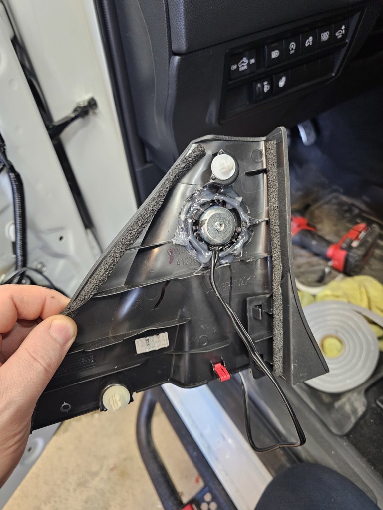

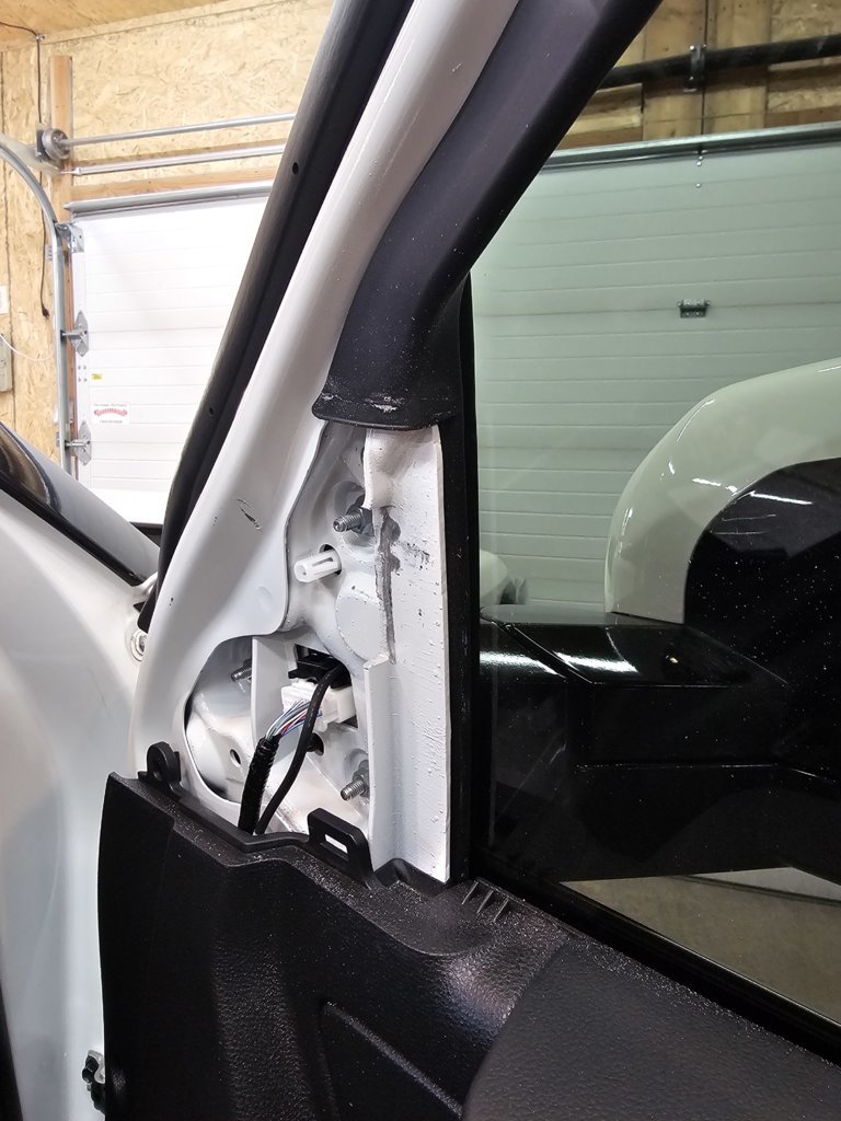

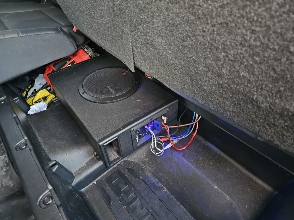

    Well, good news and bad news.

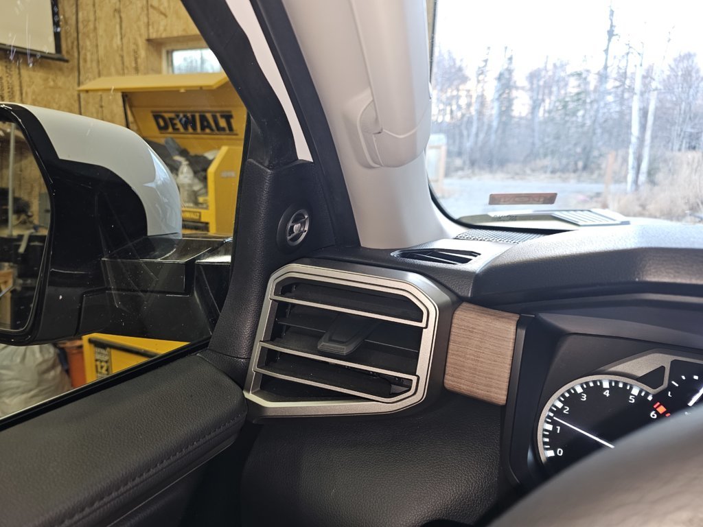

    BAD NEWS: The Focal speakers don’t sound good with the OEM head unit; they really need an amp to perform well. Surprisingly, the stock door woofers without an amp sound better than the Focal ones in this setup.

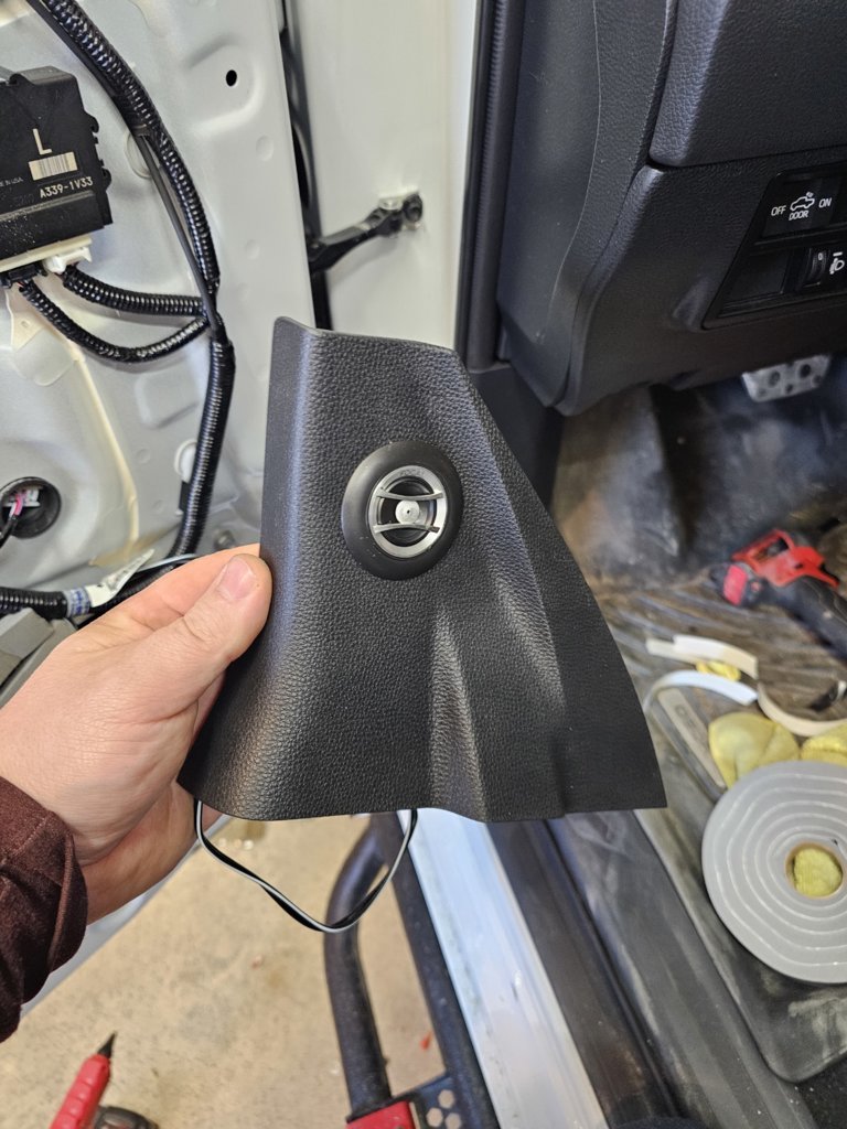

    GOOD NEWS: I did a bit of experimenting and "Frankensteining." I installed the Focal crossovers and tweeters but connected the stock door speakers through the Focal crossovers. Wow! Now I have the highs I was missing, and the sound is night-and-day better than before. I installed the tweeters in the upper corner of the front door trim (the part covering the back of the side mirrors).
    To install the tweeters, I used a 1-3/4" hole saw to cut through the plastic and an oscillating tool to trim the aluminum behind the tweeters. I secured the tweeters in place with a hot glue gun.
    The tweeters made a massive difference—they fill in the missing frequencies from the stock sound. Now it feels like I’m at a concert! My wife has the Mark Levinson system in her Lexus GX460, and even she says my Tundra sounds better now (though she mainly listens to instrumental music). Personally, I still think her system has the edge, but I’m thrilled with the result.
    Overall, I’m very satisfied—this is the best $150 I’ve spent on a sound upgrade ($129 for the speakers and $17 for the hole saw). I’m not sure what I’ll do with the leftover 6.5” Focal woofers, though. Maybe someday I’ll install an amp for them, but honestly, I’m so happy with the sound now that I probably won’t bother.
    Just FYI: I’m not an audiophile—far from it—so I’m sure some people with high-end setups might laugh at what I did. But this works great for me, and I’m loving my audio system now. (For context, I do have an 8-inch powered Rockford sub under the rear seat.)

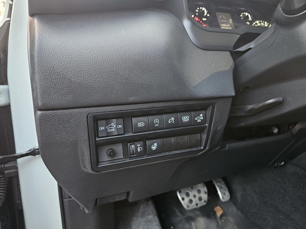

    I also installed a bass control knob in the blank switch area on the left side, below the steering wheel. I just drilled a hole in the spot intended for the LED light bar switch in the TRD Pro.
    Here’s my complete setup so far (around $480 total):

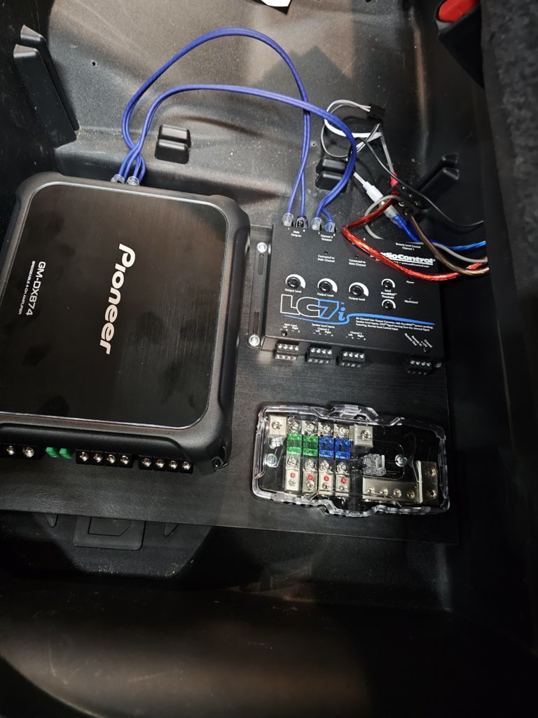

    I can't stop lol, still going ''cheap'' route , so far around $1000 down in the drain
    today got this
    https://www.amazon.com/AudioControl...8-1-spons&sp_csd=d2lkZ2V0TmFtZT1zcF9hdGY&th=1
    this
    https://www.crutchfield.com/p_130GMDX874/Pioneer-GM-DX874.html
    this for dash speakers ( to be in parallel connection with doors)
    https://www.crutchfield.com/p_20651KSC27/Kicker-KSC270.html
    this
    https://www.crutchfield.com/p_541LPHTY02/PAC-LPHTY02-LocPro-Advanced-T-Harness.html
    and this
    https://www.crutchfield.com/p_541LPHEX17/PAC-LPHEXT17-Speaker-Harness-Extension.html
    IDK how its going to sound, will see
    so far dash speakers getting replaced, door speakers and tweeters installed , powered sub and amp installed , in line convertor, amp to power up speakers etc ....

    Man, car audio upgrades are expensive! I went for some budget-friendly options, and it still added up to around $1,055. Here’s the breakdown:
    Speakers (Focal for front and rear doors, with tweeters): $130 each x 2 = $260
    Subwoofer (Rockford Fosgate with built-in amp): $280
    Front 3.5” Dash Speakers (Kicker): $80
    Wiring Harness, RCA Cables, Power Cables, etc.: $140
    AudioControl LC7i (6-channel line output converter): $125
    Pioneer GM-DX874 Amp (4-channel, 100W RMS x 4): $170 on sale (regularly $269)
    Total: $1,055 for a "budget" upgrade—crazy!
    I’ll get the rest of the setup installed by the end of the week and give you the verdict on whether it’s worth it (probably not… but who knows?).

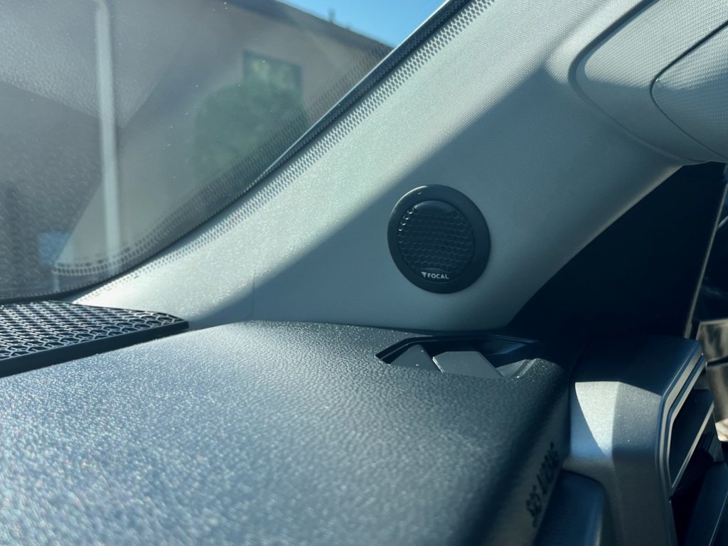

    I got the Focal 165 AS3 3-way installed up front. I was really thinking about getting the JBL a-pilars, but I don't think they look bad. It helps that they match the dash.
    Running everything through the Kicker Key 200.4 which does the auto-DSP thing, and that really makes things sound nice. With it off, I don't love it, but with it on it is a huge improvement.
    The passive crossovers are pretty big. There is a lot of room, but on the driver's side, I got a lot of interference/noise in a few places. I found a good spot for now where I get a little bit right at ignition for about 2 seconds. There are a lot of OEM wire harnesses in that area.

    Amp arrived with one non working channel. Is crutchfield pretty good about returns?
    Other than that system sounds great, had to built little amp rack under rear seat.
