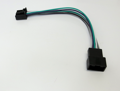

    So, in theory I'd need a harness like this. It apparently pulls the audio feed from a rear speaker although I understand you think the front would be better choice. And one other thing I am not clear on... I see many of the sub amps and powered subs are "auto on". Does that mean that they turn on and off from sensing the audio signal and do not need a dedicated 12v remote turn on wire?
    I need to go measure my rear seat storage bin. I see plenty of nice compact 8" and 10" subs that might fit there... and I'd probably go with one of those and a separate amp. But I need to go look up on how to take the dash and console apart to make the connections and run the wires. PITA to learn a new vehicle... and this one seems very tightly sealed around the head unit space. I can also see myself upgrading the OEM speakers at some point. But probably not amps for those, as the factory unit is plenty loud enough for me. I had Focals in my Tacoma and loved them.
    2022+ Tundra p&p add a subwoofer harness at Taco Tunes. (link won't work)
