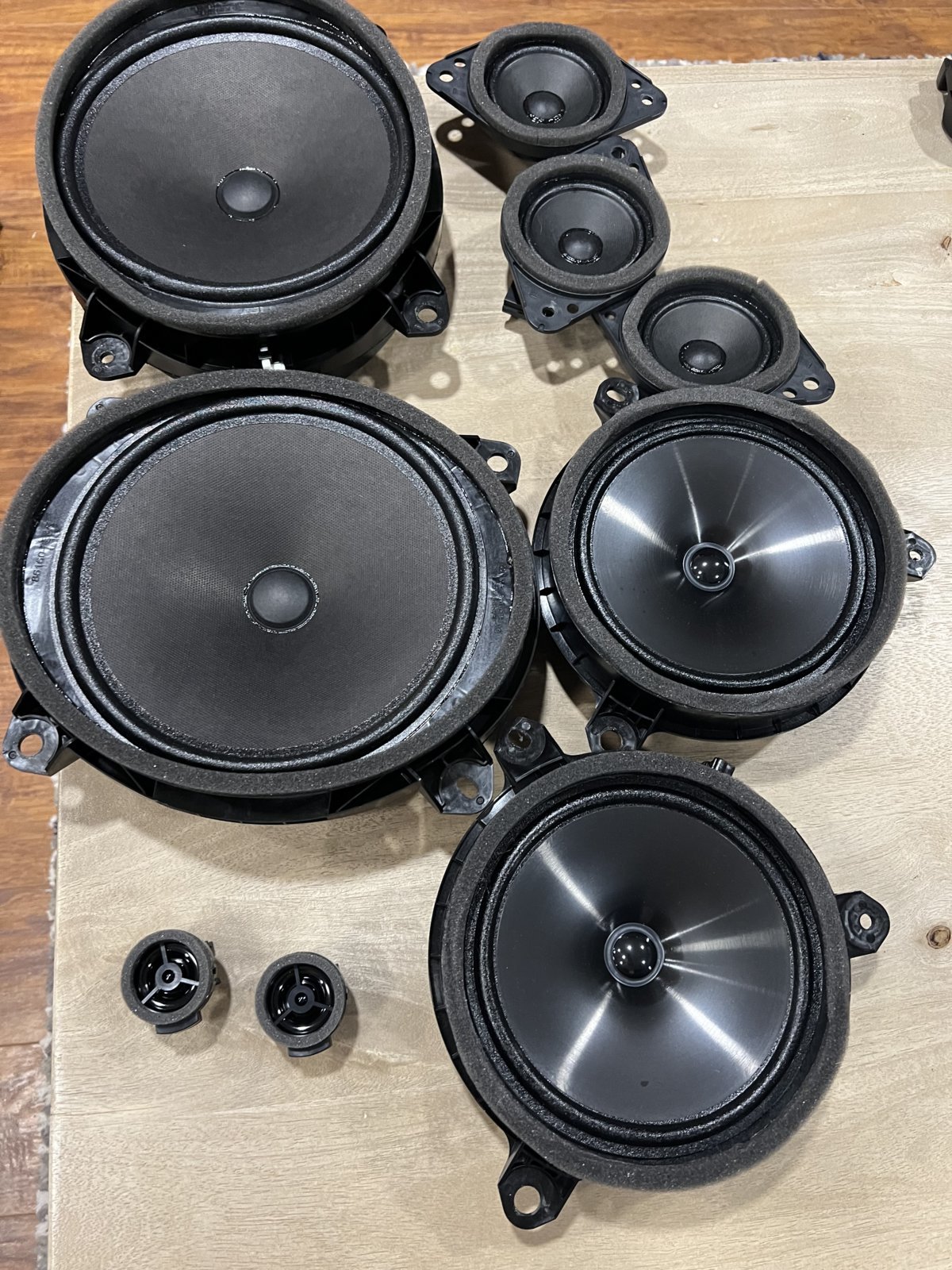

    OEM Speaker configuration question: I have an SR5 with the "Premium audio" option, 14" screen, etc. It looks like I have a center speaker in the dash... at least there is a speaker grate cover there.... and the 2 in the dash corners. So, 2 in the front doors, 3 in the dash, 2 in the rear doors would make 7. From page 1 of this thread, the 9-speaker system supposedly also has 2 tweeters in the rear, but I don't see any in my rear doors?? So, how many speakers do I have??

    There’s 4 tweeters, 3-3in in the dash, 2-6.5s in rear, 2-6x8 in front. The JBL adds a sub in the rear and moves 2 tweeters in the front door to the A pillars

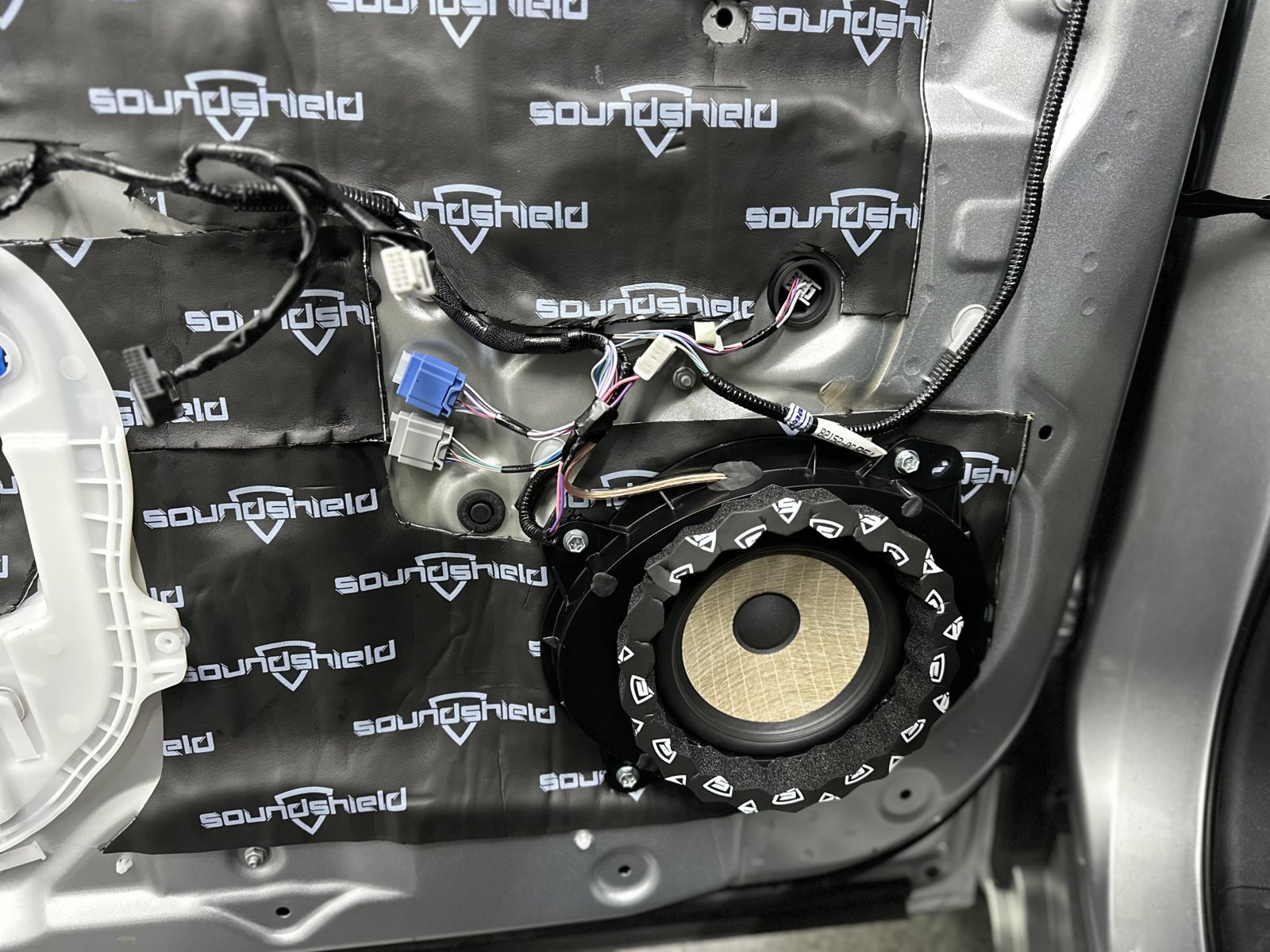

    I was reading the table on the first page that lists 6 and 9 speaker non-JBL systems. It appears to me that I have 7 speakers?? I do not see any rear tweeters that the table says the 9-speaker system has.
    BTW, I've been meaning to ask you how those Focal 3" fit in the dash? Modifications necessary? Or not?

    The DC probably has a different config than the CC. Did you pop the center grille cover to see if there was actually a speaker there? If not, you have the 6 speaker system. 6x9 in the doors, 2 3/4's in the dash and 6.5 in the rear doors. Just like the 3rd gen Tacomas

    I have not actually popped that front cover off to look. Heck, 6 speakers is plenty, especially after they are upgraded. At least we don't have anything really wacky like the rear ceiling speakers in the headliner of my 2009 Tacoma Access Cab.

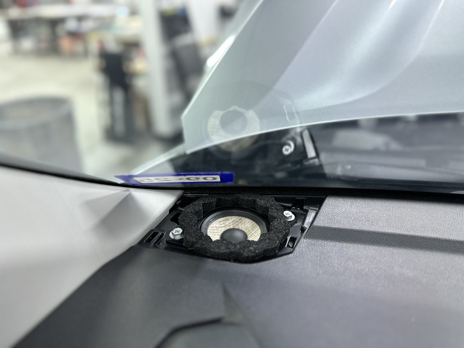

    None of the front doors come with tweeters. The JBL adds a tweeter to the a pillar in addition to the 2 3/4 midrange in the dash. I know the premium system with the larger screen has the center channel and tweeters in the back doors added, but that's on the Crew Cab, the Double Cab likely has a different configuration

    Right, I knew that. I'd add front tweeters, probably using the JBL A-pillars. Probably would not add tweeters in the rear.

    I had these speakers in my Tacoma, you could use the same ones, they are a direct drop in, no modifications necessary-
    Kenwood Excelon KFC-XP6902C for the front
    Kenwood KFC-1696PS for the rear

    Those look pretty good. The question is what to do with the tweeters, cross them over from the front door and mount them in the A-pillars... or maybe mount them in the dash corners using the OEM signal there. But I am not sure what signal those get from the H/U or if it would be appropriate for tweeters?

    I would try those first before adding tweeters, you may feel like those are enough. I had them in my Tacoma with no equalizer for 3 years and was satisfied with their sound. Adding the tweeters later on will be easy. Once you have the JBL a pillars you just mount the tweeter of your choice behind the JBL grille and run the wires and tap off the dash speaker. Most aftermarket tweeters sold separately are going to come with their own in line crossover. Also both the door speakers and dash speakers are tied in at the dash.

    you are mistaken in what I’m saying, or perhaps I didn’t word correctly. What I’m saying is, instead of being in the doors, the tweeters are in the A pillars. To the question about 9 vs 7 speakers. I had 9 with an 8in screen. Not sure what is “premium” about that

    So, how did that Focal 3 way set fit for you? Did the 3" dash speakers go in easily or require mods? I assume the door 6 1/2s went it easily with the proper adapters. I had a set of Focal components in my Tacoma that I really liked so am considering these.

    the 3s fit fine with some plate style adapters and same for the 6.5s.

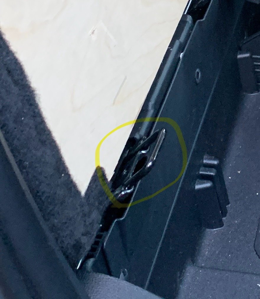

    No, the bin/seat mount frame determined the lower limit. The 1 1/2" angle lets the lids clear the uppermost hard points. So, none of that needs to be cut off... or I guess you could make slots or notches. But that would make for some obstructions in the surface. And the deeper bins are good now that the sub takes one side.
    Edit: Also, the lower edge of the angle sits on a ledge so it can't go lower. If you wanted to do this and preserve the original bin height you'd need some standoff spacers to allow mounting the angle out from the ledge and rotated 90 degrees. Might also need a 2" angle to get low enough. And then probably longer bolts to go through the standoffs to reach the seat mount holes. But that would work... although you'd still need notches to allow those brackets to poke through. Or you could make some brackets that go into the seat mounts then drop down to the bin level, add a cross piece and mount the lids to that.

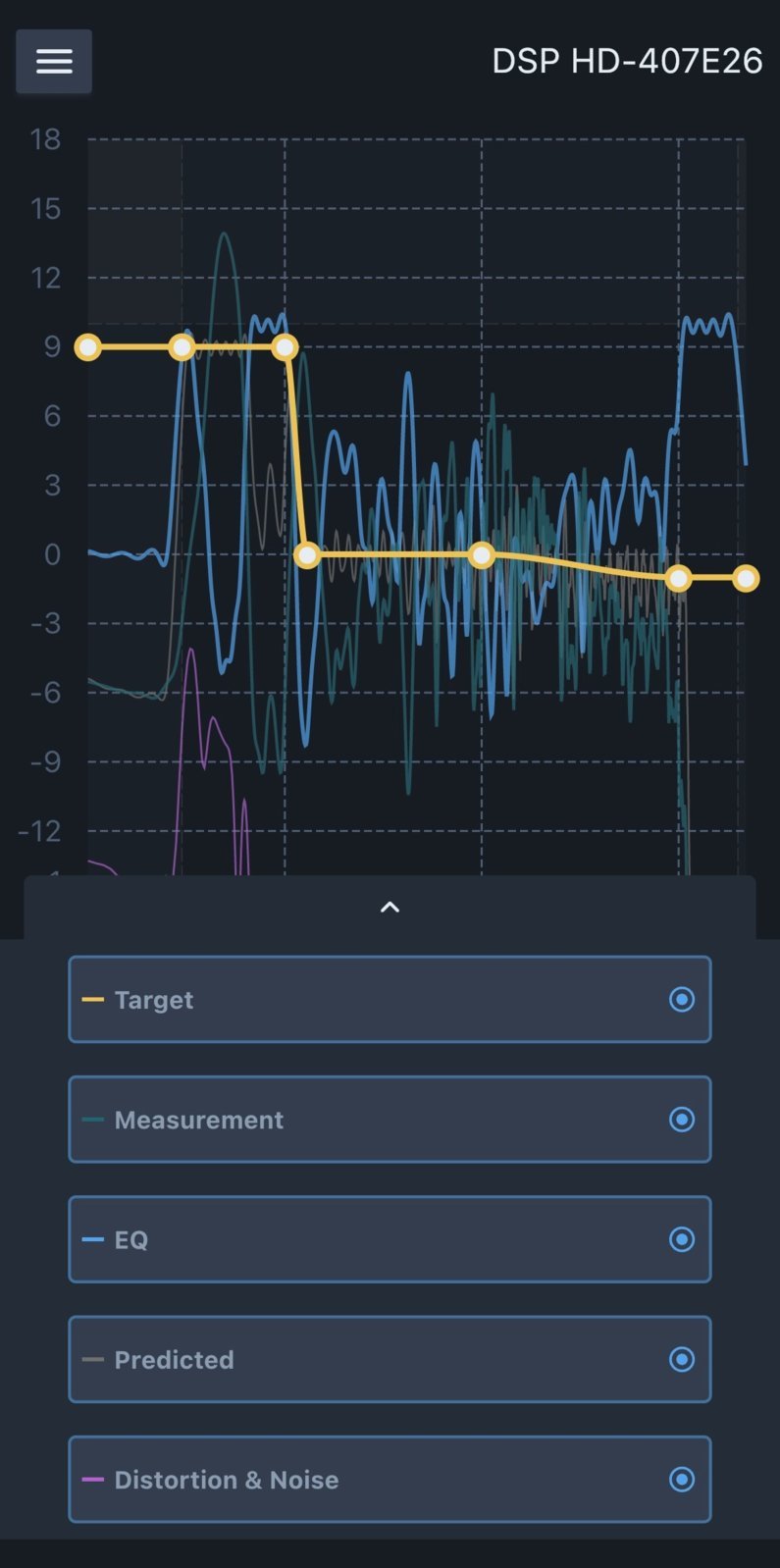

    Regardless of filtering or time alignment, a good DSP can overcome and correct the signals so that you can get the most out of your system. It does require some work and a little knowledge. This is really not anything new, the interior acoustics of a vehicle are always going to be the most crucial variable. Each vehicle has different acoustical properties that will either boost or attenuate frequencies, also known as resonant frequencies. When you throw in the things that the OEM's do such as filtering or time alignment correction it can make things more difficult. I am not a brand ambassador for any particular company, back in my heydays I used to own my own car audio business and I competed in IASCA and USAC and placed in the top 5 of world finals in my power classes. There are and were a variety of companies that produced good products. Sadly some are no longer around, but that's a different story for a different day. I was on several different factory sponsored teams and I've actually worked for 2 car audio manufacturer's. I've been "out of the loop" for several years as I sold my previous business and now I own a business in a different automotive related field now. I can say that Alpine has always stayed on the cutting edge in terms of the front end (source and signal processing) and they still tend to lead in this area today. I personally would not use their amplifiers or speakers because I know they invest more R&D money into things like head units and signal processing. I did a good bit of research into what's available today and IMO Alpine covers a lot of bases. Audiocontrol also still produces good equipment, and they a were actually a sponsor of mine for several years. They have always made high quality crossovers, equalizers, and line voltage devices. Back to the topic at hand, I have the Alpine PXE and it does produce a visible RTA graph. As you can see below in my screenshot there are not a lot of variances (gaps) between the frequencies, which is what you would see on an all pass filter system. The measurements are actually relatively tight. Also, as I stated based upon my own experiences with my 3rd Gen Tacoma, and now on my Tundra the line voltage between the front and rear inputs is different, even when the fader is set to rear only, the voltage difference is significant from setting it at front only. If the system incorporated all pass filters, there should be little difference in voltage output, a time delay or filtered signal does not increase or decrease line voltage. Regardless, the ultimate goal is to be able to correct and tune the system to our own individual liking. Again, I chose the Alpine processor because it is highly configurable and has a lot of tools to help achieve your goals, including a built in RTA, equalization, crossovers, time alignment, anti eq settings, all configurable on individual outputs. There is also an app for iPhones to help get you a baseline starting point if you don't have much experience tuning a system or going into the infinite detailed level adjustments that the Alpine is capable of.
    Here's a couple of videos, one explaining whey you should or should not use a DSP and another from Alpine showing the functionality of their processor.

    Where were the settings for bass, mid, and high on your radio when you were making your adjustments? If you look on my graph above from my truck, I had everything set set flat (in the middle) and although you can't see the frequencies by #'s being covered by the graph table of contents, you can see that the measurement around 50-60 hz has a boost of over 12 decibels and then drastically decreases in the sub sonic ranges 40, 32, 25, 20, 15 hz which is normal. Was your amplifier bass knob up front was turned all the way down? that would likely be the cause

    No, all tone controls, including bass, set to center/flat. I can get more out of the sub by raising the bass, but that, of course is pretty wide spectrum and also boosts the mid-bass, which I don't really need.

    It could just be the built in processor of the amplifier. In my Tacoma I wasn't using any processor, and I ran high level directly into my 4 channel JL amp and used the RCA low level output from that amp to my sub amp. I had to turn the gain on my sub amp up to 3/4's to get a good signal. Even at full gain and volume near max level the signal was not clipping.
