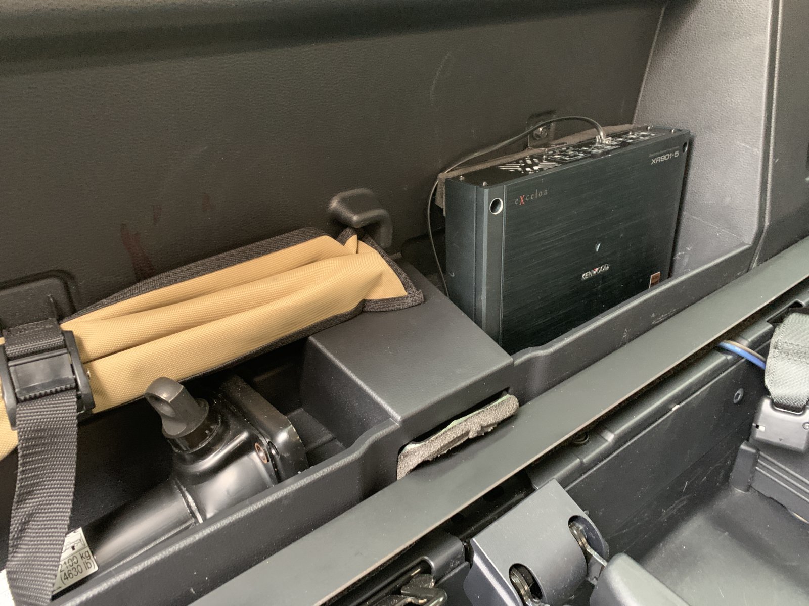

    So, I am waiting on the replacement factory integration 17' harness... looks like it might be a while before it gets here. They prepared the shipment immediately Friday, but it doesn't look like it actually left the premises yet. Dammit. Also waiting on carpet and the sub box terminal fitting from Crutchfield. Anyway, I pulled the seats and am planning the rest of the job and here is what I am thinking. The double cab seat is totally useless for humans, so I am planning to install a 2" angle... probably aluminum... across the back of the bins into the seat mounts. See yellow strip in photo below. Then mount two 24" piano hinges on that and make a pair of plywood or MDF lids for the bins. This will have to add an inch or 2 vertically in order for the lids to clear the welded in tabs at the back. The fronts of the new lids will get some feet or a lip to make them level. Covered in carpet.
    Then since the back panels will be visible, I won't mount the amp there, but instead mount it vertically next to the sub attached to one of those bin dividers, maybe with a thin piece of plywood added for support. This will use up some of the storage space but not all of it. And I am going to also get a swing case for the bed to expand my storage.
    All plans subject to change until it happens. LOL.

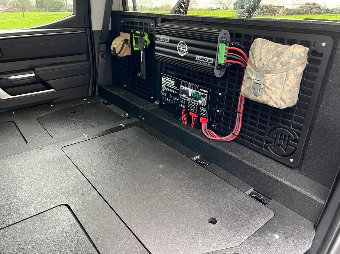

    I don't remember where I've seen it, but someone with a third gen double cab removed the seats (maybe the frame too) to build a whole storage setup in the back seat. It was an expedition setup and had all kinds of storage bins on drawer slides and hinged compartments. I think it was modular and could be removed if necessary. If you're set on ditching the seats, maybe just build a center console to go in the middle. That way you could mount the sub and the amps all in one place and not have to worry about fitting it under the seat. But I guess that all depends on what functionality you're going for. You've got tons of options for sure.

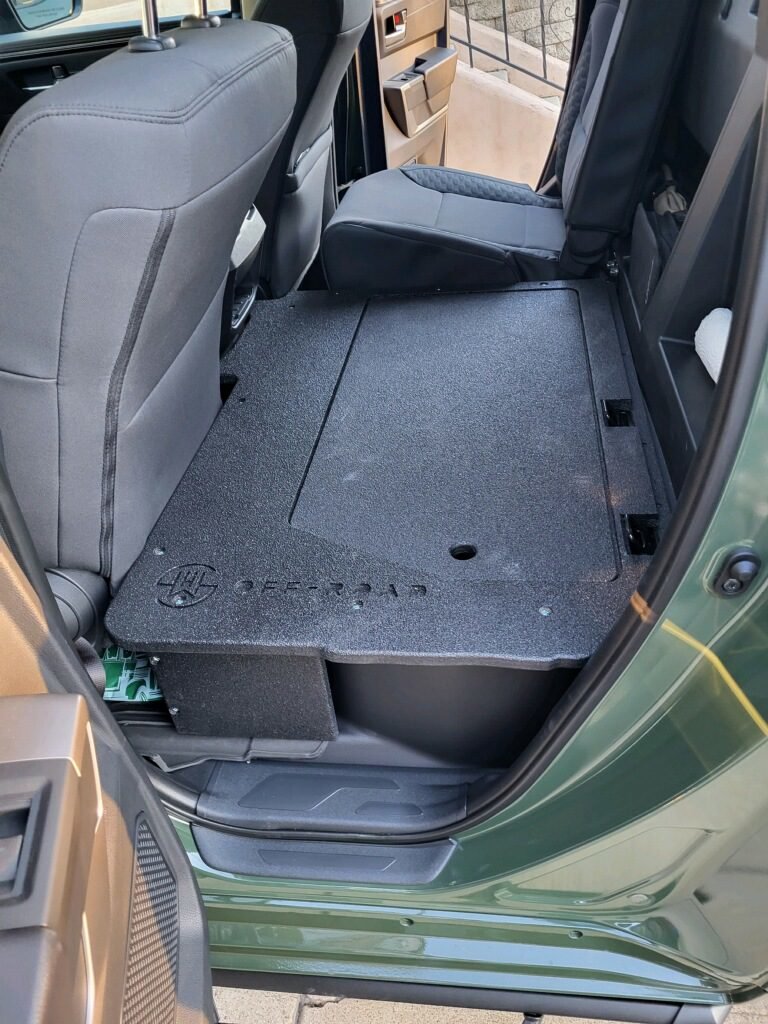

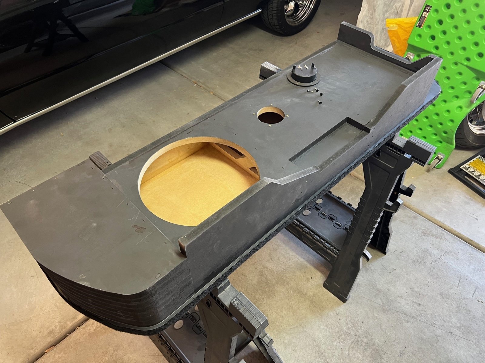

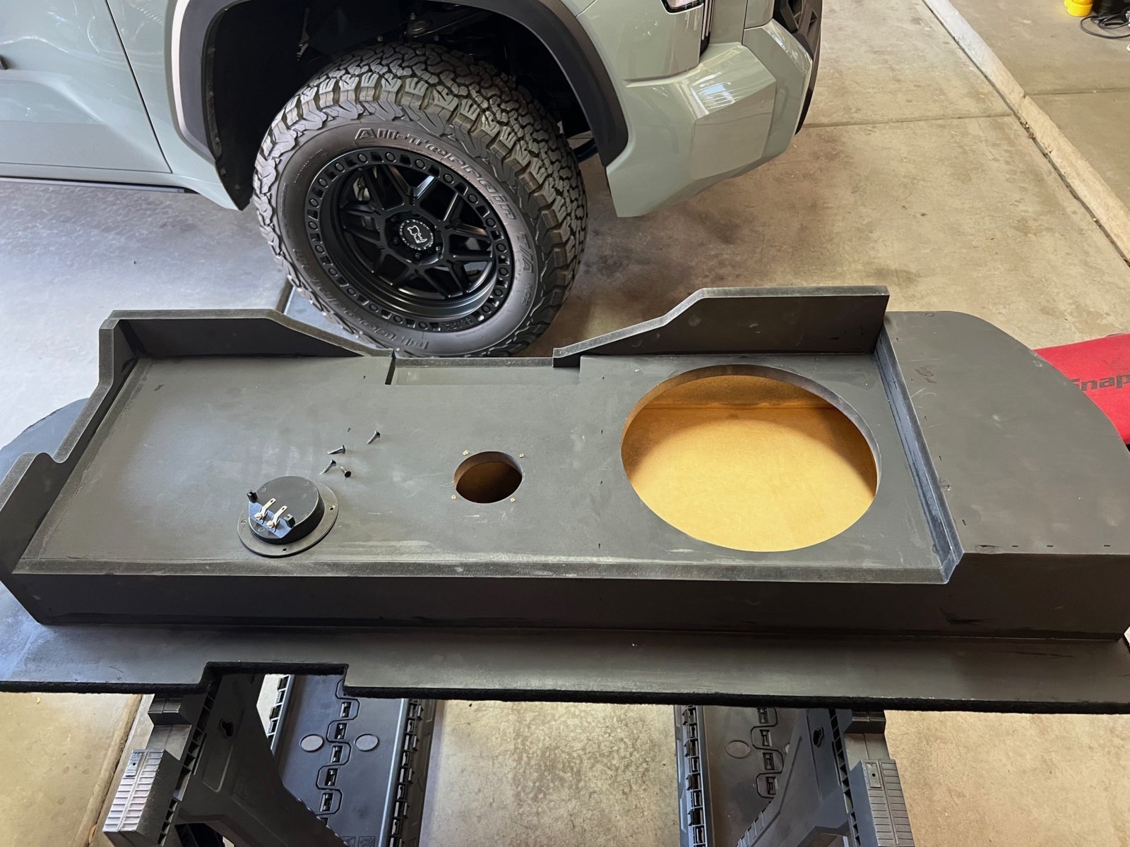

    That's what happens, same with me. Instead of fiberglassing a box into the plastic storage bin this past weekend, I decided to go a different route. Now you can see what I meant if you wanted to take your seats out and have a nice flat base to build additional storage in.

    Here's a couple of examples

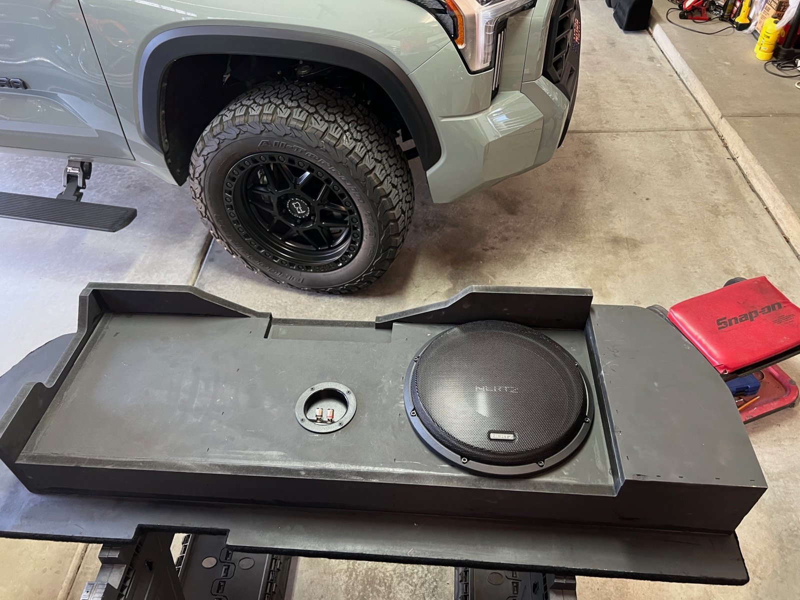

    Did you build that box? Pretty challenging with all those odd angles and protrusions.

    I could have, but I got a smoking deal of less than $300 shipped for this box. The only angles are for the floor cutouts, it's basically a square box and on one end it curved to match the contour of the frame. If you have a router table it's very easy to make those cuts opposed to a jig saw. The top is easy, cut a board down to approximate size, lay it on the frame and trace underneath with a pencil or marker. If I would have bought 2 sheets of 3/4 mdf and a sheet of 5/8 mdf from Home Depot it would have cost me about $160 and probably the better part of 2 days to build. I had originally planned on leaving the bin in place and making a fiberglass mold and securing the top to it, but my woofer would have been upfiring. This was a very cost effective solution for me since I just had to remove the bin, wire the sub and drop it in.

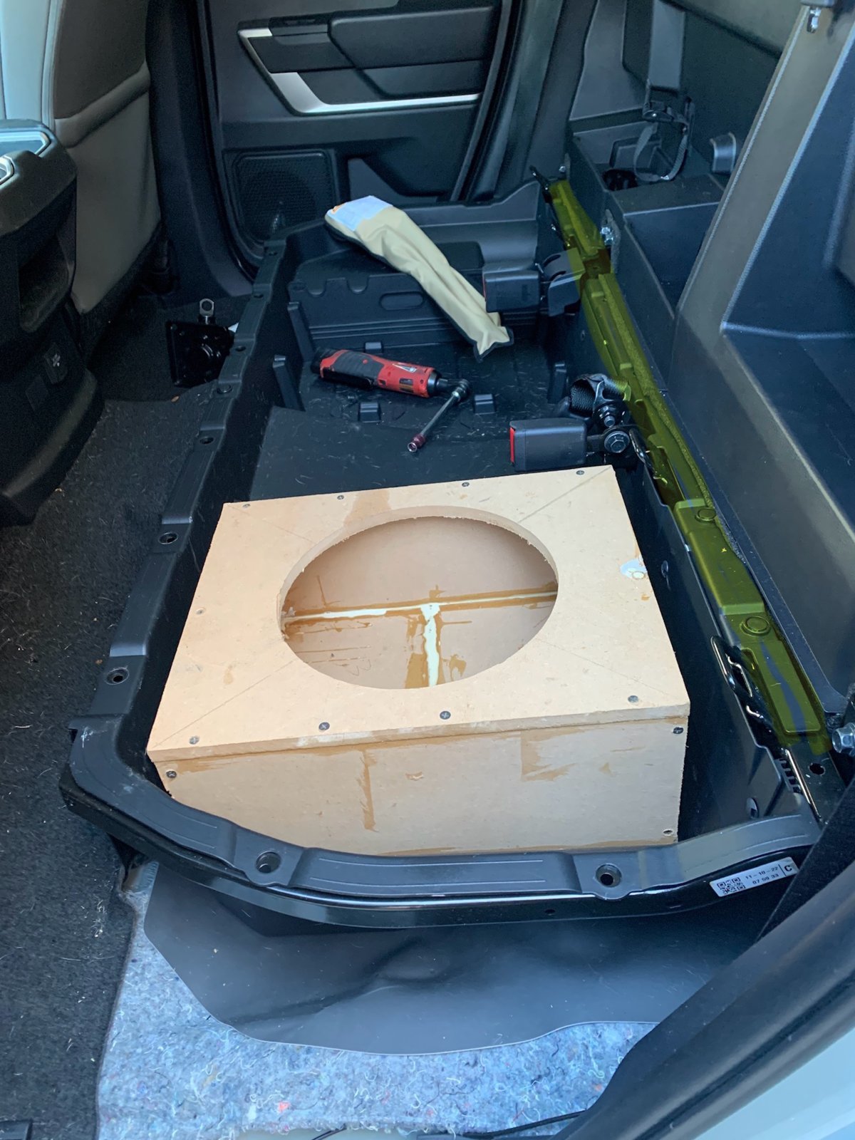

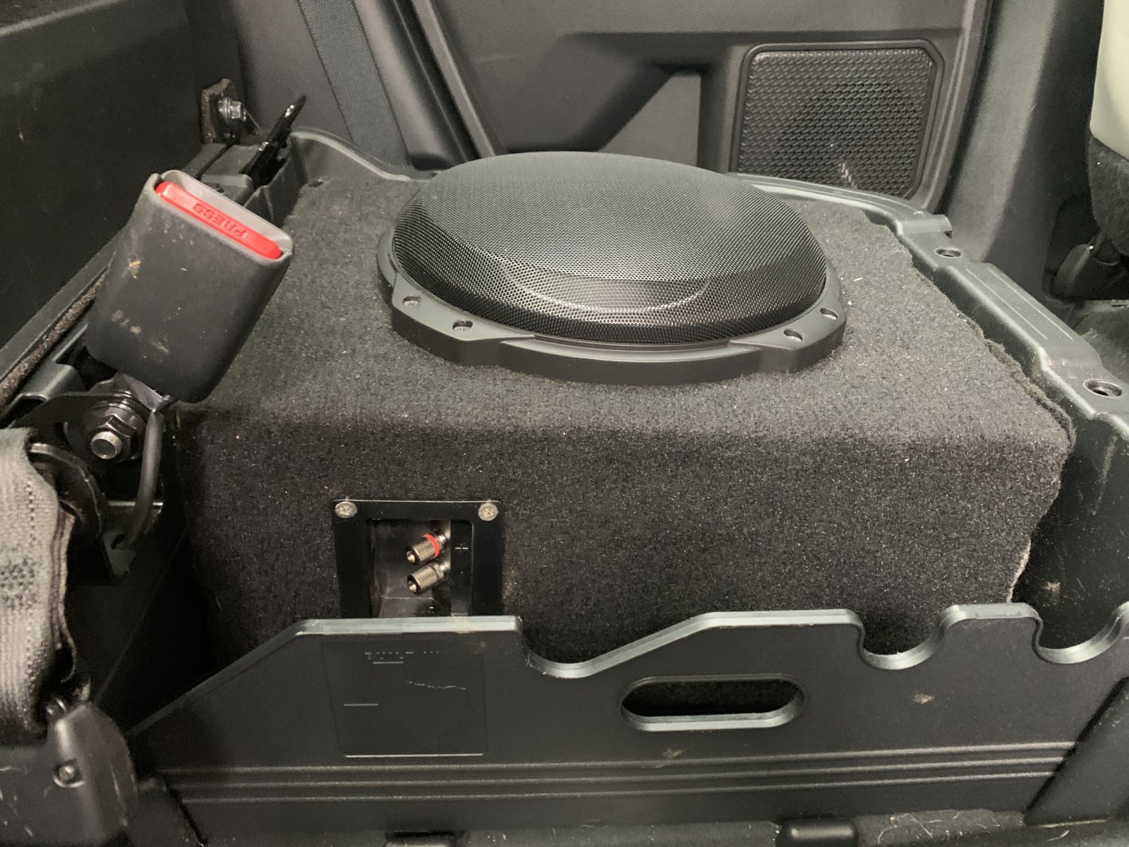

    Quick update... I got the sub assembled and set in place. Struggled a bit with the carpeting on the ends, but it will be concealed under new bin lid. I also pulled the rear panels and figured out where and how I am mounting the amp. I fabricated a sheet metal bracket and bolted that onto the amp, ground the protruding screws down to small nubs, added some weatherstrip. The bracket has a tab with a hole in it that will get bolted onto the rear panel with the existing OEM 10mm bolt that holds the panel in place. I made an 8"x2" cut in the floor of the pocket in the panel... and made a 3d printed beauty ring... for the wiring to come up to the amp. While the amp settings are accessible from the top. The panel and the amp are not yet back in the truck as I am waiting for the beauty ring to finish printing. Plus, it is raining. And the replacement harness from TT just arrived so I have everything I need to connect and go live soon. Only long lead item is a 2" x 1 1/2" alu angle to mount to the mounts for the removed rear seats. That's where the hinges and new bin lids (I still need to make) will attach. This is all a bit of work. LOL. And I will still need to get around to the main speakers one of these days... or months.

    A secret to the carpet, if you wrap the carpet on the box like you would a gift box (triangular shaped folds) you can use a straight razor blade to trim the excess. Carpet is pretty forgiving and it will stretch a little bit if you have a small gap. Then use one side of the scissor blade to "comb" the seam and you shouldn't ever see the seams. On a corner edge, use the scissors at an angle to the edge to cut. Since you pulled the seats are you going to remove the seat belt fasteners?

    LOL... wrapping Christmas packages... another thing I can never get right. I am more of a mechanic and that sort of crafty stuff has always eluded me. Not sure yet about the seatbelts. I'll probably just rotate them down and leave in place. The bins are going to be a couple inches deeper so the lids should clear. I'll know better when my alu angle comes in and I can do a test fit. Now I need to find space to store the damned useless rear seats, in case I sell or trade this thing at some point.

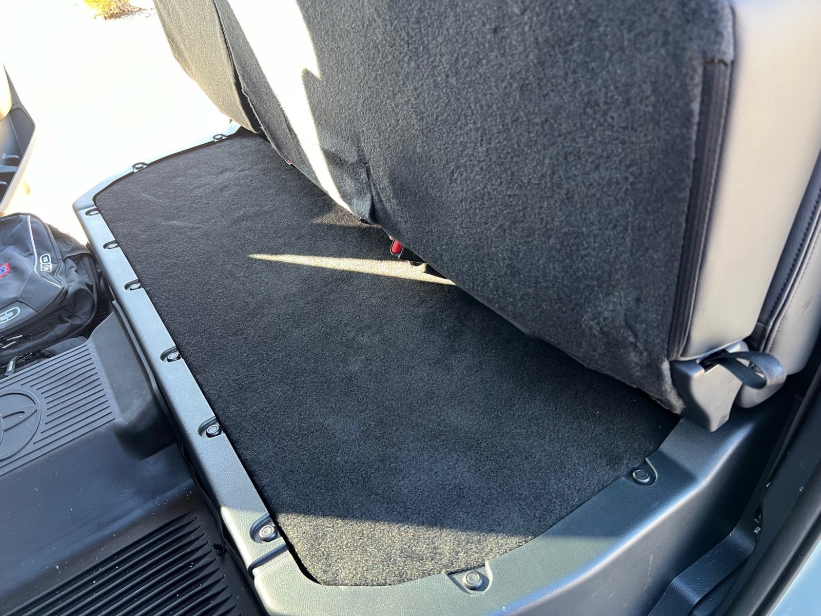

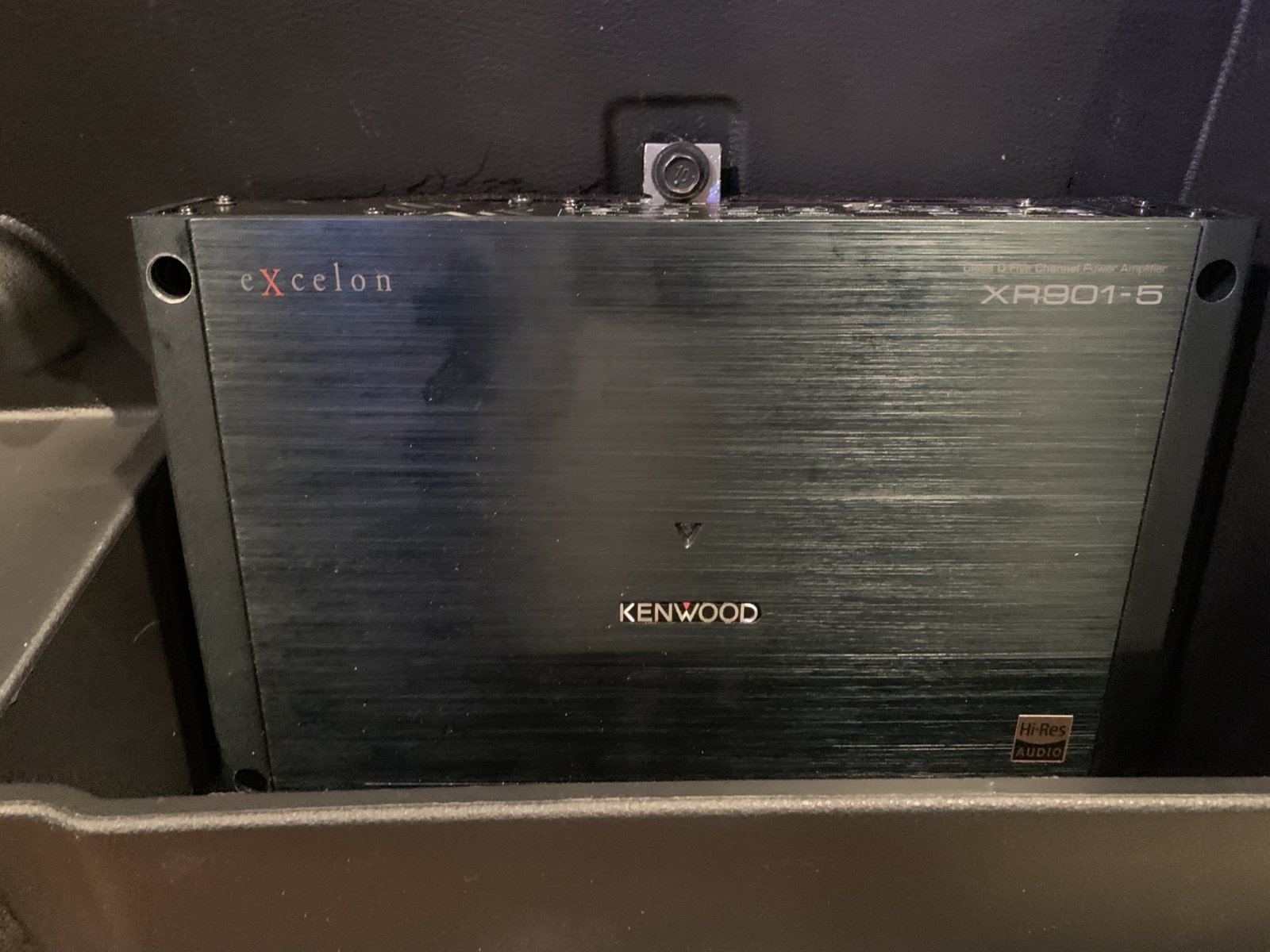

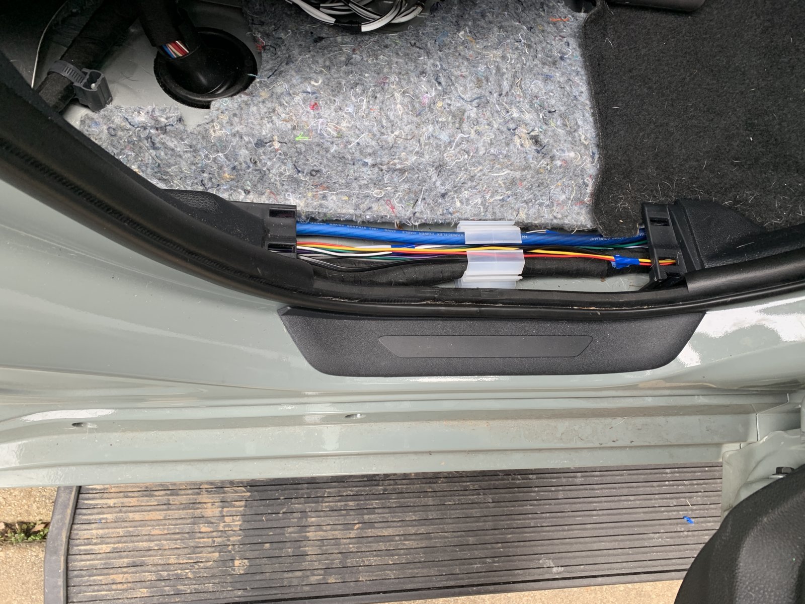

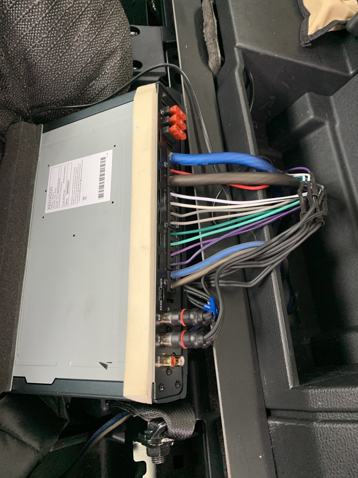

    Another update... I have the first phase of the audio upgrade 95% complete. Amp and all audio and power harnesses are installed and ready to go. All I need to do is pull the 14" screen/radio and swap the plugs around. It got too late to fire it up yesterday.
    One question... how did you guys route the phone cable for the bass adjust knob into the console? From above in the radio space or from below the dash by pulling it out from the carpet there? I'd rather not have another big project to disassemble the dash and console to do this.
    I also made progress on the rear seat delete and new bin lids. I got the alu angle, painted it black and installed to the seat mounts, got some hinges and plywood... I still need to decide exactly what configuration to cut the plywood, along the shape of the bins or more square for a better platform. These lids will have feet that rest on the bin perimeter to make them level and will give the bins a couple inches more vertical depth. Then decide whether to try to carpet those myself or take them to an upholstery shop. Not sure I want to fight that damn carpet.

    Got the installation done and it came out pretty nice, IMO, but... there is zero subwoofer output. The sub ohms out at 2.2 ohms which is what it should be for the two 4 ohm voice coils wired in parallel. I am going to try to connect up a generic speaker and see if there is anything there. I suspect the amp. There is a switch to select sub input for direct sub input like for an aftermarket head unit, or to have the amp to use the AB inputs to make up the sub signal. The latter is what I have selected. I'll call Kenwood and/or Crutchfield to try to sort this out. Anyway, here are some pics:
    Edit: I tested the sub indoors on a HT amp and it works... I also tested a small HT speaker on the Kenwood sub channel and nothing. I called Crutchfield and he had me check AC voltage on the sub output and it read 25.4 VAC. But that was steady and did not vary with volume level. They are sending me a replacement amp. n Pretty disappointing that after all that work, I have a system that sounds the same, albeit with more power. Speakers next once the sub is working and after I take a break for awhile.

    Yeah, it looks good, but the sub doesn't work. Crutchfield agreed that maybe it is the amp and want to send me a new one, but IDK. I have a hard time believing that just this one section of the amp doesn't work. The way it is supposed to work is that the amp takes the 4-channel line level inputs and pulls out the bass and sends to the sub out. I set the LPF to 100 Hz IIRC and there is zero output to the sub. I mean zero, nada, nothing. Maybe I'll try opening it up to 200Hz which I believe is maximum to see if that helps. The crazy thing is that even if that helps it means there is no real deep bass in the signal... or else the Kenwood just can't find it.
    I am wondering if this is a situation where I need one of those AudioControl LC5i's to find and/or enhance the bass and send it to the amp via the sub preamp level input?? I have never worked with adding a sub to a modern factory system and I hope this all hasn't been just a waste of $$. It is so much easier and better with aftermarket head units.
    And maybe the Kenwood pulls the bass from channel B which I have from the rear, whereas most bass might be sent to channel A? In which case I could swap those. I'll call Kenwood tomorrow to see what they say.
    The other question: can TechStream change or entirely turn off the Toyota audio signal processing to allow a flat full frequency output? @ryanwgregg, do you know?

    Hey guys, I got the sub working. I went out and played with the amp settings some more and I cranked the sub input sensitivity AND the sub bass boost knobs up near their maxes, and voila, it works. Strange that there was literally nothing until these were both cranked. I was tweaking the second one of these up slowly and I saw the sub cone move! Yay. Then went on to tweak the adjustments.
    Yesterday I had started at mid-levels, which have always worked for me before, and turned them one at a time up to max with no response. But with both near the top at the same time I found a level that puts the bass at a normal listening level in the middle of the bass adjustment knob in the console. So, all OK for now. IIRC @MaxPayne at one point in this thread said that the front channel had most bass signal and it may be that the Kenwood is pulling from channel B, which I have installed the input from the Tundra rear. So, I will call Kenwood tomorrow to see how they acquire the bass signal internally, and if I need to, I can swap the channels around. But at least it works for now and sounds pretty good. And down the road I can get the LC5i if that may help further.
    Other settings: I have channel A and B HPFs set at 100 Hz and the sub LPF at 100 to handle everything below that. So, that will keep the boominess out of the doors and help the OEM speakers survive until I replace them. I may tweak this some more after listening for awhile.
