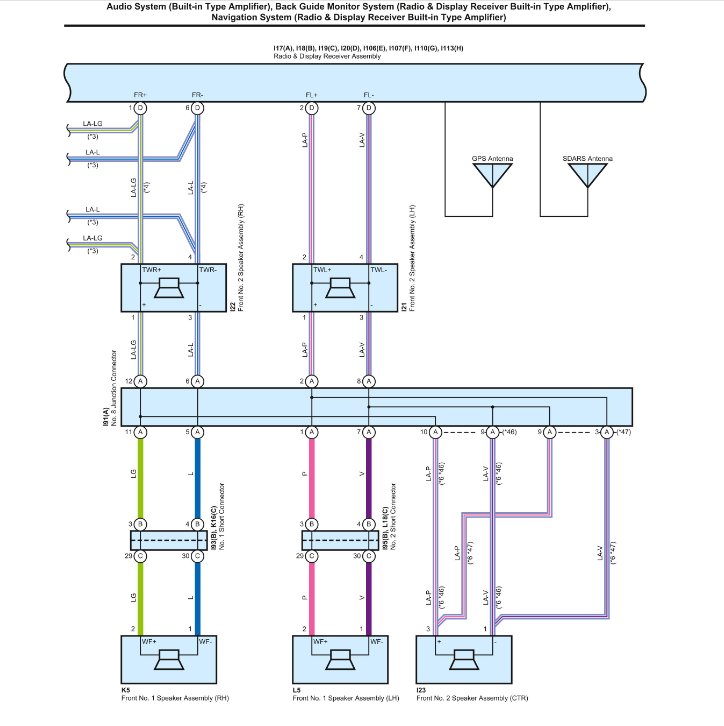

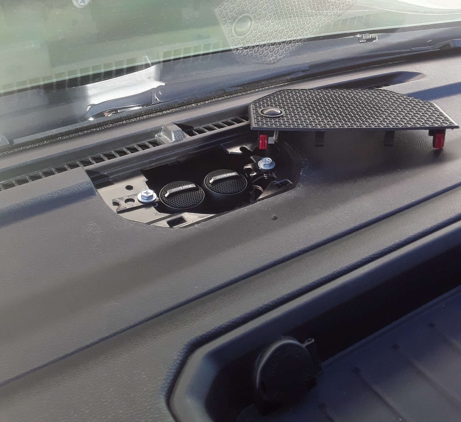

  14. Jan 29, 2024 at 7:11 PM
    #44
    dogsleds_t100_tundra
    dogsleds_t100_tundra New Member
    Apr 4, 2023
    #94947
    145
    '23 Tundra SR5 TRD OffRoad AG and '97 T100 4x4
    275/70/18 AT3, Elka IFP 2.0, Aftermarket Speakers, Sub, Amp. Ceramic Window Tint, Color matched grill surround and rear bumper panels, Orvis Backseat Protector for K9s, OEM Black Exhaust Tip, OEM Black Tailgate badge insert.
    I squeezed two tweeters there and wired one left and one right. May move to a-pillar later, we'll see.
    The oem wire there in center dash draws from drivers side dash. I added wire from the passenger side dash to balance (ie feed the second tweeter).
  15. Jan 30, 2024 at 10:24 AM
    #45
    MaxPayne3
    MaxPayne3 [OP] New Member
    Dec 22, 2023
    #108909
    216
    2024 Lunar Rock SR5 Crew Cab
    Just starting out but never will be done
    The OEM wire in the center dash does NOT just draw from the drivers side, see the wiring diagram in my post 36 above! The wire may look like it's fed from the driver side but it is connected to the passenger side as well, it receives a summed signal from both left and right. This is what a mono signal is. The way your tweeters are wired up, the left one is getting a mono signal and is adding a different load in ohms than the right side one where as the right one is getting a stereo signal.
  16. Jan 30, 2024 at 4:59 PM
    #46
    Apr 4, 2023
    #94947
    145
    Okay thanks for the heads up. Strange though, if memory serves me well when i originally connected both aftermarket tweeters to the center dash wire only and moved the eq Balance all the way to passenger side there was virtually no output. Evidently there is a dependency on drivers side to produce signal at all from center wire.
    Either way, my objective is Stereo on both so I will ditch the center wire and pull from each side. Appreciate the insight.

  17. Jan 31, 2024 at 7:05 AM
    #47
    MaxPayne3
    Dec 22, 2023
    #108909
    216
    That's because the negative wire is only tied in to the driver side speaker, that's how a summed mono output works. If you want true stereo move the tweeters to the a pillars to get stereo separation. Having them so close together provides little to no stereo separation.
