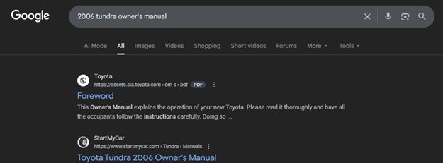

    I went to Google and typed "2006 Tundra Owner's Manual", it looked like this:
    I know this will be a great shock to you, but as you can see, this was the top result, direct from Toyota :rofl:
    https://assets.sia.toyota.com/publications/en/om-s/OM34458U/pdf/OM34458U_edited.pdf
    I highly recommend tapping to download that to your device for future reference, it's a good read.

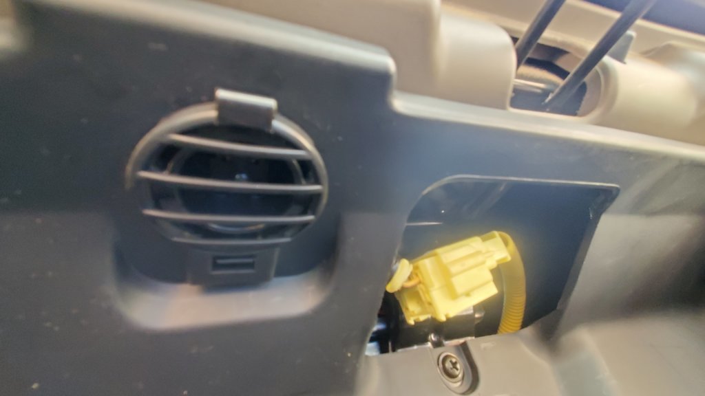

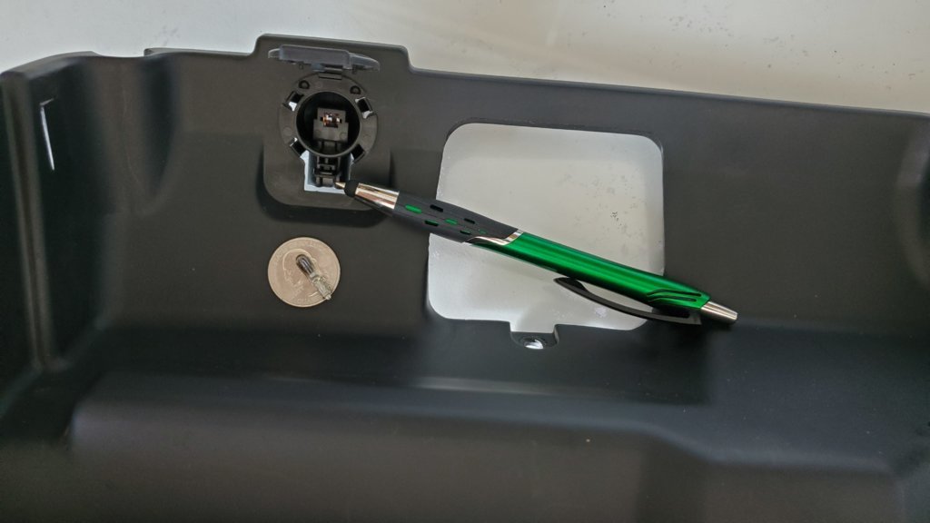

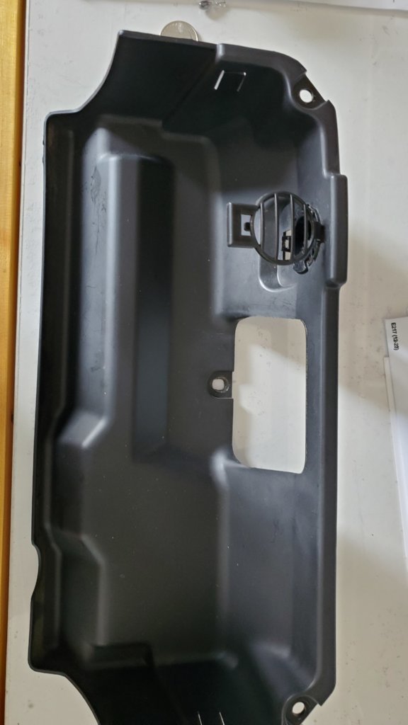

    Ive removed the Glove box 'ceiling' [3 phillips screws and then pop'd off the molex terminal in order to release the box 'ceiling' so I could see WTF my fat fingers are trying to access.]
    Theres a hinged plastic grill/cover blocking access. It has a release tab is at the back of the assembly [counter-intuitive] and needs squeeze or push [also counter intuitive] w/fine tip needle nose [used to pull old bulb too] to pop open to get bulb out.
    I suppose you can cut the grill/cover off to permanently have clear access to the bulb. [but Toyota worried about an exposed molex...or to keep glove box items clear of bulb..[its relatively deep seated; you'd really have to be a packrat to make contact].
    DOH! Didnt realize the Key ON req'mnt !
    Bottom line at the monent:
    Just put a VM to it [Molex] w/key ON; no current...the old bulb was smoked, so had power at some point in its life.
    According to O-man'l, fuse is same for
    position 36 [interior panel] TAIL 15A....Signals, Tails, Instruments, LicPlt, Prking & GLOVE Box ....
    Theyre all operational, except GloveBox....
    For anyone who hasnt been there, heres some pics of the Top part [ceiling?] of glovebox, bulb and socket..
    Box as installed, cam looking up
    Glovebox 'ceiling' removed
    Pen is pointing at release lever to open cover 'grill'; requires push towards back of box while pulling down on grill. Not easy w/boxtop in place; thus 3 screws to remove, but also req'd disconnect of Molex terminal.
