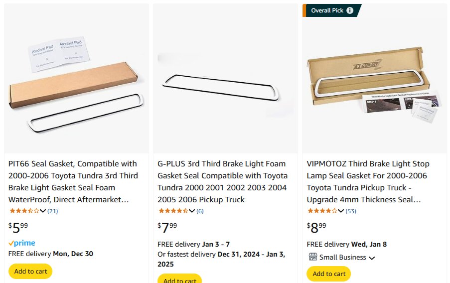

    Don't use sealant on the rear high mount. The OEM uses closed cell foam with a very obnoxious tar-like adhesive on both sides and is highly effective. IF you do pull the OEM assembly, it'll take some time to remove the the residual crap without damaging your paint. And you should remove it. A lot of people are using the VIPMOTOZ, which appears to be rebranded under a few different names now, but read the reviews carefully before picking. This is what you're looking for. You really only need it if (A) your current seal is breach/leaking, or (B) your new assembly doesn't come with it (OEM assembly 100% comes with a new foam gasket - I bought one because I'm 80% certain Toyota will discontinue the part soon)

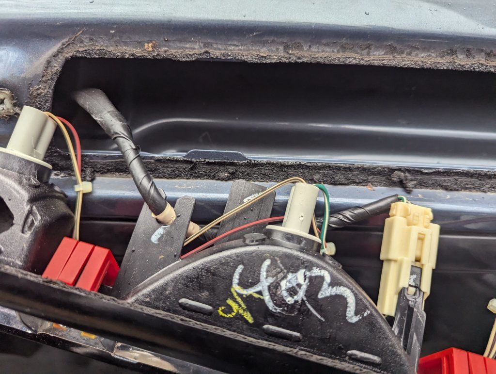

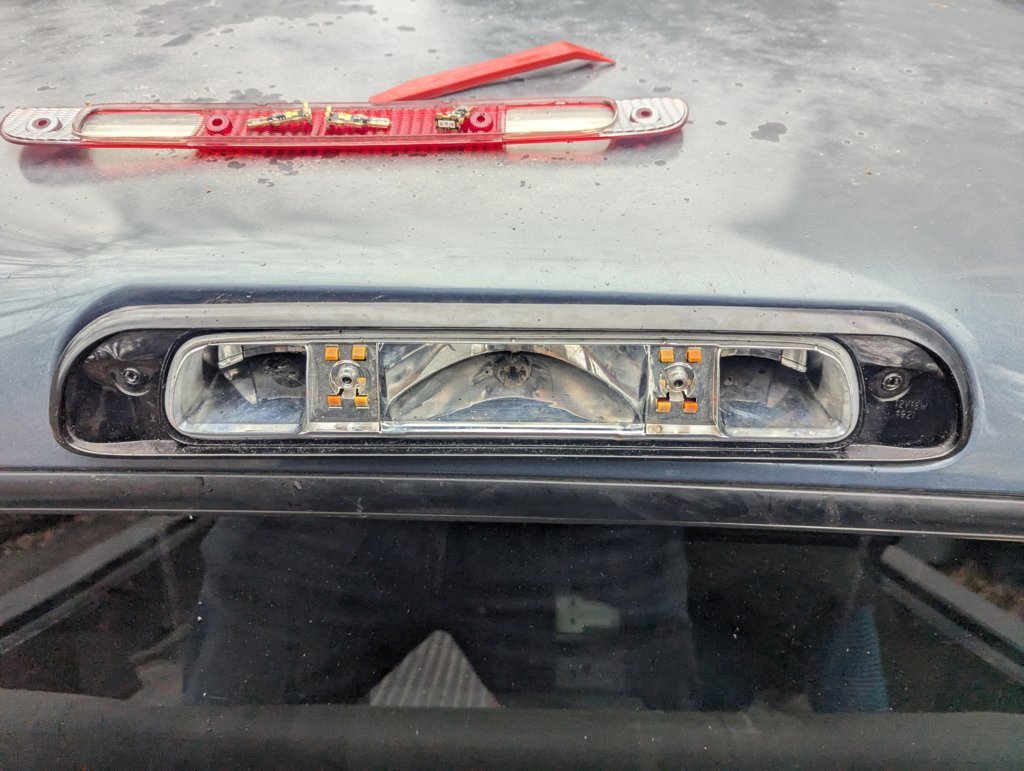

    I replaced the foam seal yesterday and previously replaced the 3 bulbs with LEDs in the OE third brake light . It went well but the original foam was degrading and failing as well as a gooey tarry mess. I didn't want to use any solvents that would ruin the clear coat so I just scraped most of the old foam and tar off with a plastic trim tool. I'll attach a few photos.
    My advice, be careful to detach all of the old foam before pulling out the third brake light assembly. Mine was still difficult to pull out and felt like it might break. The foam seal I got off Amazon ( one of the ones shifty highlighted above) was very sticky on both sides so you probably only get one crack at getting it to seat and seal properly. It fits well now. I noticed that the plastic housing above the white cargo light bulbs was melted. There are now two holes there due to the heat and I had to scrape black melted plastic from the metal below. Maybe this helps someone. Good luck

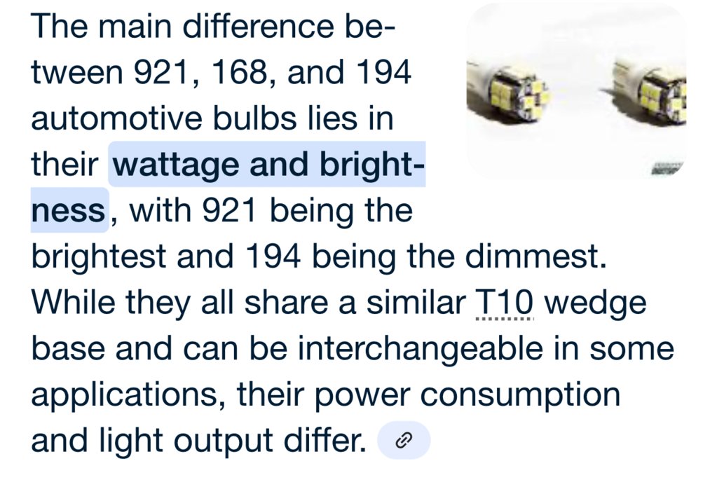

    The LED bulbs you'll need are size 921. 168, 194 or others will technically fit, but not be very bright. It looks like Sylvania only carries the ZEVO in white now, sadly. But they do have a non-ZEVO 921 in red (part number "921R")

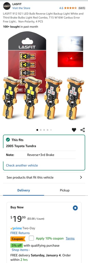

    Regarding LED replacements for the 3rd brake light assembly, I agree that Sylvania Zevo are the way to go if available. In my case, I decided to go with the Lasfit kit. I've got an extra red LED too. These are very bright and have been functioning well for the past 6 months. See screen shot.

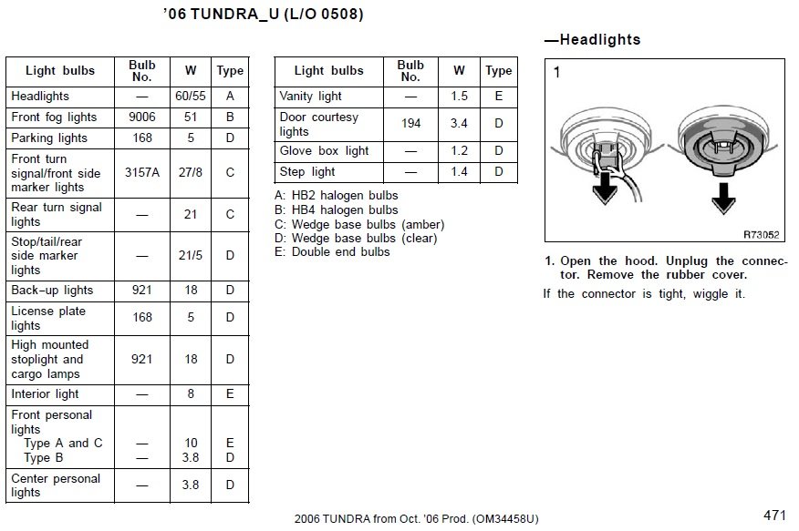

    Helpful info on the bulbs. I’ll follow the good advice. Wouldn’t white bulbs work for the brake light also since the lens is red?
    The foam seal from Amazon seems a bit thin compared to OEM. Still have not installed, so I could still order something different. I’m assuming it will work fine as is? Maybe my eyes just think it looks thin.

    Well, OEM bulbs were white, so I assume "yes" is the answer.

    The 921 bulbs are a simple swap and plug in with no resistors or other adapters needed? The reason I ask is because it’s the same bulb as the back up lights and certainly a higher output than interior lights. Thank you again for all the input

    I don't think you'll find an issue. I can't say: I have LEDs in my 3rd brake/cargo light, but halogens on all four corners. I have LED mini projectors in the headlight housings, and a single LED in the "teardrop" (park light) position. But I didn't do any of those LEDs before installing the Diode Dynamics SmartTap, which will kill any risk of hyperflash. They also have a non-smart version that's about 80% cheaper last I checked. It's well-worth investing in. Just avoid scAmazon/fleaBay for purchase, they have problems with couterfeiters, their part design was stolen long ago, and the knockoffs don't have any worthwhile QC/QA on them so it's a risky purchase to save a few bucks. Other members have gotten burned on the non-smart knockoff part you'll find all over scAmazon, part died within a year or two or didn't function straight outta the box.

    5 months later, and all 3 of these Lasfit LEDs have failed. Flush $20. Now going with the Sylvania zevo LEDs

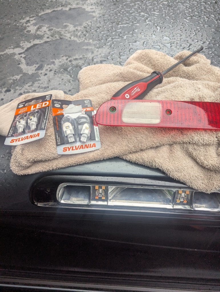

    Went with 2 sets of white Sylvania zevo LEDs because the red ones are almost unobtainium. The extra 4th LED is now a replacement for any of them. $16 per pair on eBay vs $25 at Advance Auto/Amazon.
