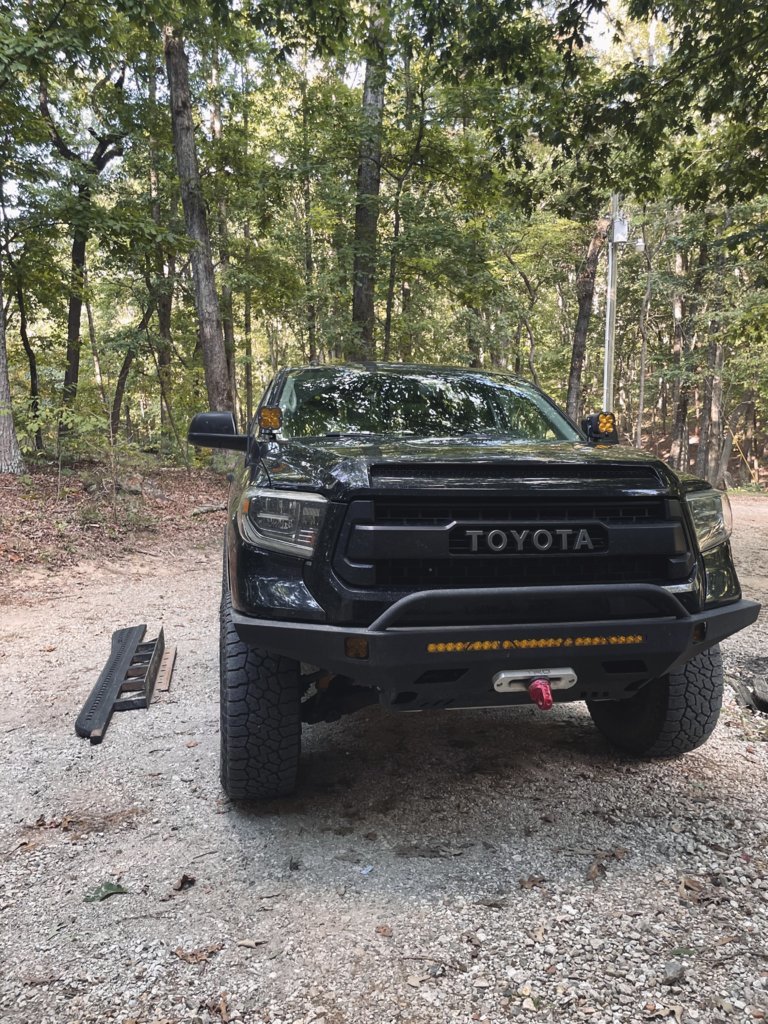

    Finally got around to setting a day aside to install the winch. This started with relocating the power steering cooler. Unfortunately the relocation suggested by Coastal Offroad that I did using their included brackets in my bumper build was still not enough to clear a winch. This meant running an aftermarket cooler. So i started pulling apart the front end. Between the annoying TRD skid plate and the weight of this bumper, its my least favorite thing to do on this truck. Had my supervisor with me who decided to lay in the grass and watch me struggle instead.
    So I started with this Hayden 679 trans cooler. Good quality unit that was a large enough size to replicate and improve upon the stock cooler.
    You can see the stock cooler hanging below the mounting points in this shot. I had already taken the Coastal steel relocation brackets off. This would directly interfere with the winch.
    To mount the cooler I used JohnLakeman's extremely helpful transmission cooler guide that can be found here. His brackets were perfect for mounting this cooler securely. I plan on adding a transmission cooler eventually as well on the other side. Started with forming the main bracket out of 1" flat stock that i measured, bent, and painted.
    Deviated from his instructions a bit of using steel sheet and just used the extra flat stock to make the brackets that would then hold the other side of the cooler to the hood latch support.
    Then came drilling the holes into the truck to mount the brackets. The holes were drilled and i subsequently painted the exposed edges to avoid rust. This is where I made an idiotic mistake. I used my level against the flat stock bar to mark where to drill the upper hole in the truck. However i forgot that the truck itself was not level where I parked it. As a result, it came out slightly crooked. Does not actually matter and its hidden by my grill but it still made me feel like an absolute idiot. I then routed some 3/8" hose and added some hose clamps and it was done. Topped off the reservoir with some Valvoline ATF, bled the system, and everything was solid. Very happy with how it came out otherwise.
    Now with that relocated I could move on to the winch install. I bought this winch almost 6 months ago for a steal, an Engo 10000lb synthetic line winch. I was not originally looking at Engos but they have a good reputation as a small company and back up their products well so I trusted them. Winch looks to be good quality with good weatherproofing but we'll see how it actually does.
    Obviously needed to relocate the control box. This was a bit of a dilemma. It would be easy to put it behind the grill but then it wouldn't be easily accessible to plug in the remote. Under the hood would be a pain between needed to buy all new wire and open the hood every single time I needed to run the winch. So I placed it next to the winch where it was accessible from the front and at an angle so that the cord when plugged in would not be under any pressure or stress that would cause premature wear. I drilled some holes and then mounted the control box. I'm still not totally sold on the location, some feedback would be great.
    I used dielectric grease over every contact and edges of the cable sleeves for added protection. I'm wondering if I should seal the control box with silicone as well despite the actual solenoids being weatherproof inside.
    Otherwise I got the bumper mounted and also mounted my custom fairlead.
    I had this made by a guy on Etsy who CNC'd the TRD logo for me. Trying to add an "OEM+" look. Also added a Factor 55 Prolink. Happy with the look and the winch functions great. The winch remote plugs in easily and is easily accessible. The winch clutch is also easily accessible through the opposite access hole in the bumper as well. While i'm happy with it, i'm contemplating a Factor 55 Flatlink instead now. I like the Prolink but it does stick out a bit more than i'd like. Otherwise I plan on painting the "TRD" letters red too.
    My next plans are to tackle the absolute mess of wiring under the hood. This includes wiring in a winch power disconnect switch and adding a fuse block to better manage all of my accessories. I purchased a bunch of Blue Sea Systems parts that i'm piecing together for this and will also be fabricating some brackets.

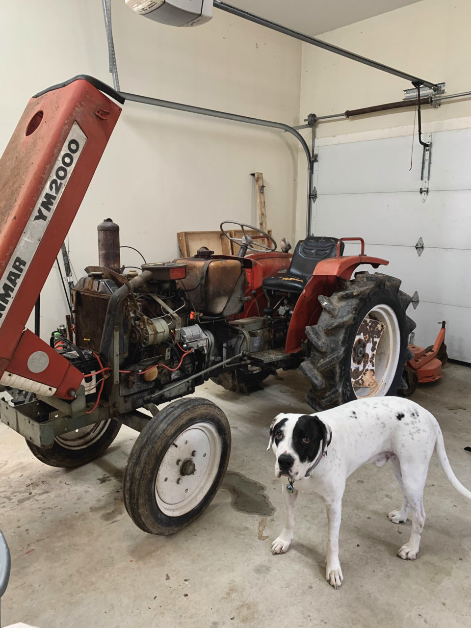

    I also ended up buying a tractor that was a bit of a project. Left out in a field for years and years. Here it was on her voyage back home.
    Its a Yanmar YM2000 that i've been slowly rebuilding. My first diesel and a lot of fun. Very old school and very Japanese - overbuilt and well thought out. It reminds me of the Tundra. Got it running and i've been slowly restoring it.

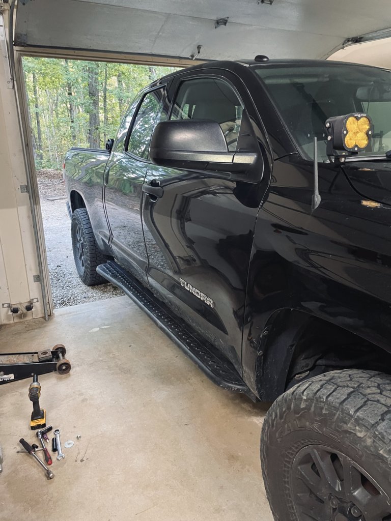

    I looked up some install instructions and tips but personally I found the easiest way to do this by yourself is with two floorjacks. I had these sliders mounted in about an hour by myself.
    Everything lined up with the factory holes. I did not drill the additional holes RCI recommends. The previous owner did not and never had issues with hard wheeling.
    Yes and no. They do require an additional wiring harness to "convert" it from the standard halogen setup to the LED. You can find them all over the internet, here's an example: https://www.headlightrevolution.com...conversion-2009-2018-H-TUNDRALED_2?quantity=1
    With that harness its plug and play.

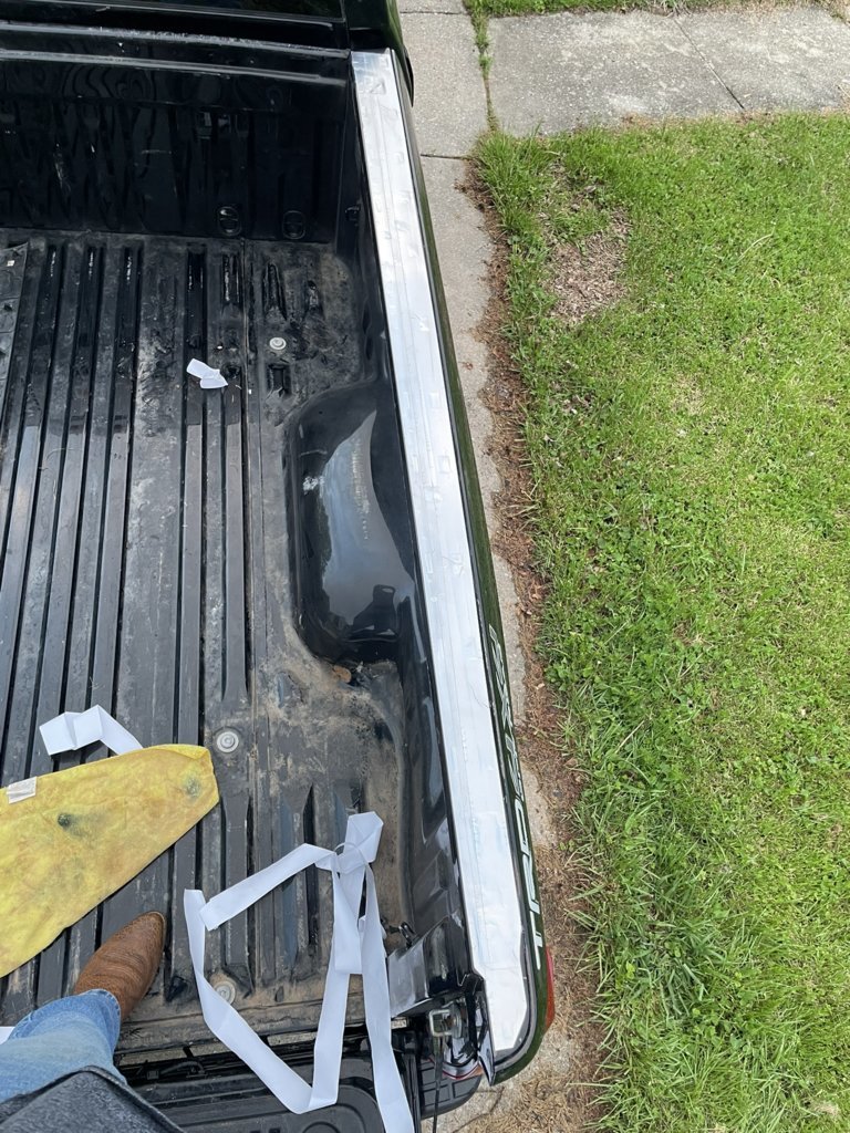

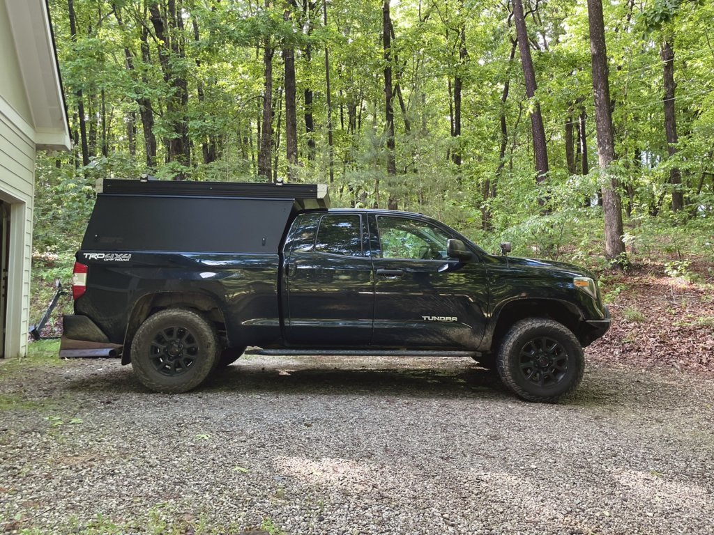

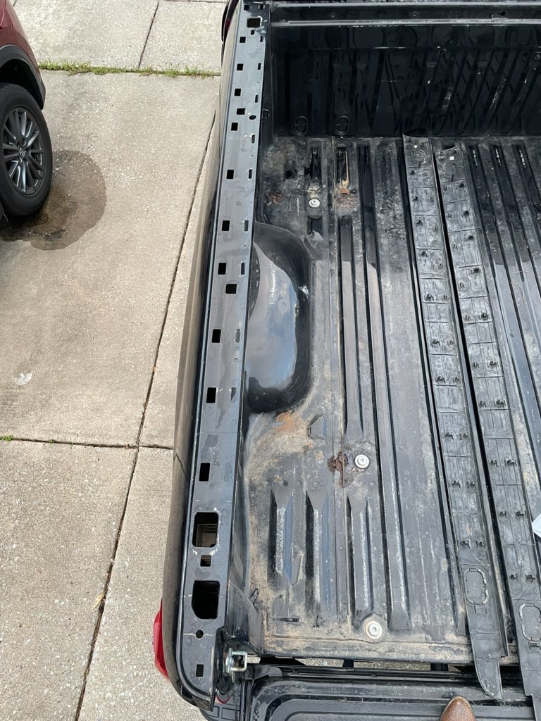

    Prior to the install I followed SoCalExpedition's tutorial video on sealing the bed. The beds on these and Tacomas are like swiss cheese as the holes where the bedrail covers clip in lead directly to the wheel well where dirt and water can intrude.

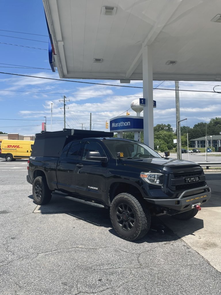

    I stopped to pick up the camper during a trip we were doing coming back down from Maryland. Doing this while at my in-law's parking pad and not at my home shop was annoying but made me appreciate my home shop that much more. I started by removing the bed rail covers. I pulled the factory plastic bedliner as well. I knew these were bad, but it was so convenient for me with how much I use the bed. Well it came back to bite me. I found two rust patches in the bed requiring repair. Thankfully not completely through but will require some cutting and welding soon. Let this be a lesson to you to say NO to plastic bedliners. They just trap dirt and moisture. I knew this was true but was too lazy to remove it and I'm paying for it now. Could be worse though.
    Sealed with HVAC tape. Then i poked small holes where the clips would go from the rail covers and also put a bed of SikaFlex as extra protection against water and dust intrusion.

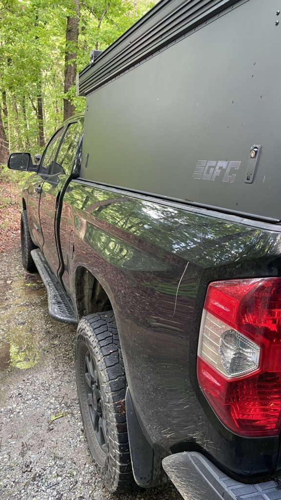

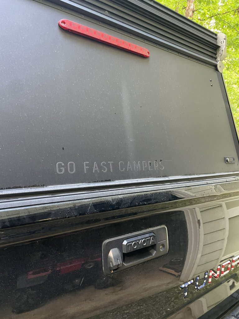

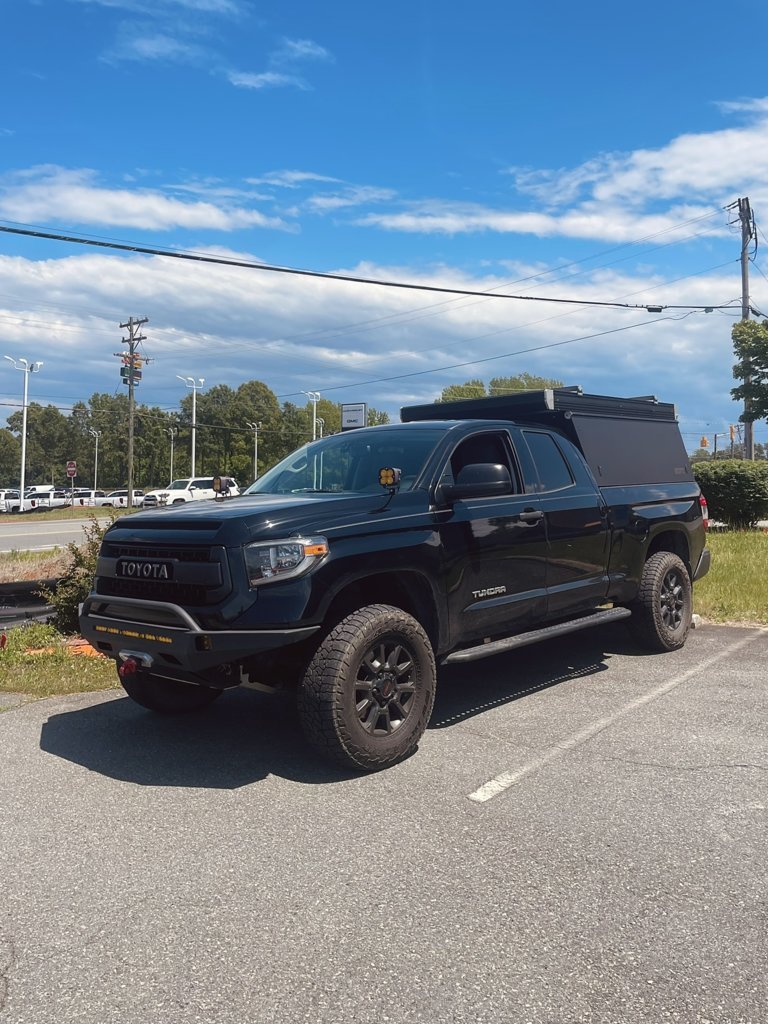

    I then made the trip to meet Josh at Apex Overland for install of the GFC V2. Had a great experience there with a quick professional install. It was my first time being at a shop and it was nice not breaking my back for once. This was really the cherry on top for this truck. I feel like its really "complete" now. It looks absolutely awesome.
    I drove a few hundred miles with it on and could not feel it on the truck. My avg MPG prior to the GFC was about 15.5. I now get about 14.5. The fact that its sub 300lbs makes a huge difference of how it does not change driving dynamics of the truck compared to something like a slide in camper. In addition, the entire drive was through severe thunderstorms and the bed stayed bone dry.
    The camper itself is optioned with no windows (no room for leaks) and has two beef bars that I plan to run a solar setup with. Other than that I got some Plano cases for camping supplies that I can quickly load in or out of the truck when we go camping to keep the bed functional for truck stuff as my daily driver. I cant stress enough just how high quality everything is on this. The billet and extruded aluminum parts are really a work of art.

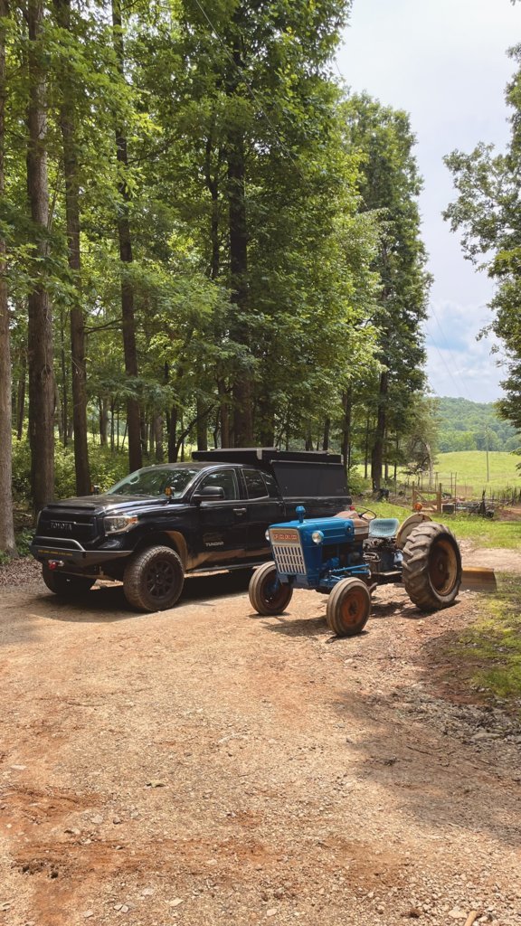

    I had to get a pic with my Ford too. One of the most reliable trucks ever made next to one of the most reliable tractors ever made.

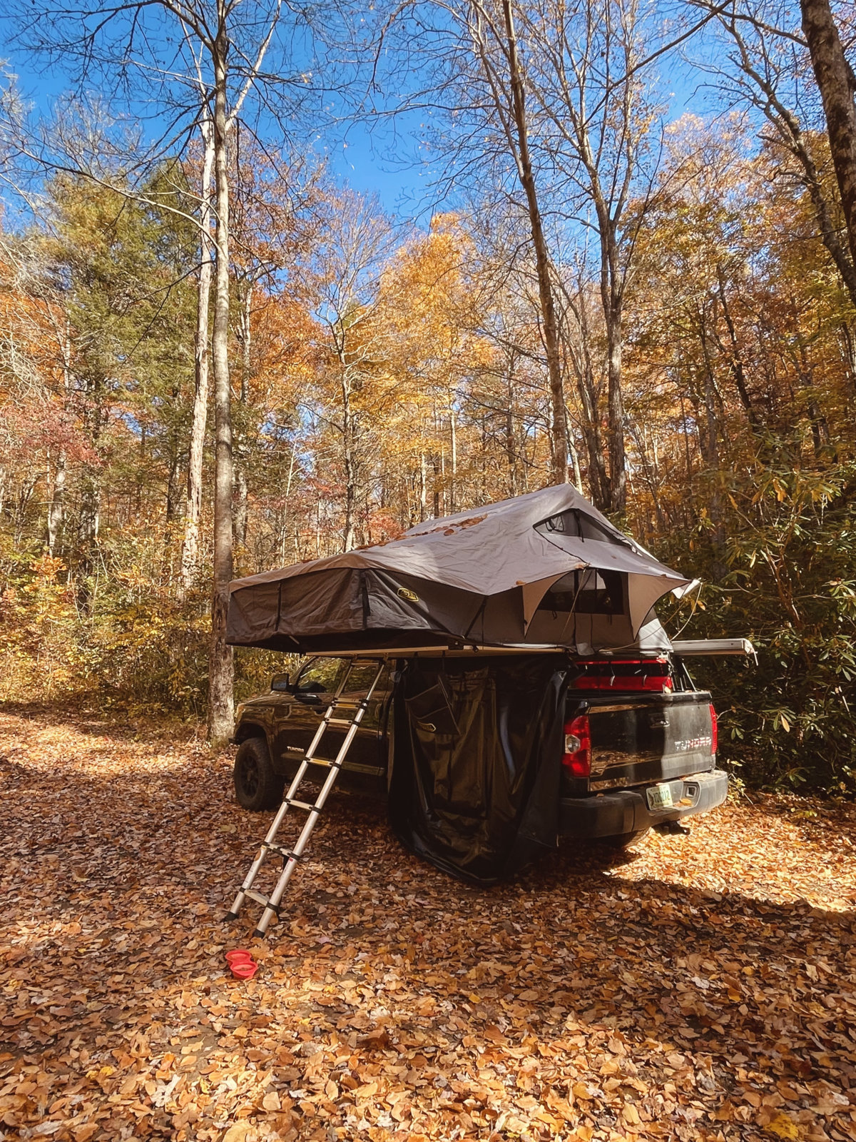

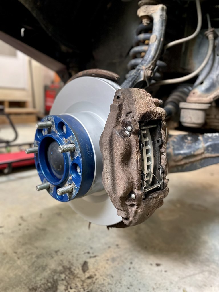

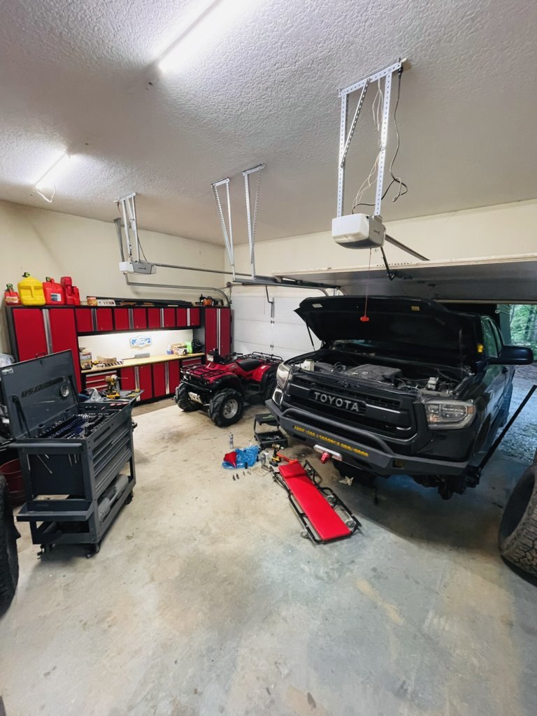

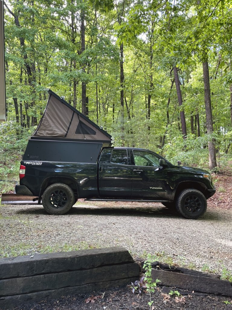

    Prior to going out for our first camping trip, the truck was due for some regular maintenance including front and rear diff, oil, and brakes.
    Say what you want about spacers, but I have run these Spidertrax 1.25" spacers for about 50k miles now. Torque specs still the same as when I put them on. Extremely happy with them. I went with a set of Centric coated rotors and Centric pads. Calipers are ugly but they're original to the truck nothing was seized including the pins. Highlights the importance of greasing them.

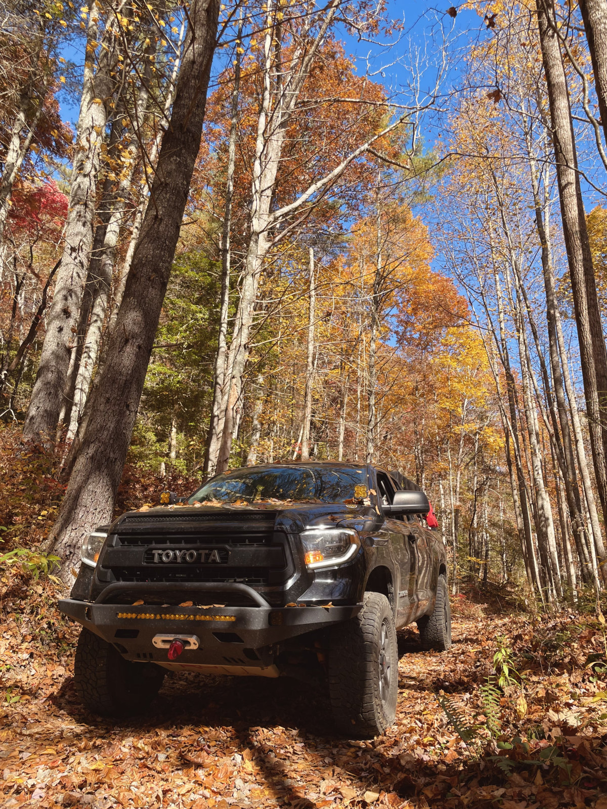

    Started to stretch its legs on some trails. We were solo so I wish I was able to get some more pictures of some of the trails I went down. Really pushed the truck and it did excellent. One of the trails was through a large river crossing and then up some very steep rocky and muddy switchbacks. I ran into a group of Jeeps at the end who were all on 37s+ and heavily modified. They all looked at me like I was crazy. I was definitely nervous through a fair bit of it. My skids and sliders took an absolute beating.
    Ended up camping out near a stream. Compared to my RTT and rack, this was like being in a hotel. I am extremely happy with the GFC. Its really in a class of its own and I completely understand why they are so popular now.
    Had a pretty bad storm come through and still stayed bone dry.
