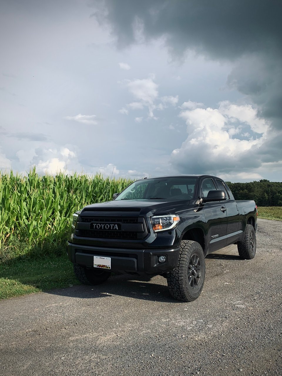

    Took some more pictures last night. I've been getting lots of compliments on the truck from strangers. Its been great. I helped this 90 year old man whose truck needed a jump in the parking lot of my work. It was a dually cummins with 800k on it. He had owned it since 200k and used to be a hotshot trucker driving all over the country. It was badass and guy was sharp as a tack. He's a hardcore Dodge guy and even complimented it saying it was beautiful. Man i love this truck.
