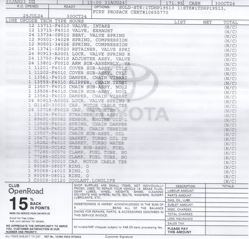

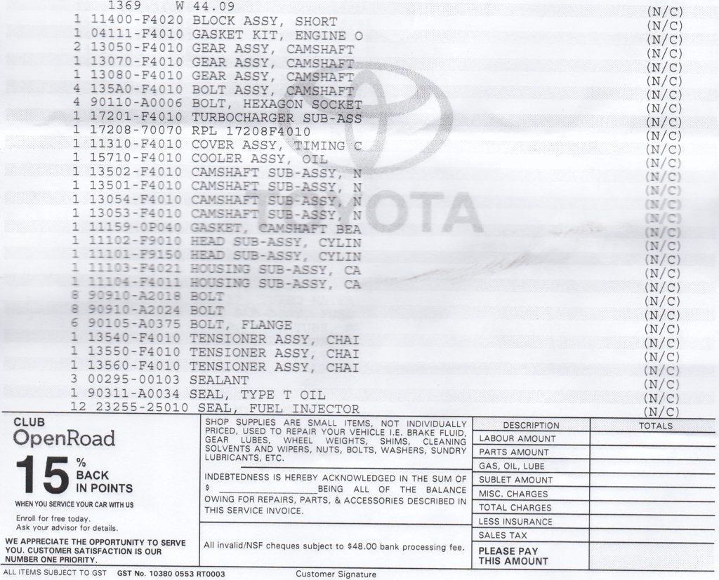

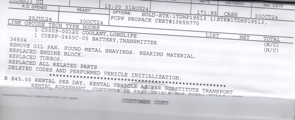

    Just wanted to update the situation.
    I just got my tundra back today from the dealer.
    The vehicle was towed in July. 25, 2024. And I picked it up Oct. 30, 2024. whole 3months.
    Obviously the damaged tundra was a crappy situation, but the dealer made it as smooth as they could.
    They gave me a brand new 2024 tacoma as a loaner for the 3 months. Parts took a long time to source as a lot of them are all special order.
    I attached a list of the parts they replaced. On page 3 of the documents, it seems like it was indeed metal shavings and damaged bearing.
    New turbos and New engine block rebuilt
    Wouldn't be surprised if this cost them $30k+ (canadian)
    It seems like the warranty package I purchased warranties the powertrain up to 200k km (125k miles). So I have some peace of mind for a while....
    I'm glad I have it back but have no idea if this will be a reoccurring problem...IMG_2185.jpg
    I hope this new engine will last a lot longer but I've a feeling that these are all original parts and not updated/ revised parts. Very worried in that regard.
    If anyone could shed some light regarding this, that'd be great!
    This is a Hybrid i-force MAX version. And I believe it still isn't officially on the recall list?
    IMG_20241030_0002.jpg IMG_20241030_0001.jpg IMG_20241030_0003.jpg IMG_2185.jpg

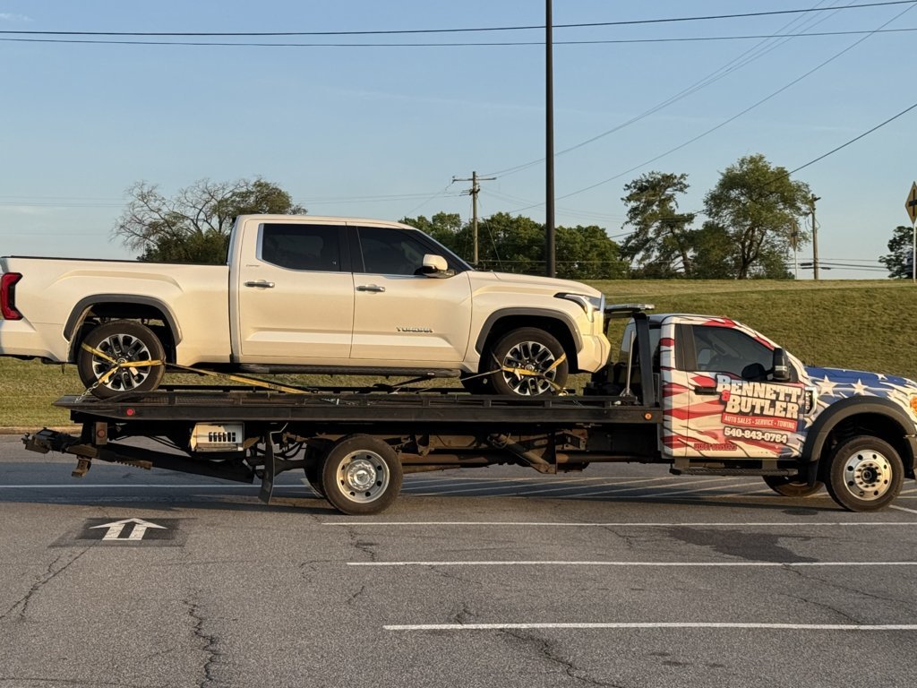

    Anand
    Maryland
    '25 Limited TRD-OR
    Just to add to this thread... 10 day and 1270 mile old 2025 (5/25 production date); loss of power/stumbles and sounds like every moving part in the bottom end is trying to escape. Got towed to a dealer this evening, and I'm hoping they can give me a loaner in the morning...
