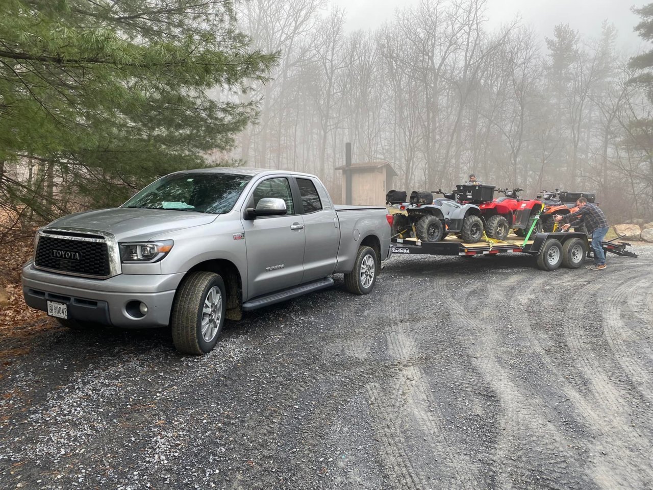

    Got quoted $400 for paint... so it'll be staying chrome for a while.

    I got decent results with a color matched base and a 2K clear over. Both came out of rattle cans and I had less than $100 into it. Prep wasn't too bad, just clean really well and scuff with a red pad.
