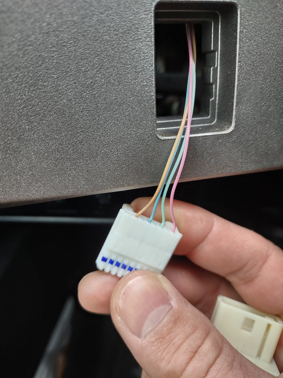

    Mine came in today. I plugged it in but not noticing any dimming. Doesn’t make much sense!
    part I ordered should be interchangeable with the tundra part. Not sure why it’s not working for me

    Pics of the part you got? You're saying when you switch your headlights on the cluster doesn't dim? Does it maybe need to be turned up all the way or something?

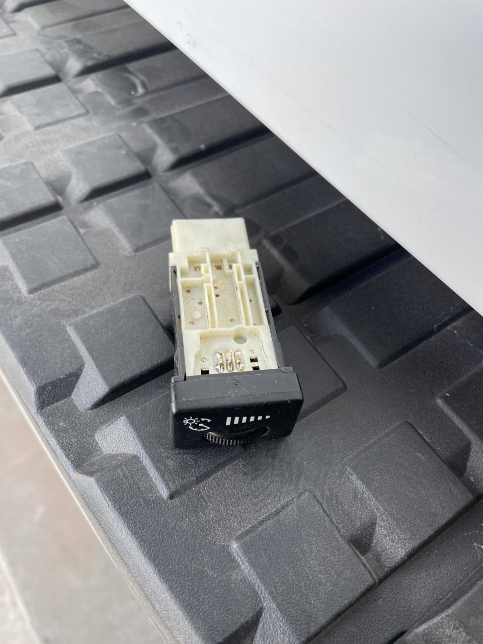

    I turned it up all the way til it clicked. Then tried turning it down even. It’ll dim when I turn it down but not when headlights come on

    Odd bc this part is interchangeable with the part number for tundra that should work and has the function to click it upwards (which is what I thought was needed)
    will order one from a limited and see if it works fine for me. Everything else I’ve wired up has worked (optitron gauges, steering wheel controls, auto headlights). So This should too

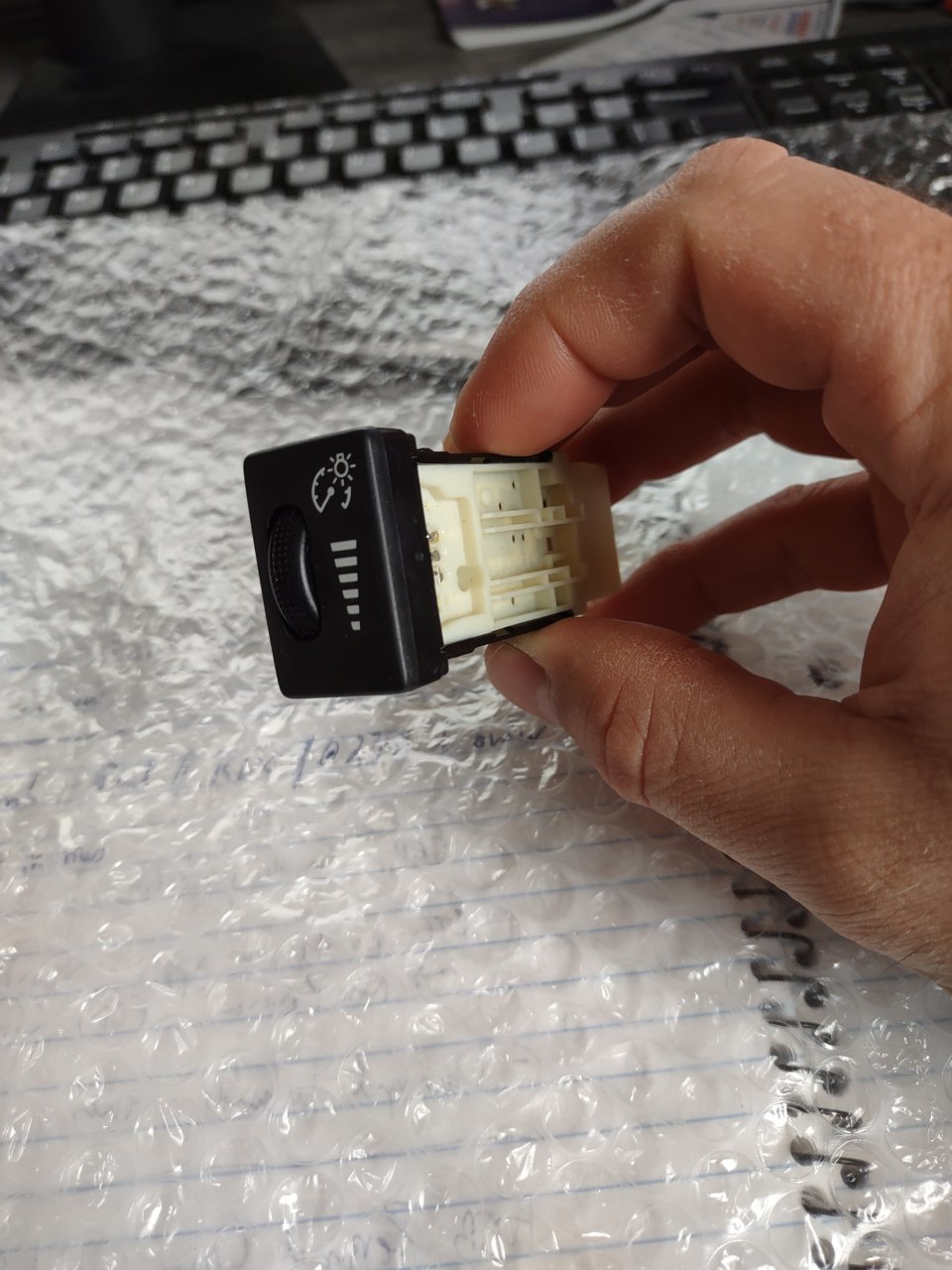

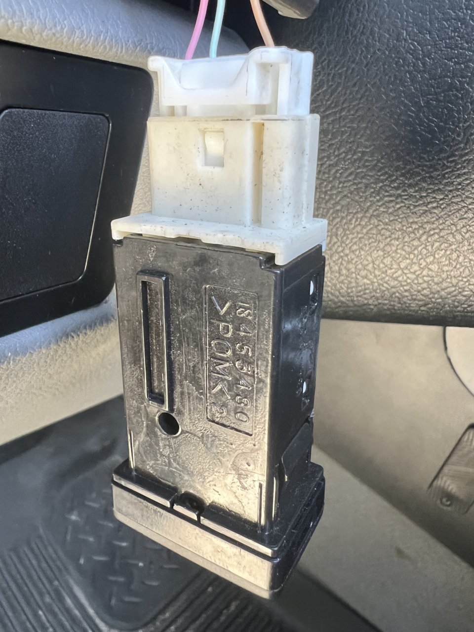

    Hmmm...the only difference I can see on mine is that the inner and outer pieces are stamped with the same number: 453840
    Yours has 453634 on the white part, which would lead me to believe there's something different inside.

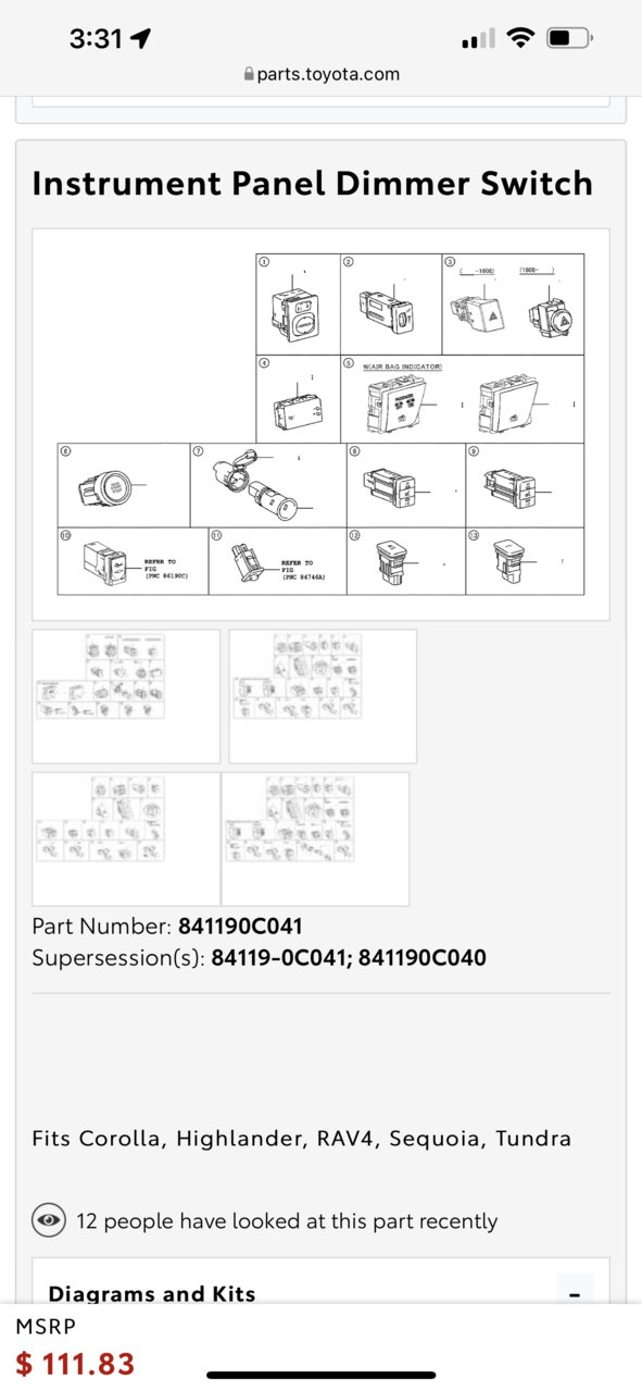

    Hmmm...so maybe I needed the part numbers from the pics moreso than the listing description. I just re-read the posting and this is what it said:
    "Donor Vehicle: I bought a 2010 black sequoia platinum 4wd to pull parts to finish another sequoia."

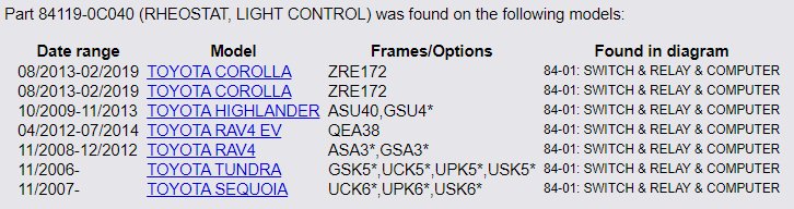

    Darn good question LMAO...from looking at the needed part (I checked on the truck my cluster came from), here's the part and options we likely need:
    I'll add - I'd be hesitant to buy one off eBay without them listing the VIN of the vehicle it came from and checking that vs. toyodiy.com The 0030 and 0040 are listed everywhere as "interchangeable", and they are, but not for full functionality, it would appear.

    I'm gonna say based on the chart I just posted...pretty much about any Corolla dimmer from 2013-19 should likely work. Apparently they had dimming interior lights standard on just about every model...

    The 0030 is different than the 0040. The 30 appear to be the black ones and 40s are the white ones, which seemed to have been the ones needed/working
