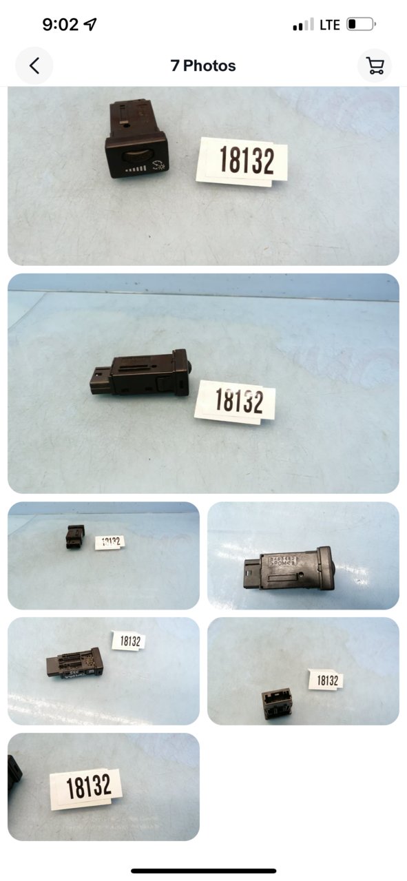

    Also looks like I’m seeing a part number of Toyota 84119-0C030 (plug in in back is black) and 84119-0C040 (plug in in back is white) when searching ebay for dimmer switches for tundras
    I just bought 84119-0C041 (which was listed for a Corolla) for $16. Once it comes in and I get my cluster back in I’ll test this out and see if it indeed is the fix. I checked mine and I do have the black one currently
    Maybe e30cabrio can check his dimmer out and see if the plug in on the back is white

    Hmmm, I did a quick eBay search and they use it on RAV4 and corollas. I’ll swap mine out with my wife’s RAV4 and see if it does the trick. Give me a day or two!

    Awesome!! Thanks for checking! Glad it’s an easy fix. Already ordered one for $16 off eBay so will have it fully functioning when the cluster comes back in from getting programmed

    I'm looking at ordering one too but not sure what the difference is between the black one and the white one. I don't see any part numbers on the actual part. I may just grab one with the white housing and see if it works.

    I actually found one from a limited and verified it on ToyoDIY.com. $27 after taxes and shipping, not too bad.

    Yea I think as long as it’s white you’re good to go. It’s the 84119-0C040 or 84119-0C041 that should work for it

    Swap out your dimmer with one from a limited/platinum and that’ll fix your dimming issue! Should be a fairly cheap fix

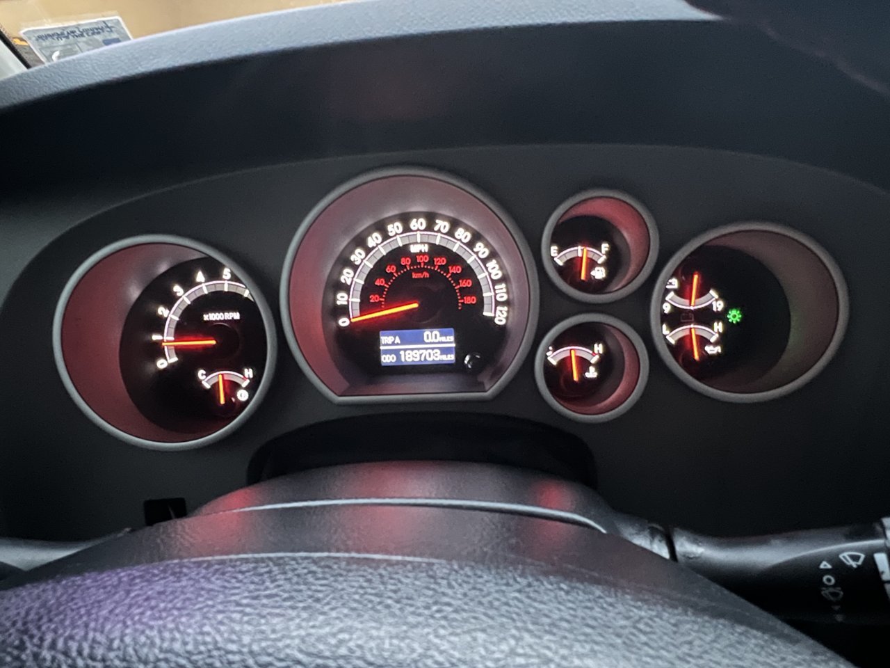

    Got my optitron gauge cluster back from being programmed and installed today
    FredB32 and Tundra3k like this.

    Anything funny with your fuel gauge?
  16. Apr 4, 2022 at 6:12 PM
    #226
    Musicmasterd12
    Musicmasterd12 New Member
    Jun 12, 2018
    #16099
    518
    Southern Louisiana
    2011 4.6 Silver Sky Metallic DC
    Not that I can tell. Old gauge showed about the same amount of fuel. Haven’t driven the truck or anything yet since install

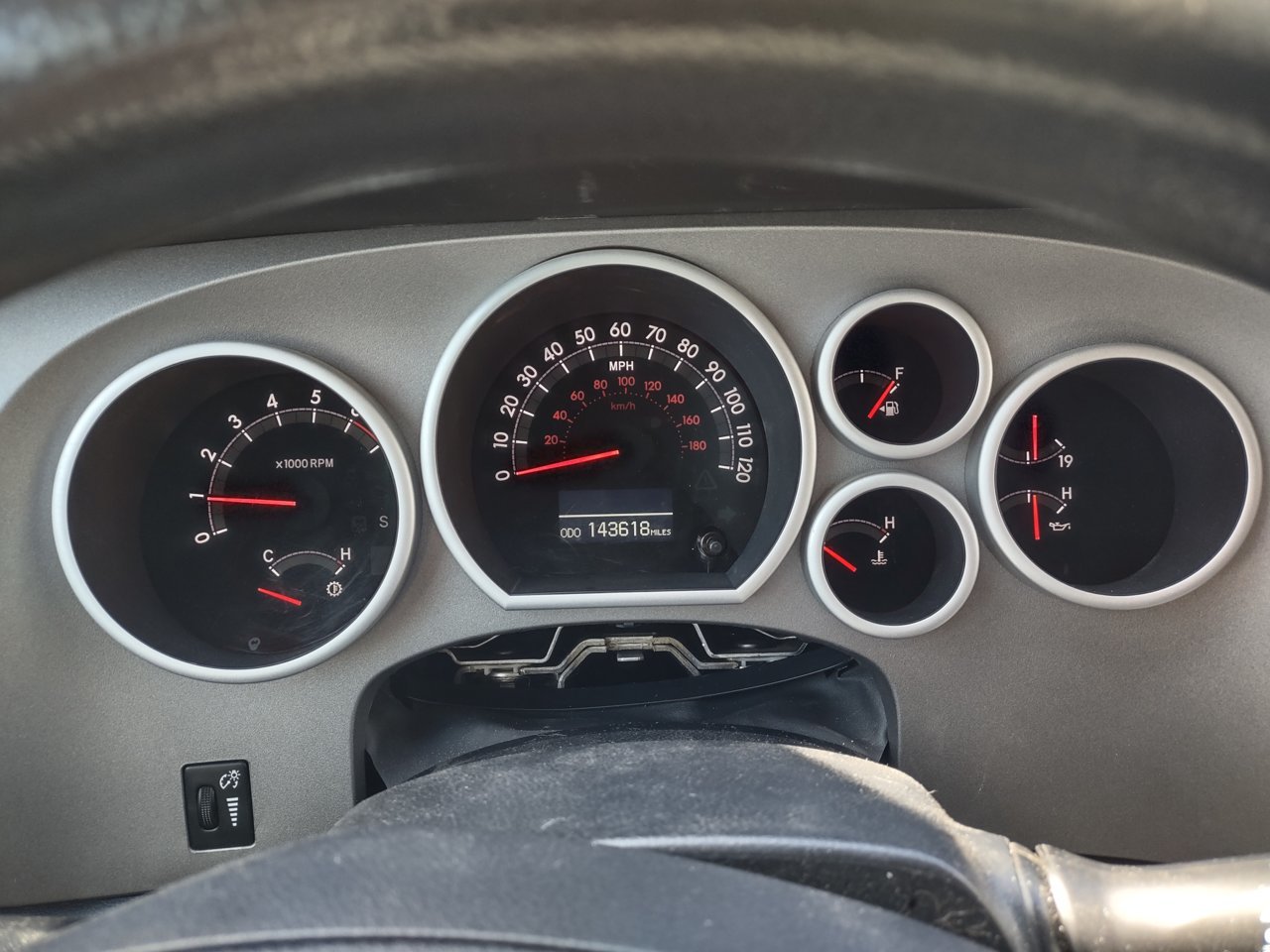

    I need to remove the blue flux on the chip yet and play with my stock cluster to see if I can get it programmed, but I have the starting mileage on the original cluster and will adjust as necessary. Worst-case, if for some reason I can't figure it out I can send it out to get it programmed...

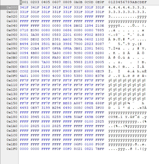

    Okay...hit my wall here...can't for the life of me figure out where the mileage data is in this block. The reader seems to work fine and reads the chip, but there's nothing I can see that aligns with the hex conversion I came up with.

    What program did you use? The mileage is usually stored on the first two lines.

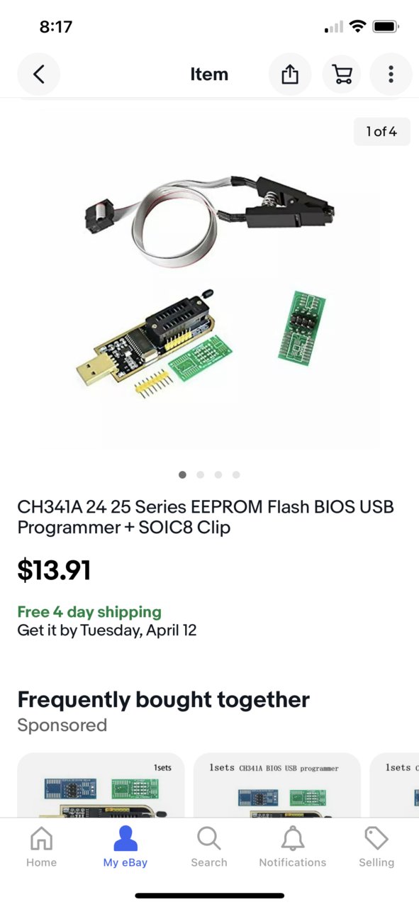

    Is this the same programmer you have ?
