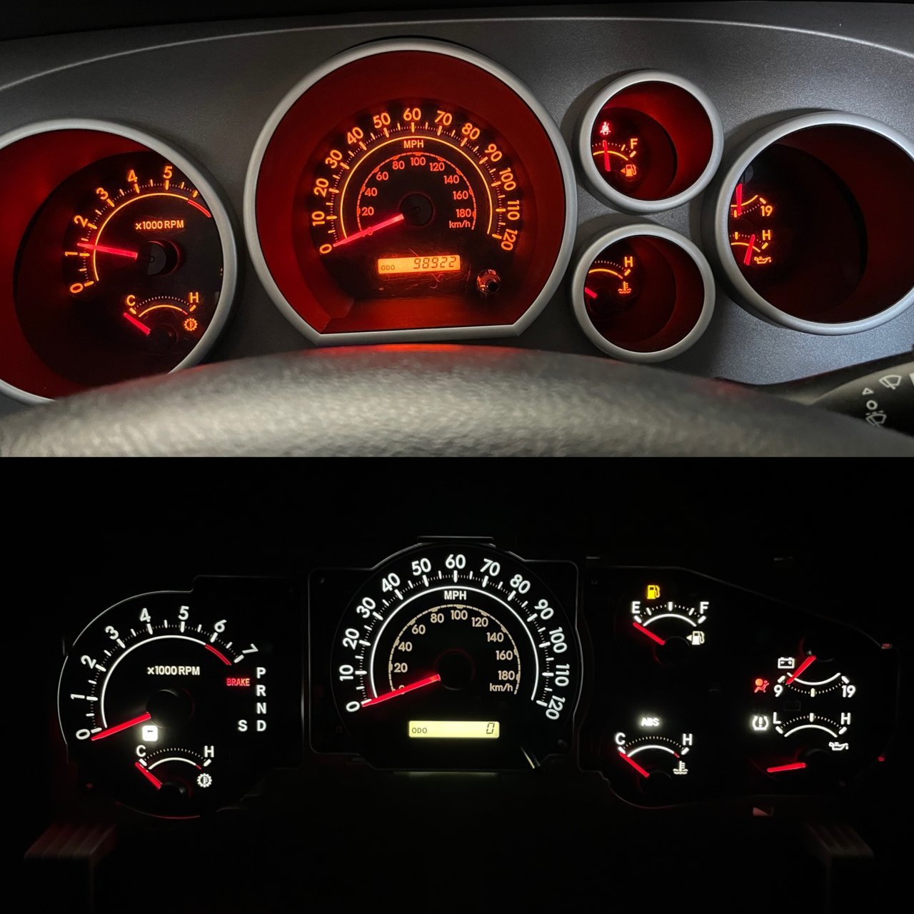

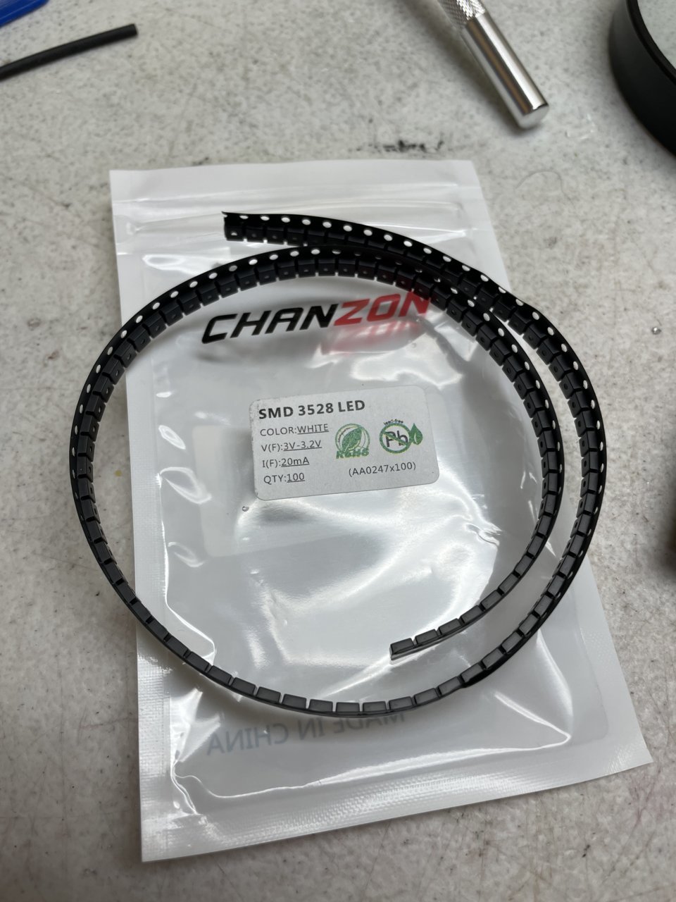

    I got my package of white LEDs and will be swapping out the amber ones on my old cluster. Stay tuned!

    Before and after pics! And progress pics!
    I'm curious to see the variance in brightness from the original orange to the white. Are you going to change the color on the needles too?

    Fair enough...I'm going to play around with mine when I get that far, probably go blue. If it turns out I may swap the Optitron for blue as well. Did you plug it back in to get the preview, or just set it up with 12v power?

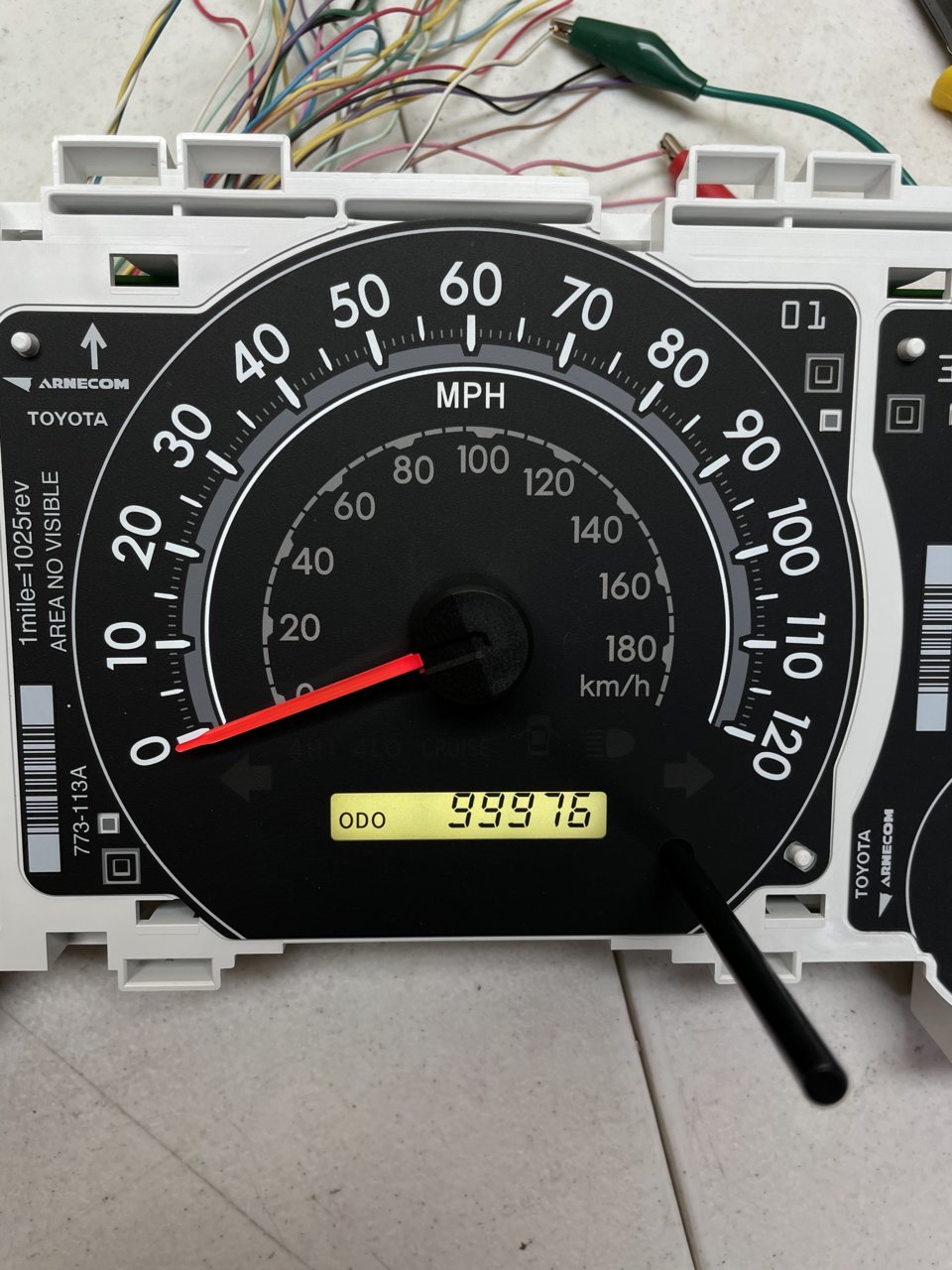

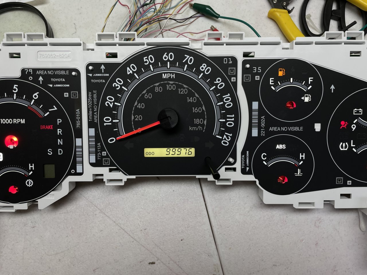

    I gathered up the courage and decided to program my chip from my old cluster to 100,000 miles for testing purposes and had success! It shows 99,976 which is close enough for me! The mileage was 98,922 before I programmed it.
    I desoldered my chip, programmed it, and reinstalled it. I used this video as a reference to set up the programmer and programs as well. All of the information will apply to the Tundra as well (tested on my 2012). The only difference was that I had to use Neoprogrammer instead of ASprogrammer. It’s pretty much the same program but the updated version.
    https://youtu.be/RqOM-4MLGhY

    Huh...so that's interesting that it's off by the 4 miles. I guess there must be some sort of logic built in there where it reads those "unknown" F F bits and incorporates those into the total, and it could be +/- vs. the other known bits to program. Interesting.

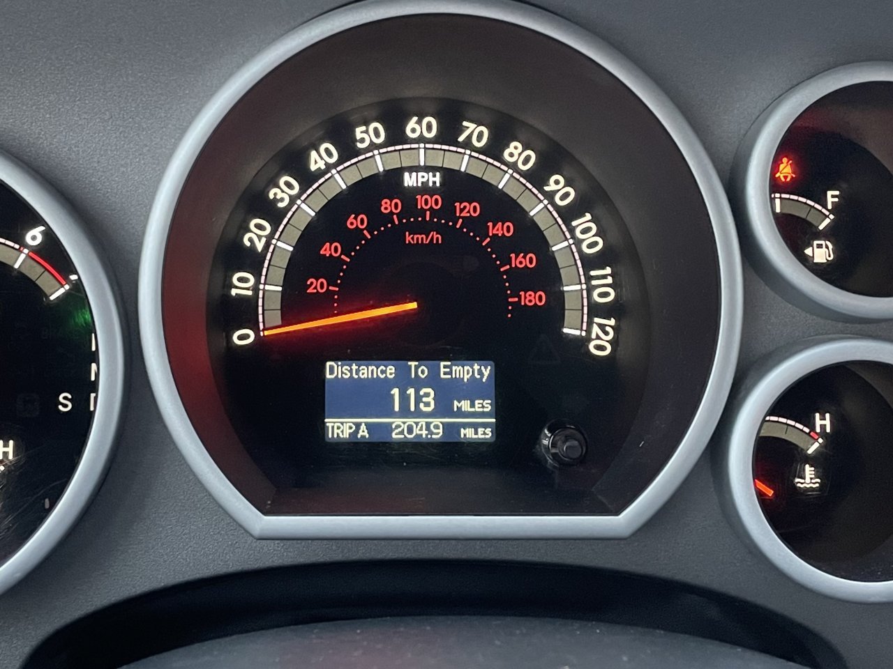

    My distance to empty is starting to look more accurate. I reset my trip A to keep track and it’s just about there!

    For reference mine says 298 after topping off
