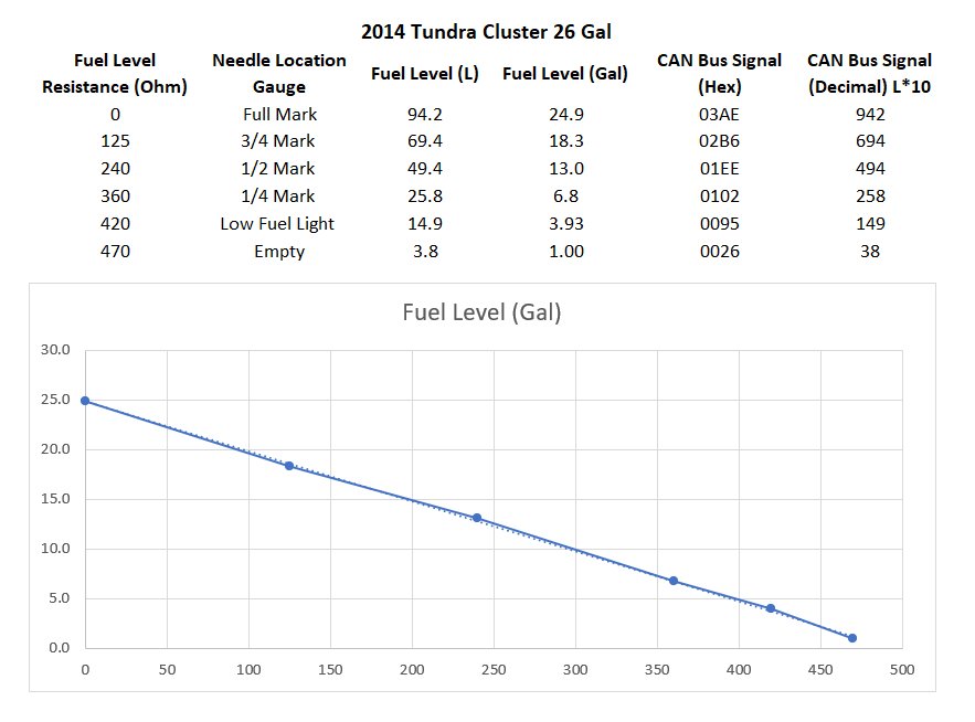

    For you guys with fuel gauge issues I just made this chart. I sent resistance values to mimic the fuel tank sending unit to my benchtop cluster.
    When I got the needle as close as I could visually to the marks on the gauge I recorded the resistance value (the number coming from the sending unit in the tank). I then read the CAN bus signal sending out the fuel level produced by the cluster (# LitersX10) and converted it to gallons.
    Seems resistance value is 0 Ohms at Full tank approx 25 gallons. Empty is about 470 Ohms or 1 gallon. The CAN bus signal would not go lower that 3.8L left no mater how high I made the resistance, nor could I get the CAN signal to go any higher than 94.2 L at 0 Ohm resistance.
    Remember all the sending unit does is send a resistance value of 0-500 ohms and the cluster reads this and does the rest. FFV cluster might be using different math or the sending unit in the tank is operating on a different range, not 0-500 Ohm. (Maybe 200-700 or some other range)
    General rule of thumb seems every gallon of gas you burn from 25 down adds 20 Ohms.
    25 Gal = 0 Ohm
    24 Gal = 20 Ohm
    23 Gal = 40 Ohm
    This is a close approximation
    For you guys with a gauge reading improperly this might help. I would measure the resistance coming from your factory sending unit into the back of the cluster and see how far off your FFV needle looks. You could alos use Torque or OBDFusion to get a digital value of fuel tank level in gallons. This will come from the sending unit signal. With the app telling you how many gallons are in the tank maybe you can visually see IF and how much your FFV needle is off. (Tip if you convert the app gall level to liters and multiple by 10 is will give you the Decimal CAN signal)

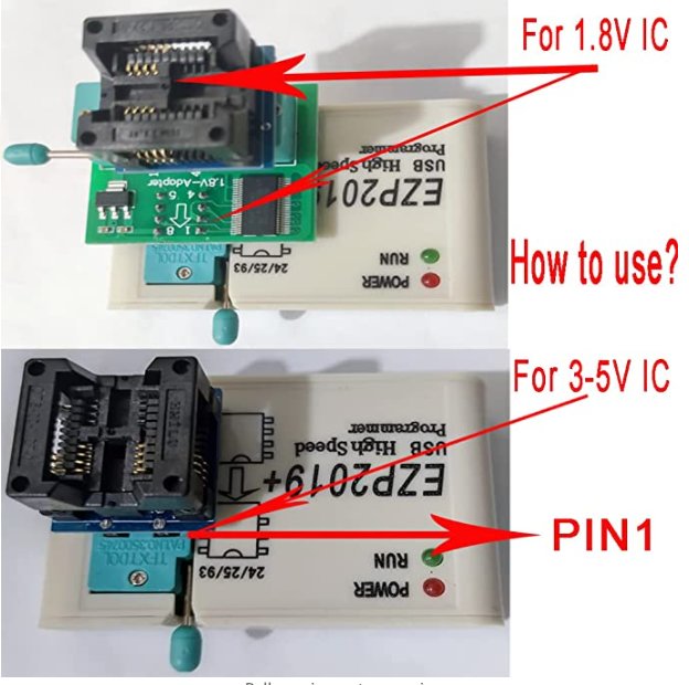

    So, I am not any sort of electrical engineer, but I'm wondering if something like this may work: https://www.amazon.com/SETCTOP-EZP2019-Programmer-Socket-Support/dp/B07RX3FLFT
    It's a programmer for 24/25/93 series chips, and appears to come with an adapter that makes it work with 1.8V, but natively without that looks like 3-5V?
    There's a lot of bits and pieces that come with the kit, but they mostly appear to be adapters for use with various chipsets and I would think could be easily figured out (may be included on the little disc that comes with it, but probably online as well).
    I did also find the same thing for $11 on Aliexpress, though I've never ordered from there before...

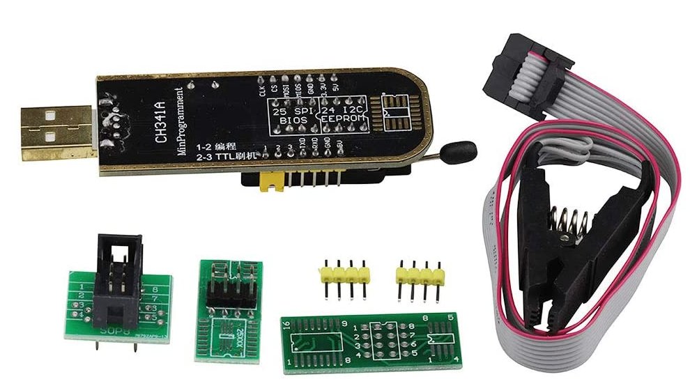

    Ahh did you guys see the Video I just posted. You likely only need a for $10 bucks. Granted you will have do some soldering but its very doable.
    CH341A Programmer - SOP8 SOIC8 Test Clip Socket Adapter for EEPROM 25CXX / 24CXX + CH341A 24 25 Series EEPROM Flash BIOS USB Programmer Module"
    https://www.amazon.com/VKLSVAN-Socket-Adapter-EEPROM-Programmer/dp/B08CDCPPTZ?pd_rd_i=B08CDCPPTZ
    This link shows you how to set the programmer up - https://www.youtube.com/watch?v=RqOM-4MLGhY

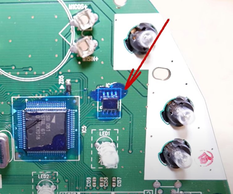

    Open that sucker up and look for the IC6 Chip - Looks like thats the chip that has the mileage info written to it. Also read the chip and get a closeup pic for it to see which chipset it has. We will need that info to program it.
    This is from the 2001 IS but you get the point

    I got my original pulled apart and don't see any IC 6 chips but I do see one with blue stuff around it and I an suspecting it's the chip with the mileage information.
