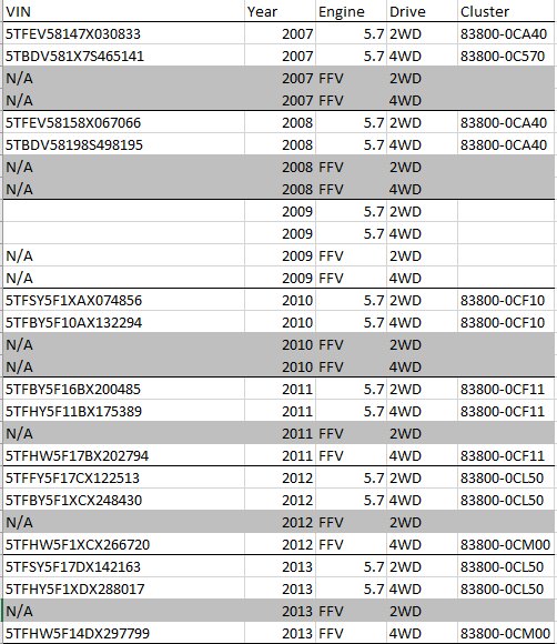

    I swear this is all the research I'm going to do today on this. I stalked several used car sites and found as many examples of the year/engine/drive/trim for each year that I could. Found a few possibly interesting tidbits:
    1. 2009 doesn't appear to have offered a Limited trim level?
    2. The FFV doesn't appear to be available in 2WD until 2016+
    3. The FFV wasn't available in 4WD until 2011
    4. The gauge cluster in the 2007 was different part numbers for 2WD/4WD
    5. The 2008 cluster is the same as the 2007 2WD cluster
    6. The gauge cluster for each year 2008-2011 is the same part number for 2WD/4WD/FFV/non...a single part number, albeit different for each year
    7. The gauge cluster for 2012-13 is the same for the non-FFV 2WD/4WD but different for the 4WD FFV
    If anyone is super bored and wants to try and fill in the blanks here, that might help. I'll maybe try later when I have some free time. Keep in mind this list isn't necessarily comprehensive...if I have some time I'll look up several example VINs for years to see if anything shifts mid-year or there are other anomalies.

    Now that I have my handy-dandy chart...I think the explanation isn't the fuel tank, but the year/engine you got it from. Based on my chart, the 2013 FFV are a different part number than the non-FFV, hence why I'd think it's driving your issue with the fuel gauge readings.
    Since your truck is a 2008, odds are you'd need a 2008 non-FFV cluster (83800-0CA40) to be an exact match...but I'd guess that maybe the 2008-2011 clusters would work, since the FFV and non-FFV parts are the same. I'm guessing that the sending unit is irrelevant in those cases, otherwise they'd have different cluster part numbers, which the 2012 and 2013 DO have for the FFV (but the 12-13 use the same part number for the non-FFV and FFV).
