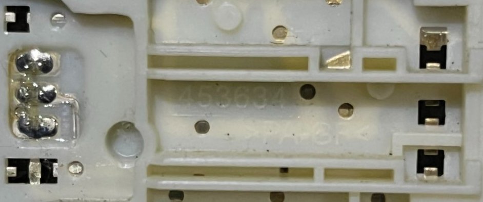

    You'll have to get some soldering wick to open up the holes again or a solder sucker. The pins must be pushed through the board before adding soldering to them. The level of difficulty can be a 7/10 if you have never done any soldering before.

    ...with zero explanation. Trying to solder the wires essentially to the tiny little outside ring of any of the numbered spots is difficult, at best, and then there's no explanation on the actual pins themselves, not in any videos I've watched.
    I'm about at my wits end. The stupid EZP2019 I bought is borderline useless. It worked like once, and now all it does is tell me I have either an unknown chip or a 24 EEPROM, neither of which is correct. I'm at a complete loss as to why it worked for the first 2-3 reads and then essentially went to crap. If I do get it to read, it read maybe 2 blocks of data. Worthless.
    So, dinking around with it, I can get it to read as a 93 chip...funny enough, it works with the 1.8V adapter that came with it, but reads no data.

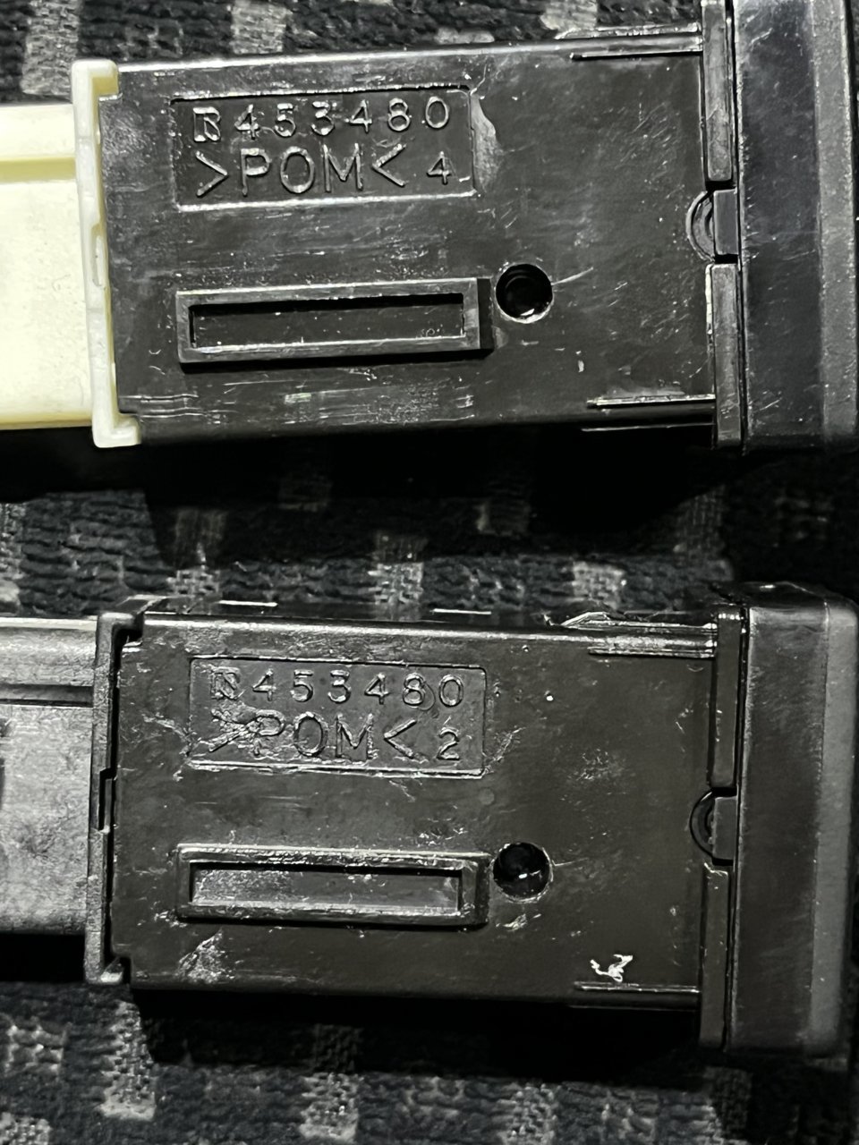

    I think this was an important part. My truck had 4 wires to the stock switch.
    Also worth noting my original switch did not roll and lock into top position. The new switch does but only dims headlights when not locked into top position.

    I don’t believe the black end switches did. The white end switches have that function
    If @FredB32 next switch works I’ll order one more rheostat from a known tundra limited/platinum

    You can put the wires through the numbered holes and the other end of the wire to the jumper leads. I had some 30 gauge wire that was very thin and workable for those tight spots.
    Removing your chip would increase your chances of getting a proper read too. I was not able to read while my chip was still on the cluster.

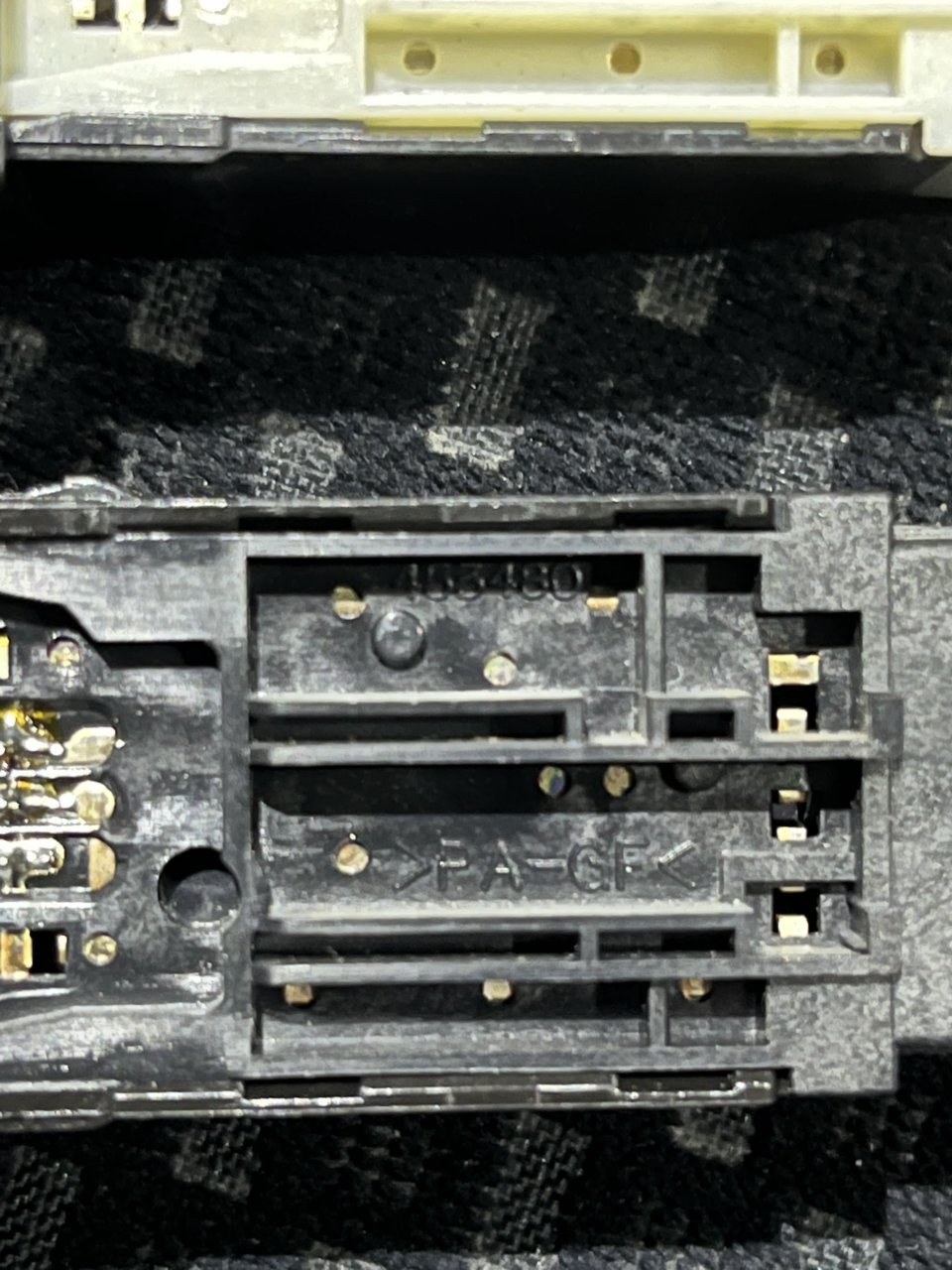

    So thinking about this yet again. I ran a wire from pin 38 on cluster to pin 5 on the dimmer switch (where the soft blue wire should be). We decided that LJ wasn’t necessarily needed as it was the middle man and I could not locate it. After doing this I still did not get dimming function. But his directions mentioned a jumper from pin 5 (SB) to pin 7 (tan). I didn’t put any kind of wiring between these two pins. Do you think that could have been my issue?!
  11. Apr 12, 2022 at 4:51 PM
    #341
    Jeff_5_7
    Jeff_5_7 New Member
    Feb 20, 2021
    #59378
    1,443
    Jeff
    Houston Tx Area
    2007 RCSB 2014+ TRD Pro Conversion 5.7 4x4
    Full 2014+ Conversion Regular Cab Short Bed 4X4 2019 TRD Pro Grill, 2014+ Front End Swap 2014+ Interior/Dash Swap with TRD Pro Leather Seats, 2014+ Bed Swap with TRD Pro Stamping SOS 2/4 Drop Kit
    Jumping pins 5 and 7 on the dimmer bypasses the taillight cancel switch in the dimmer.
    I haven’t been reading this closely enough to understand what the tailight cancel part of the dimmer actually does, but if you think bypassing the switch closed will make the dimmer work it could be worth trying.
    I need to read and understand why/ what the function of the taillight cancel switch is

    I did check my original switch last night as well...it does NOT lock when rolled up all the way. So I have one that does, one that doesn't, and neither give me dimmer functionality with the headlights.

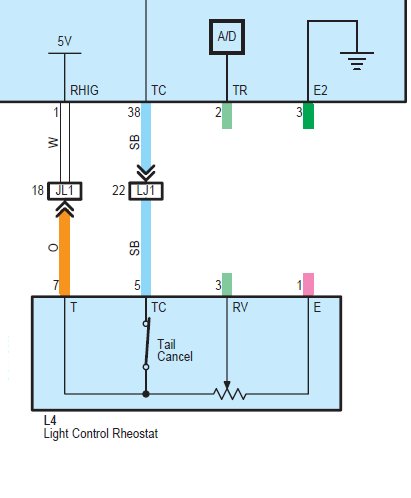

    Just found this in the Toyota repair manual. "TAIL cancel switch: When the headlights are illuminated and the TAIL cancel switch is turned on, the
    meter and accessory meter do not dim."
    @FredB32 @Musicmasterd12 can one of you guys with a dimmer switch that locks and clicks at the top hook it up to a multimeter?
    Set your multimeter to the continuity setting, it should beep when the leads are touched together. This is check for "flow" on continuity between the leads.
    Put one lead on Pin #7 and one lead on Pin #5 of the dimmer. This is each end of the Tail Cancel Switch. Then check for continuity with the dimmer wheel rolled all the way up locked and then with it rolled down unlocked. You can do this on the bench with the switch out of the truck. No need to power it or anything.
    As I said it should beep if you have flow through the switch. I am thinking the way it is wired, you will have flow (beep) when the wheel is not locked in the up position, and when it is locked in the up position no flow across these two pins. Hopefully
    If one of you could verify this that would be great. You can also just measure the resistance across the two pins with the switch locked and unlocked. High resistance the switch is open, low resistance the switch is closed.

    It seems to me the upgraded optitron is looking for the taillight cancel switch and the base grade ones are not. Maybe..
    If I am reading the repair manual correctly, locking the switch in the up position opens the tail cancel gate and no longer allows the dimmer to function. However rolling the dimmer down from locked, closes the tail cancel gate and allows for dimming.
    IF my assumption are correct you could "jump" the gate closed by running a wire from Cluster Pin #1 (5V) to Cluster Pin #38. Sending 5V into Pin #38 will the cluster think the Tail Light Cancel Switch is turned off, then your 3 wire dimmer switch MIGHT work.
    Could be worth a 10 min check to see. Plug in the dimmer switch, then just jump a wire from the back of the cluster, Pin#1 over into Pin #38, you just need to send 5V back into the cluster on #38 to fool it

    I think it depends on how the switch is wired. Is it normally open or closed. Testing with a multimeter is the only way I know how to check.
    From the wiring diagrams it is my assumption that sending 5V up the Pin#38 "allows" the cluster to Dim..... however it could work the opposite way where sending the 5V locks the cluster at full bright with no dim feature. Toyota really doesn't explain how the switch is wired very well. BUT I do know the Tail Cancel switch enables/disables Dimming and I would assume the cluster is looking for a signal from it to allow/not allow dimming.

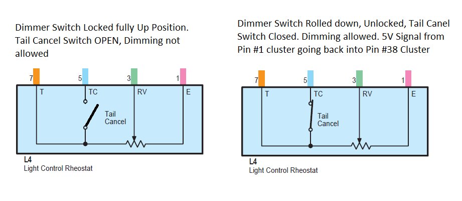

    I think I got it figured out - assuming it's the light blue and orange wires at the top of the plug.
    When the switch it locked in the up position, I get no resistance (multimeter reads 1 - also not this cheapy doesn't have actual continuity), but it drops to 001 when I roll the switch down.

    Yes it is the Orange and Light Blue wires. These are each side of the switch.
    No resistance when the switch is locked in the up postion tells me the "gate" between those two pins is open.
    However if you get resistance with the switch rolled down unlocked, that means the "gate" is closed which links Pin #1 5v at cluster to Pin #38 at the cluster.

    It would now make sense as I was saying earlier that, the cluster needs 5V coming in on Pin #38 or else it thinks the Tail Cancel feature is enabled and will not allow the dimmer to work.
    As stated, Jumping a wire directly from Pin #1 in the back of the cluster to Pin #38 in the cluster completely bypasses the switch and fools the cluster into thinking the Tail Cancel feature is turned off, which should then allow for dimmer inputs to be recognized.

    Y’all are going to make me drag out my cluster and do some testing.
    The only thing I can think is the cluster uses the dimmer input to change a CAN signal to alter the brightness. The analog input is converted to digital and feed to the lights. I’m not sure if this is the case but it could be.
