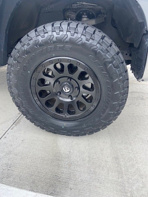

  13. Apr 10, 2023 at 4:36 PM
    #253
    birdman076
    birdman076 Bird, bird, bird...bird is the word
    Jun 18, 2017
    #8174
    529
    Chuck
    Montana
    2015 Brown Tundra Crew Max Limited
    Airbox with K&N Filter, 2" lift on 33's, Alpine iLX-F309 head unit, Pull out bed tool boxes, brown with black trim, rims, etc, black leather interior, matching topper. Muffler delete (too loud..) 62k miles!!!
    295/70/18 Goodyear wranglers on TRD rims with 1” spacers and 2” lift. IMG_7409.jpg

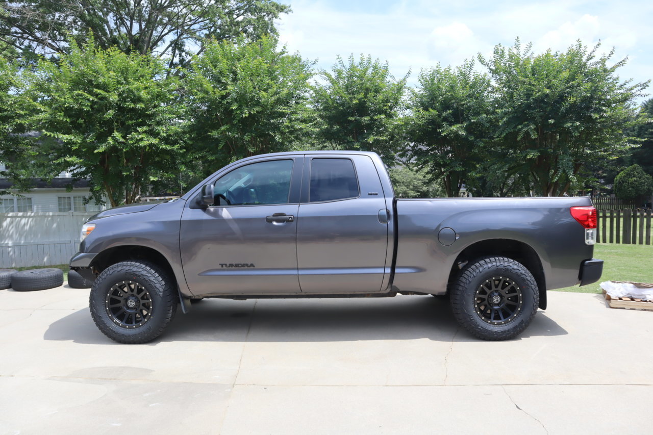

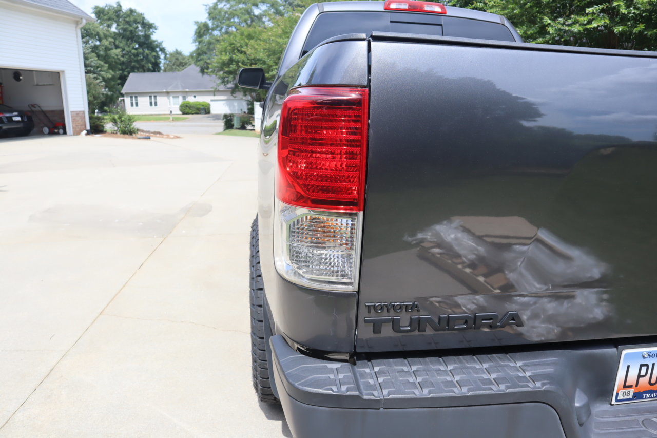

    295 70r18 mud tires with stock everything. 2012 trd off road 5.7 double cab. Looks amazing!!!
    Did have the trd rims...
    PS: had to trim the corners off the skid plate, that's it!!!!!
    Yes 295 70r18 fit!!!

    No spacers, no lift!!! Your front wheel well is where u need to worry about!! Lift ain't shit!!!
    I'm so glad I didn't follow everyone's advice on all these forums and did my own thing!!
    My truck looks mean and I have nobody on these forums to thank except myself!

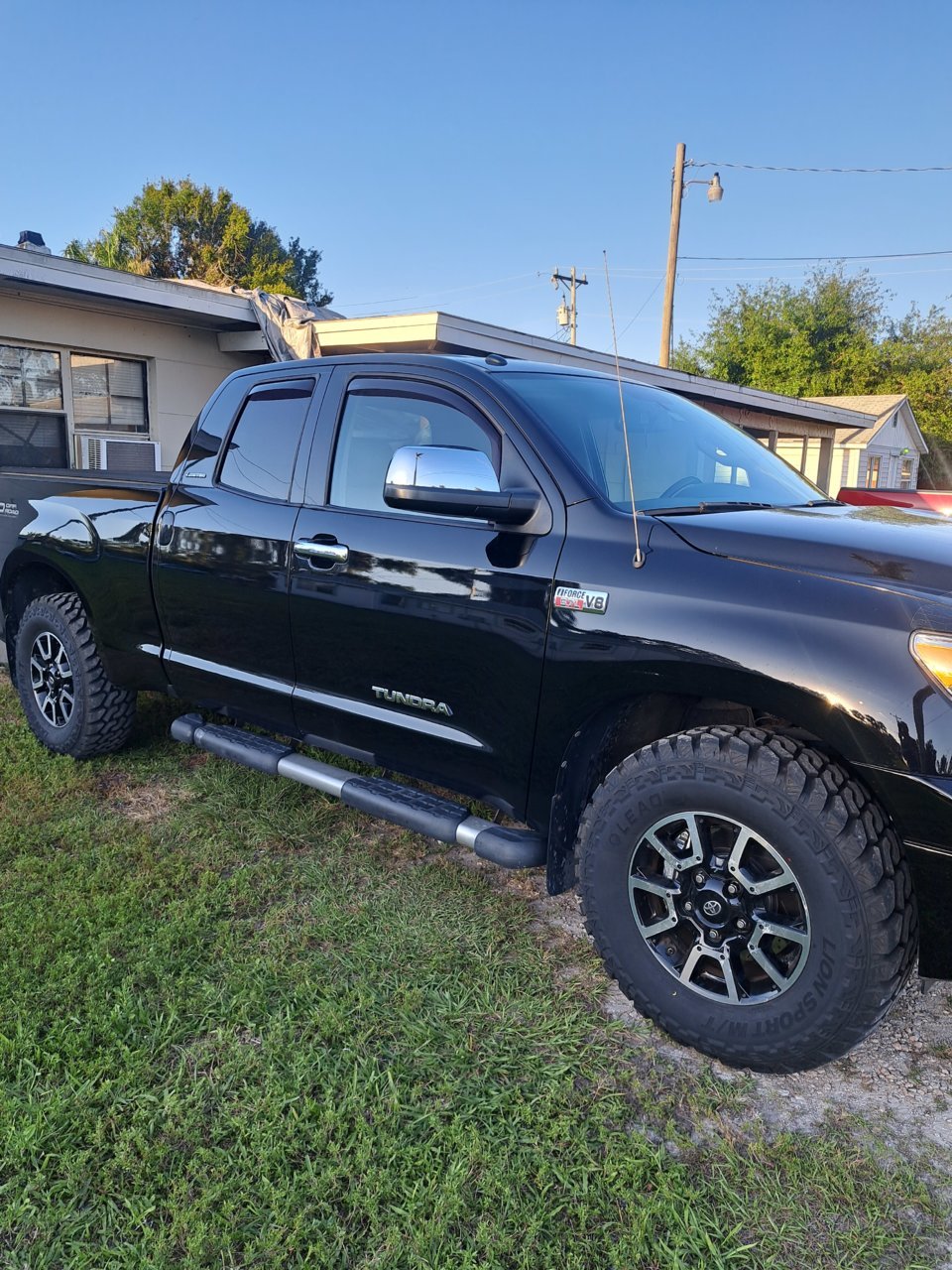

  18. Apr 27, 2023 at 9:29 PM
    #258
    Jrad08tundra
    Jrad08tundra New Member
    Jul 8, 2018
    #16860
    39
    Jared
    San Diego
    2008 sr5 crewmax
    Bilstein 5100 all around Limo tint all around Airlift airbag kit Plastidip emblems K&N intake Black housing headlights with led’s Method 305 nv 285/65/18 Yokohama at g105 Pioneer head unit with alpine type r 8” sub.
    How do you like the coopers on your sequoia?

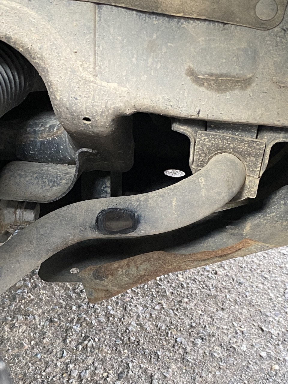

  20. May 4, 2023 at 7:42 PM
    #260
    Jrad08tundra
    Jul 8, 2018
    #16860
    39
    Jared
    San Diego
    2008 sr5 crewmax

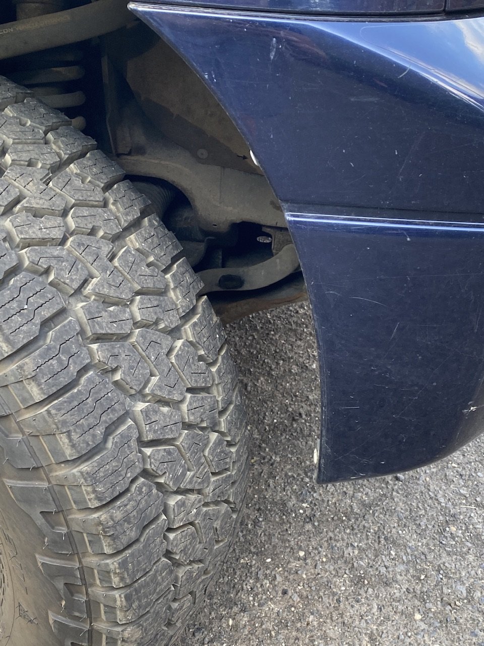

    IMG_0336.jpg 2008 sr5, 1500 top setting, falken wildpeak at3w 295/70/18, method 305’s.
    Minor rubbing had to take off front mudguards and push fender in drill new holes super easy. Love them so far.
    08TRDOFFROAD likes this.

  22. Jun 3, 2023 at 9:44 PM
    #262
    rruff
    rruff New Member
    Oct 18, 2021
    #69521
    1,004
    2016 Tundra SR DC Long
    Strange, I thought 295/70s didn't rub the swaybar with stock wheels? Yes, I'd suggest at least 25mm offset... it's hard to find 30-40mm but that would be ideal. Or get some quality 1" or 1.25" spacers. Less offset will give you clearance issues fore and aft.

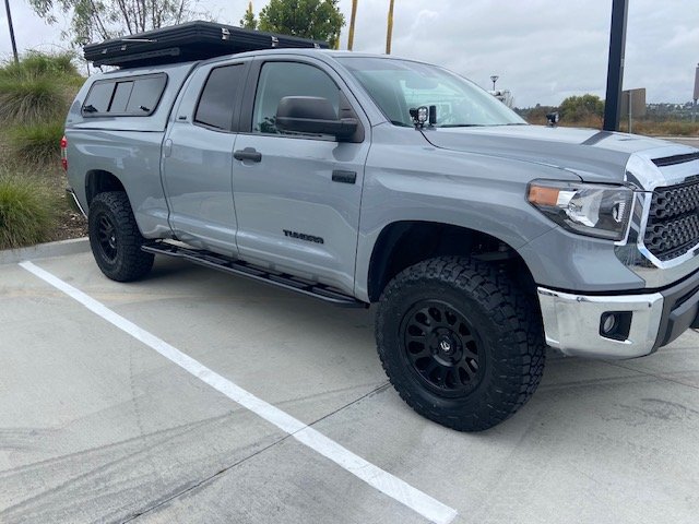

  23. Jun 3, 2023 at 11:11 PM
    #263
    RetiredTundraBC
    RetiredTundraBC New Member
    Sep 26, 2021
    #68564
    56
    San Diego County
    2020 Cement Tundra
    Snug Top, Icons, RXT Fuel Wheels, Toyo RT Trail, Prinsu Top Rack, Iceco Fridge,MIA RTT, RCI Skids,Sliders
    295/70/18 Toyo RT Trails

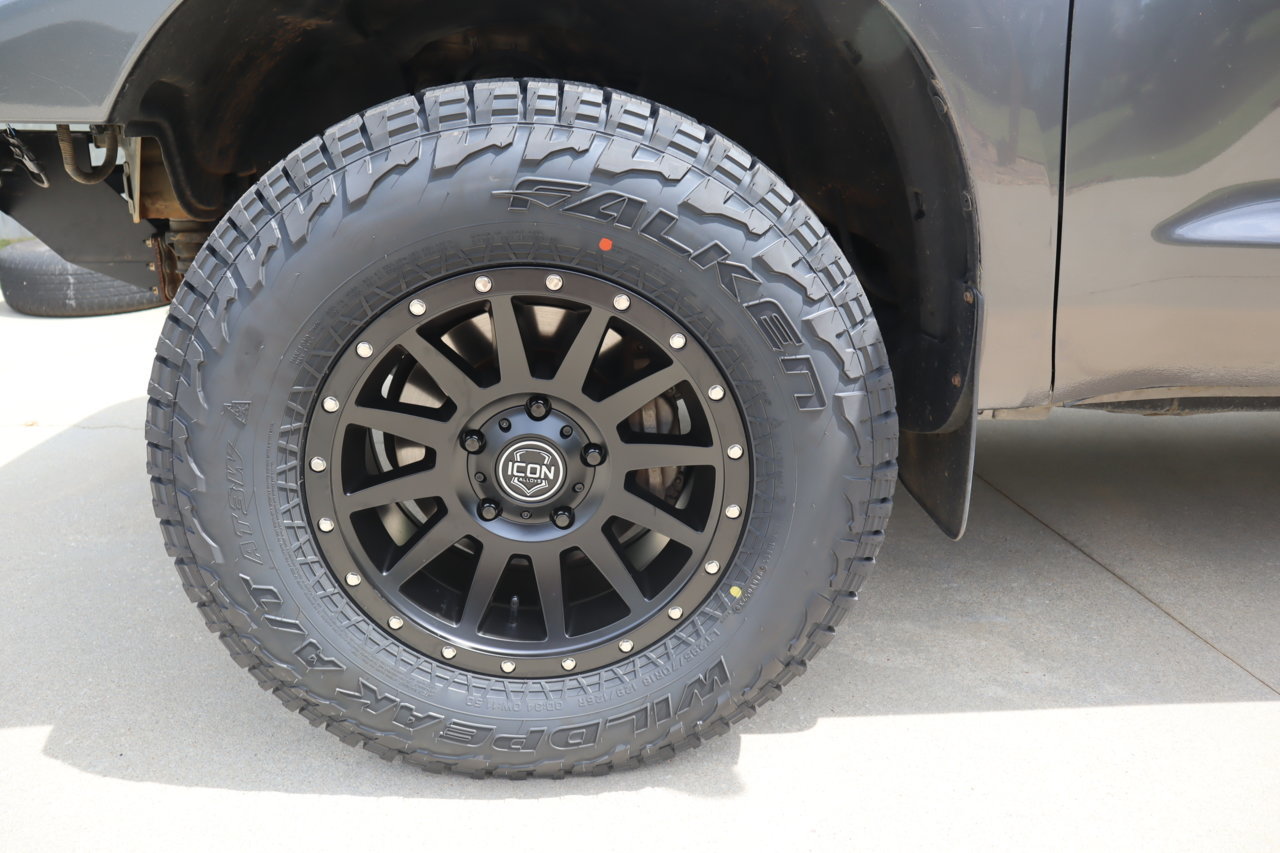

    My experience so far:
    Falcon shocks set to the level setting in front
    High clearance front bumper
    No skid plate
    Icon 18x9 +25 offset
    Falken AT3w 295/70/18
    No rubbing that I can detect at this time.

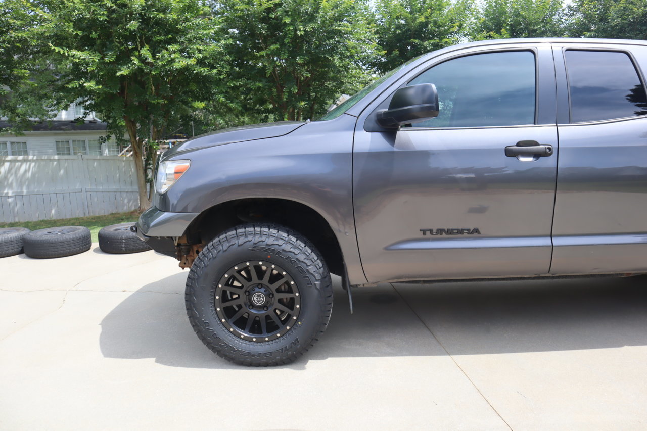

  30. Sep 21, 2023 at 4:46 PM
    #270
    Rngr188
    Rngr188 Ranked the best new member of all time
    Feb 9, 2017
    #6285
    1,534
    Chad
    Harrison AR
    2020 1794 MGM TRD OR

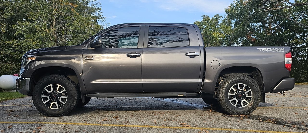

    295/70r18 Toyo RT Trail, Bilstein 6112's at 1.9", no trimming, no wheel spacers, and no rubbing.
