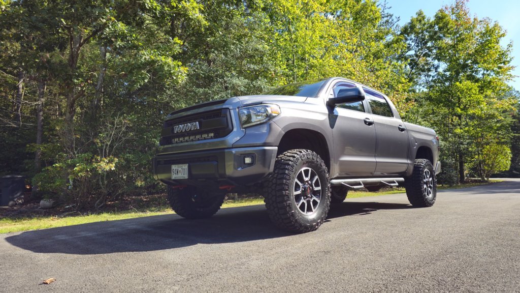

    295/70R18 nittos: 3/2 on my rig20200317_160937.jpglove the rake with a 3/2 lift

    Bilstein 5100 2.3/1.5, TRD sway bars ft/rr, Cooper Tires Discoverer AT3 XLT 295.70.18, Vision Manx 2 18x9 +12, APS side armor steps, TRD-Pro Grill and Bulge, de-chromed, blackout emblems, OEM mirror caps and flares, TRD shift knob, Leather wrapped steering wheel, All weather mats
    5100 top setting on Sequoia 2.3"
    5100 bottom setting with 2" spacer on Tundra 2.8'

    295/70 18 Courser CXT. 6112s at middle setting.

    6112's at 2.5+ 1 DS shim in front and 5100's with 1.5 shackles in back.
    Dick Cepek trail country exp 295/70/18

    DBC5F859-3CB1-4CEE-A60F-1CC390783424.jpgCouldn’t get pic to load last time. But here she is.

    Awesome truck. Are you running any wheel spacers to fit those on the stock wheels?

    No spacers. Just removed small flaps on front of wheel well. Occasionally rubs on front inner fender.
