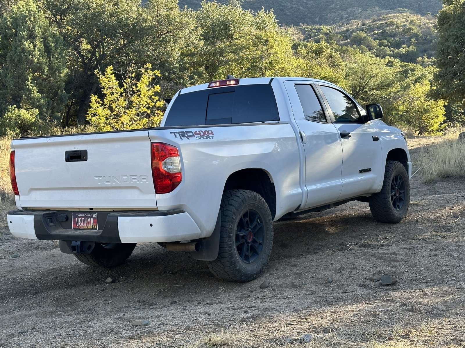

    '16 Tundra SR5 TRD 4X4 Double Cab
    I'm wanting to put some 295s on my Tundra. It's a TRD double cab with a 1" spacer lift up front and stock off road wheels. I've got 1" Bora spacers as well. Seems like I'll be fine but thought I'd check. I've already removed the mud flaps.
    Currently running BFG KO2s in 275/70. I've had these tires on several rigs and always really liked them but these ones have gotten really loud after about 30k miles. Lots of tread left but unbearably loud. Healy leaning toward a set of Wild Peak AT3s.

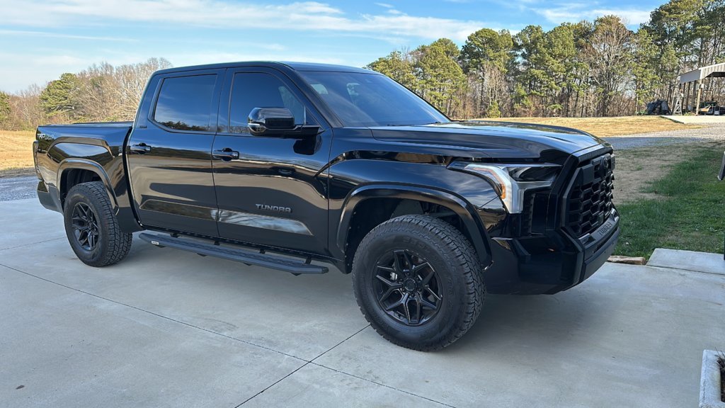

    2021 SR5 TRD Sport 4x4
    295/70/18 Ridge Grapplers.

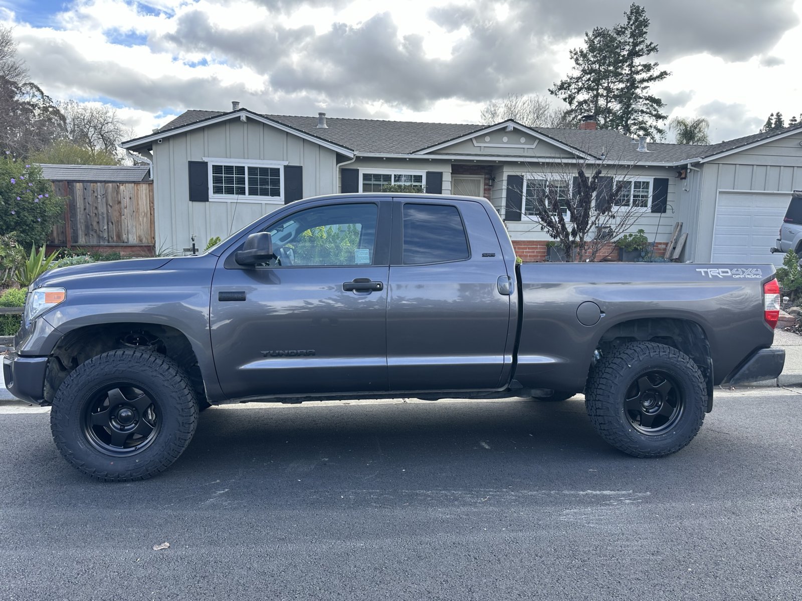

    Here’s my final results: 295/70/18 Falken Wildpeak AT4Ws on SCS F5 18x9 25 mm wheels. I was rubbing on the front mud flaps and the front bumper (even with the CB 1/2” spacer) and the passager side also was rubbing the skid plate. I trimmed the skid, pulled the flaps off and remolded the front liner. I’m not rubbing on flat ground anymore, but I haven’t explored inclines.

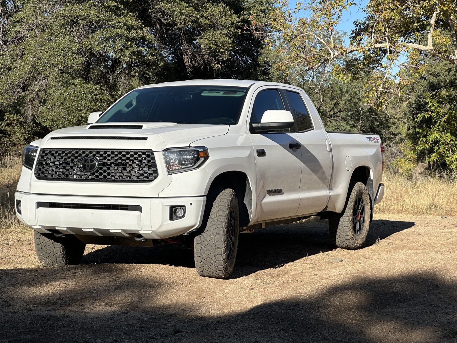

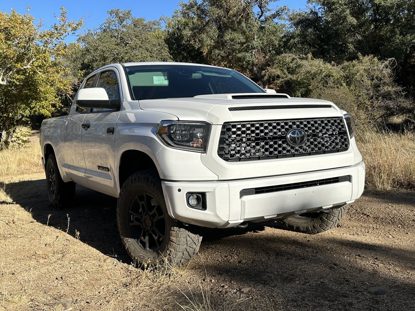

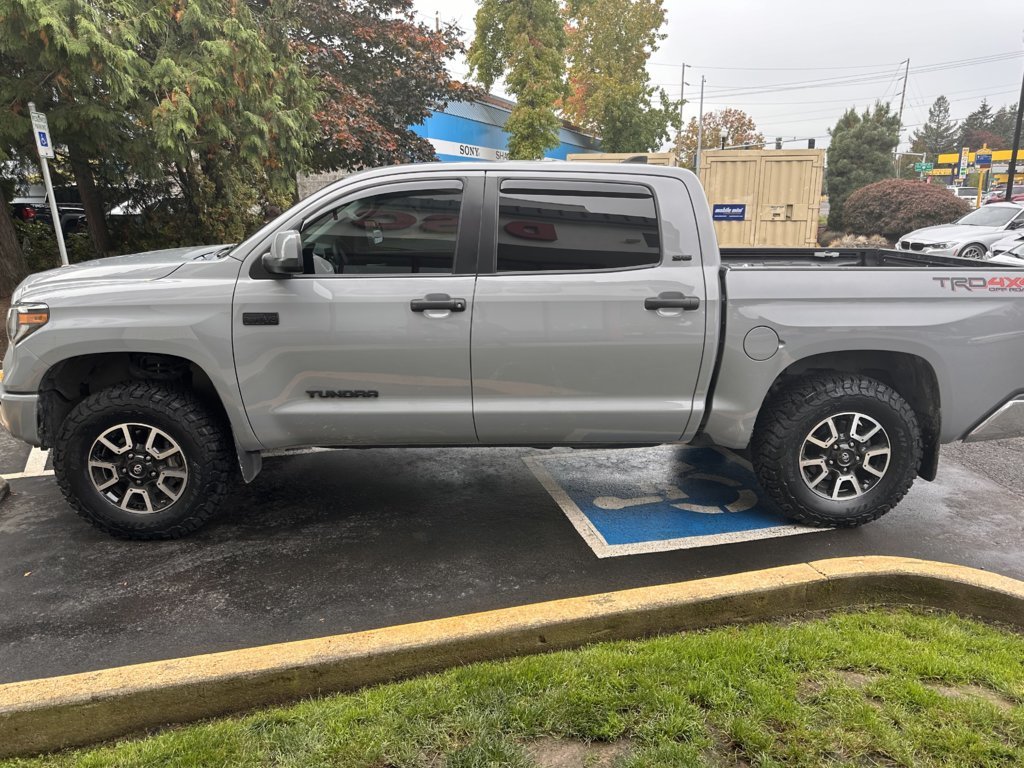

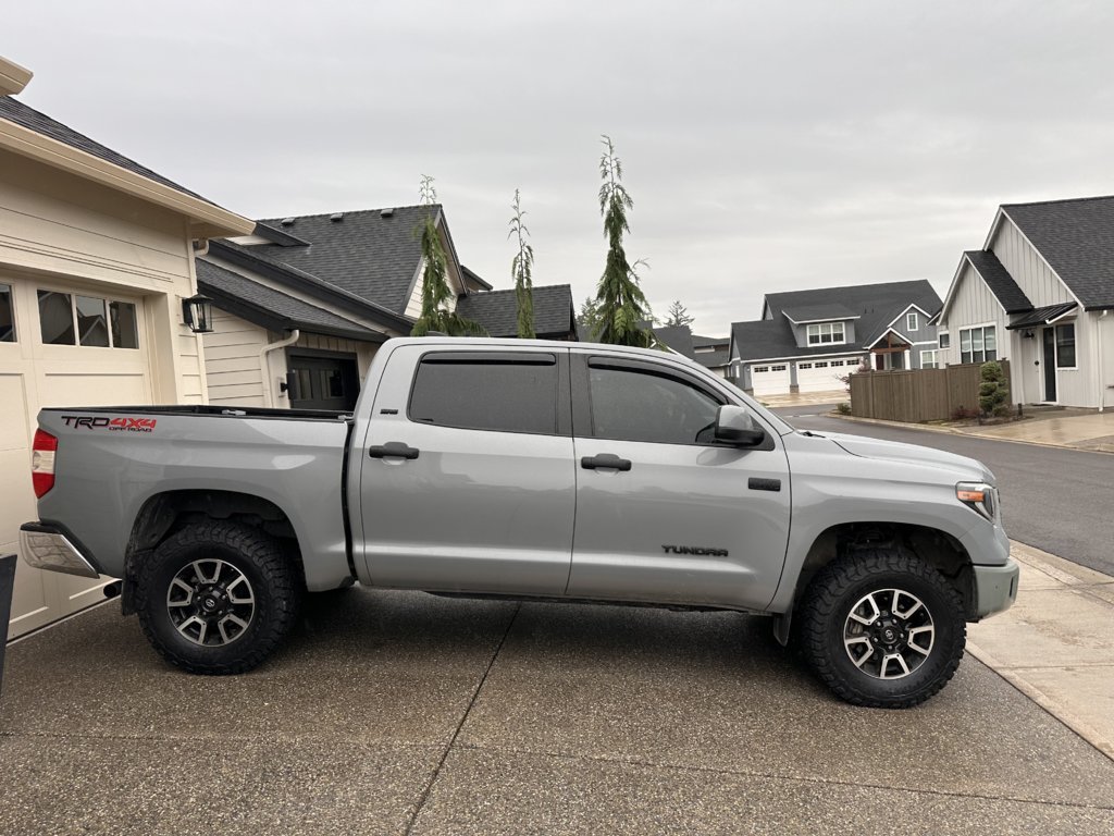

    - Bilstein 5160/6112 - BFG KO3 295/70/18 - Black Emblem badges - AJT key fob - Front window tint and windshield Sun strip - 2021-22 TRD Pro bed storage boxes - leather wrap steering wheel - MeSo Customs LED white/red cabin lights - TRD shift knob
    295/70/r18 BFG KO3s. Running Billstein 6112s in the front (top setting or 2nd to top) and 5160s in the rear. No spacers or any shims. No rubbing or issues.
    I did remove the front mudflaps and shifted the fender liner forward when I replaced the steel bumper caps for color matched versions. No cutting or molding with a heat gun.

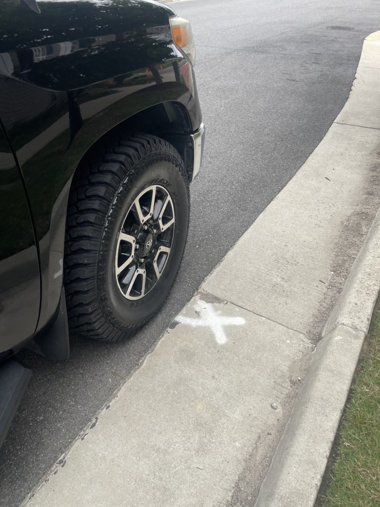

  28. Mar 5, 2025 at 9:43 PM
    #298
    damsamuel
    damsamuel New Member
    Aug 24, 2022
    #82368
    30
    Huntsville, AL
    2022 Tundra SR5 TRD Sport 4x4
    I'm running the last gen yoko geo g015s and I love them. but i am very curious to hear more about the g018, haven't seen many video reviews available yet.
  29. Jun 10, 2025 at 5:48 PM
    #299
    4x4Trev
    4x4Trev New Member
    Apr 9, 2025
    #133248
    Hampton Roads, VA
    2014 Tundra SR5

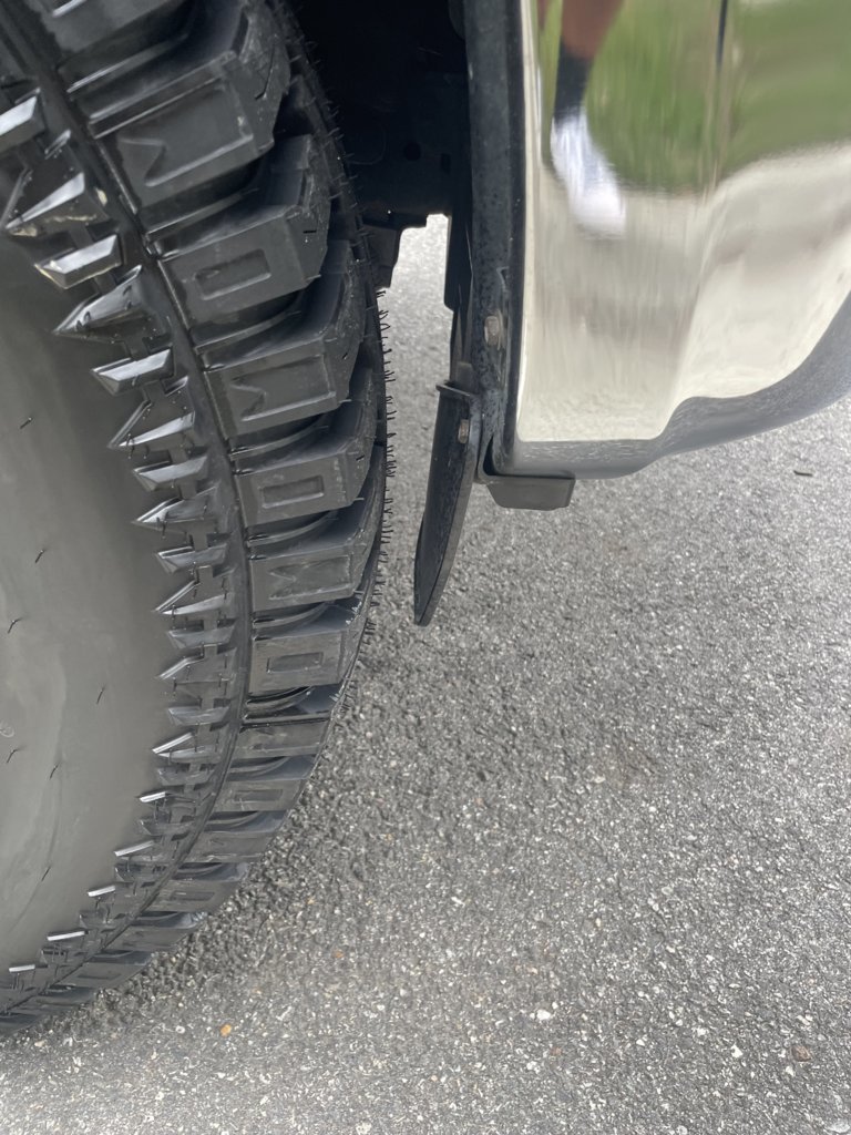

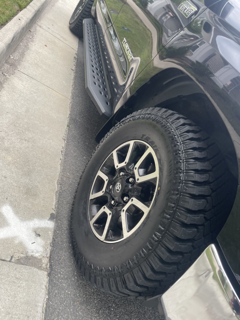

    Just installed Atturo Trail Blade X/T on 14 SR5, stock ride height, and stockie 18s. About 1/4 inch or less from UCA. No rubbing.
    Thanks previous posters for leading me here IMG_0611.jpg IMG_0612.jpg IMG_0610.jpg IMG_0611.jpg IMG_0612.jpg IMG_0610.jpg IMG_0611.jpg
    BillyB and rruff like this.
