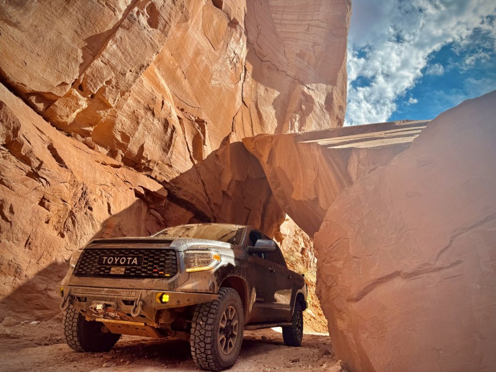

    I’m running stock TRD OR wheels and 285 75 18 tires with no BMC and no rubbing. I do have an off-road bumper…

    Interesting, good to know. How aggressive of a bumper?

    Tanya Harding?
