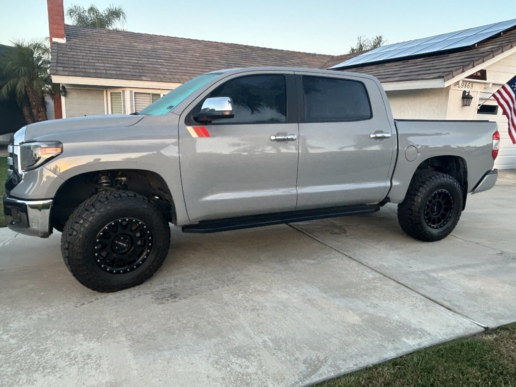

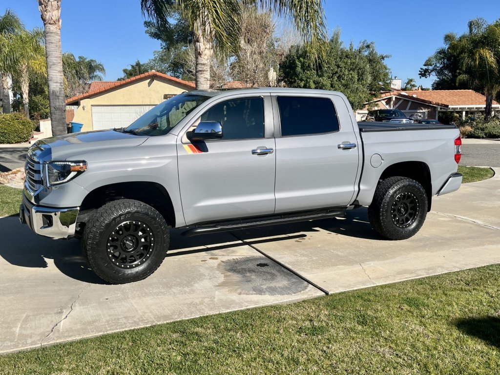

    Not so much performance due to the size but because the tires are great @Albinator . I replaced my 295/70/18 with 285/75/18. They do fill the wheel well better but I did lose 2-3 MPG. Also with the 285/75/18 it seems the truck search’s for gears sometimes.
    Albinator likes this.
  29. Sep 18, 2024 at 6:48 AM
    #149
    TwistedTad
    TwistedTad TRUCK GANG “T”
    Apr 24, 2019
    #29598
    643
    Tad
    Canyon Lake, CA
    2019 Cement Limited CM 4x4
    295/70/18
    285/75/18
