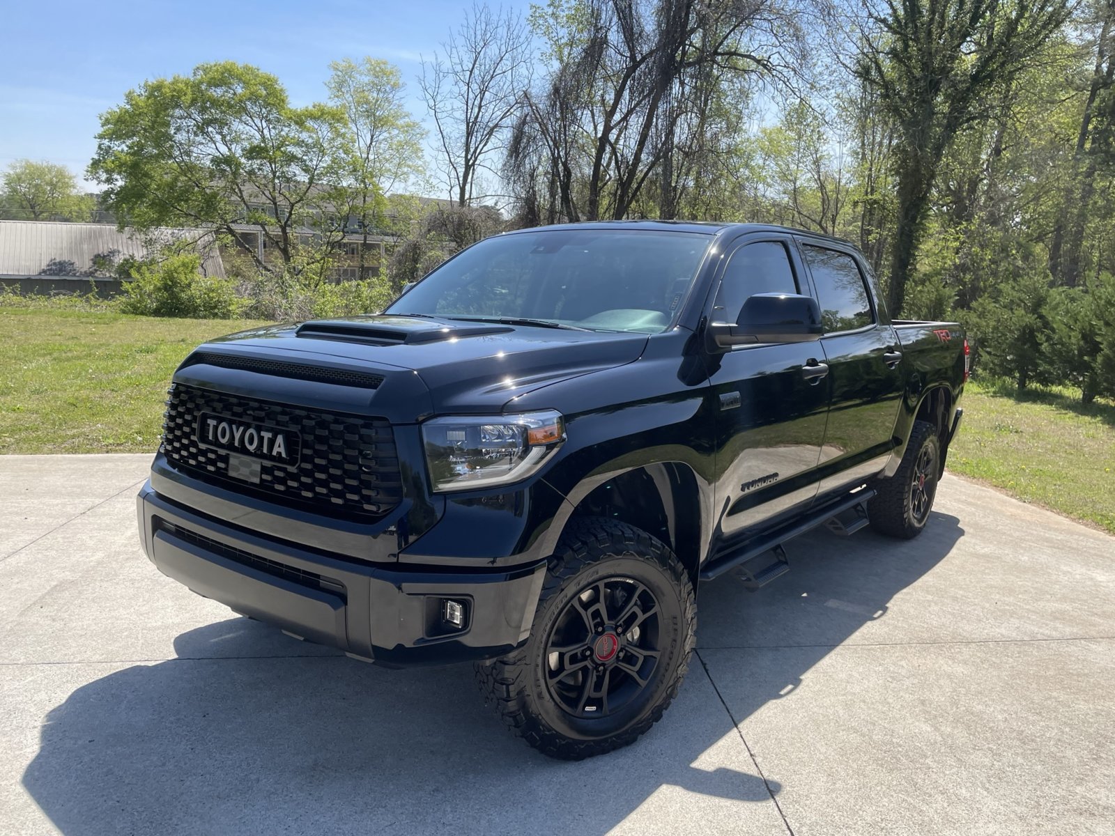

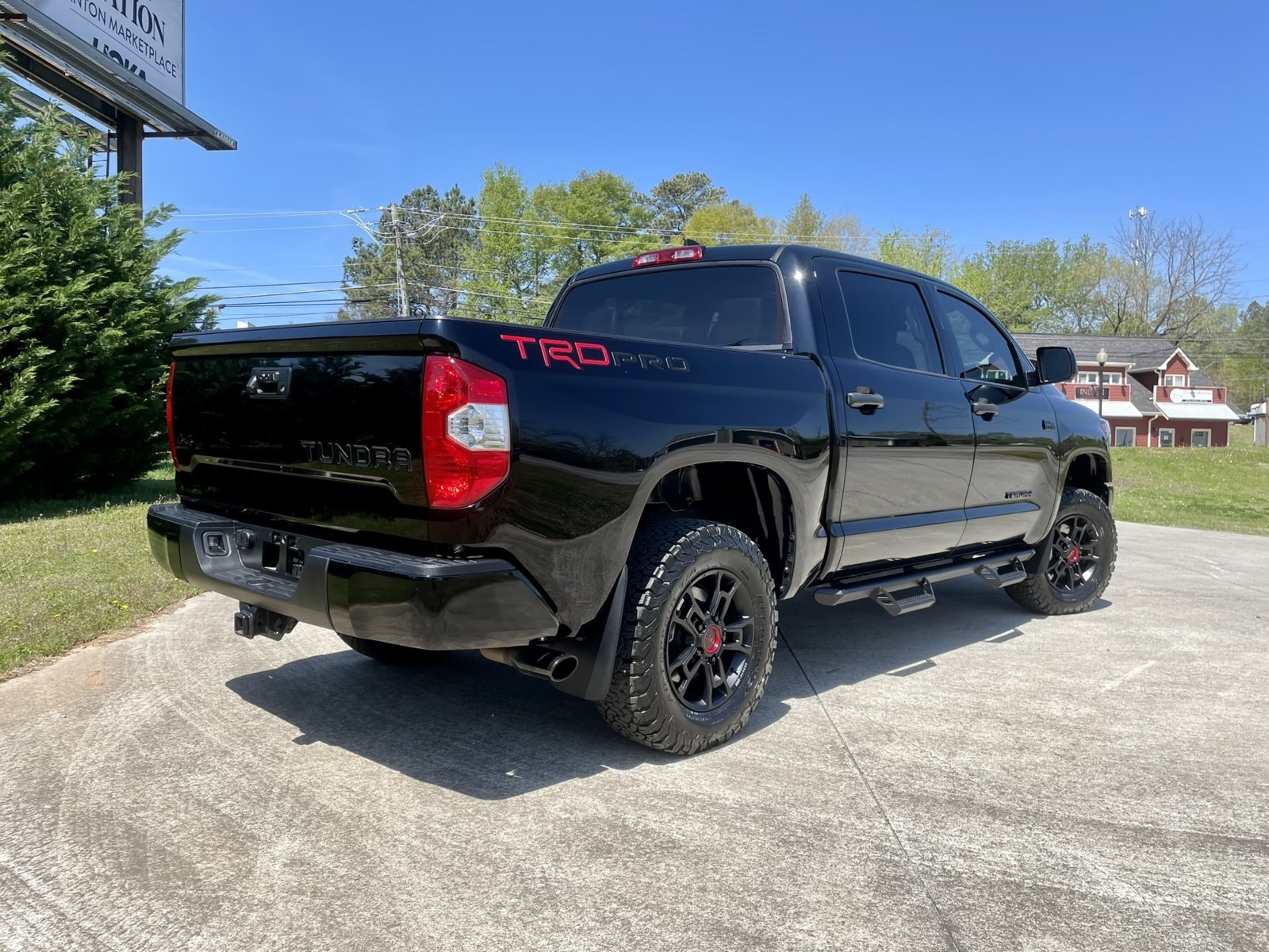

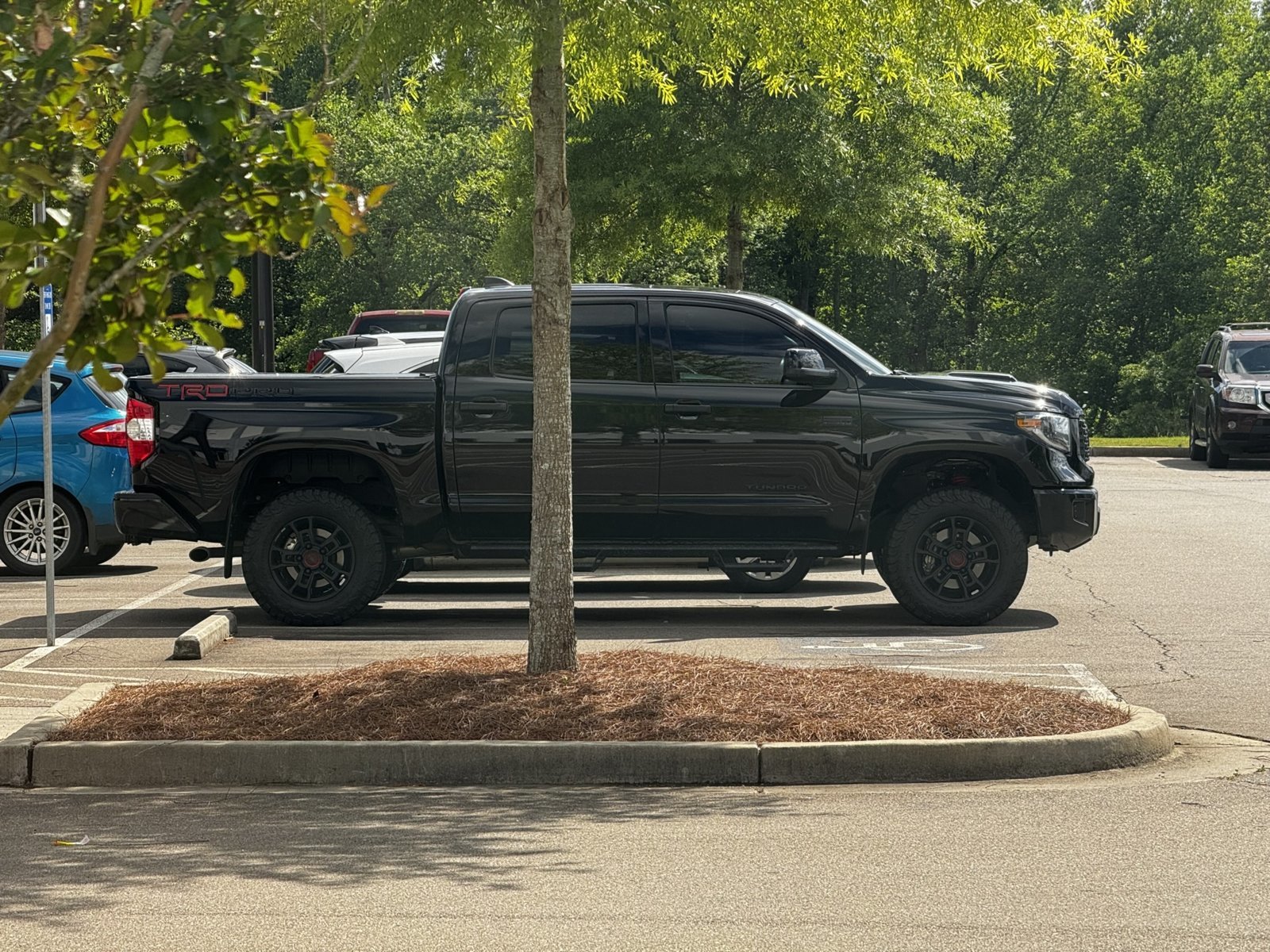

  16. May 16, 2024 at 12:53 PM
    #46
    bucketlintels02
    bucketlintels02 Newish Member
    Apr 30, 2024
    #116160
    118
    NW Georgia
    2021 Tundra TRD-Pro Crew
    RAS Road-Active Suspension System HD. 2" (estimated) Spacer and Block Lift . S&B CAI - closed VLED Footwell lighting MESO Customs Interior Lighting 285/65/18 KO2 Gator Hard Cover Tri-Fold AJT Designs interior trim CSU 9 - year ceramic coating Rigid Amber Fog Covers Full Tint (70% Windshield) 20% all others.
    285/65/18 KO2's Installed new right before I bought it. Has a spacer lift front and rear (about 2"). Although I am back and forth on returning it to stock height, especially with these tires.
    I probably would have gone for at least 285/70 if I had chosen the tire to install.
