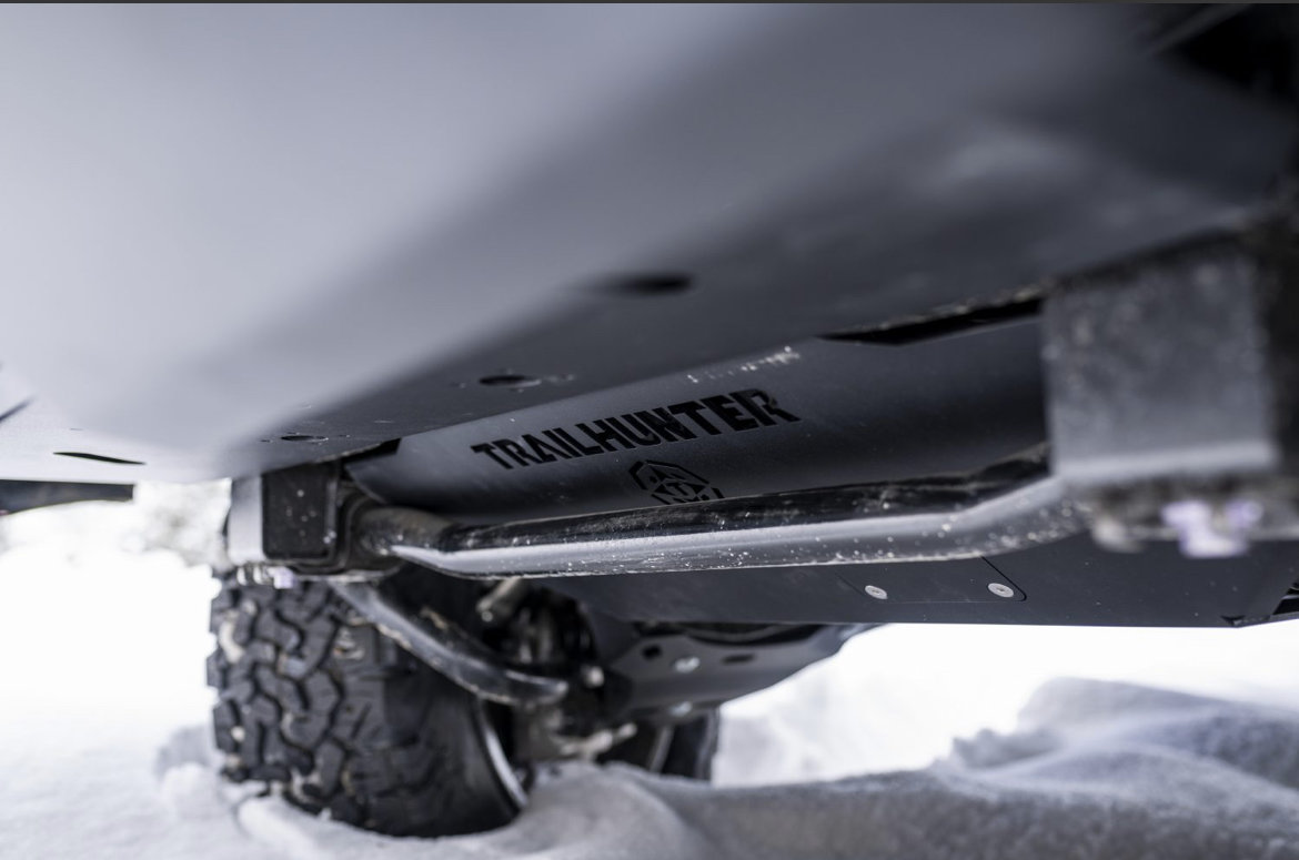

    Photo of the front of the trail hunter edition tundra. Sway bar also outside. Interesting. I am wondering if it is intentional. A lot of thought went into this build and it is utilizing skids that are designed with the build. I am wondering if the intention is for easy on easy off of sway bar for off roading, as I mentioned in my earlier post.
    I ran my taco with no sway bar off road and it was a big difference in front end articulation. It would be very surprising if Toyota “overlooked” this on the trail hunter build.
