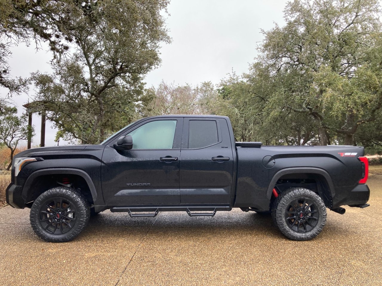

    I've enjoyed reading this entire thread. I just got the TRD lift installed by a local Toyota dealer on my 2023 Tundra SR5 4WD TSS Off Road. They gave me a discount on the kit and the installation Here's the skinny:
    -TRD lift kit (msrp $3,995) = $3,495
    -Dealer install = $1,336.95
    -+ tax = omg
    -Service tech allowed me to keep factory fog lights, though the kit recommends removal and placing plastic covers
    -After inspecting the install, the parts specialist recommended 33X11.5 20 tires to avoid rub in off road settings that I use. Kept the 20" TRD wheels that came with the TSS Off Road package. I went with Nitto Ridge Grapplers--seemed best option for quality and price. Of course, the tires added a lot to the price, including a 4 wheel alignment.
    -Service department carefully wrapped and boxed all my original parts and put them in the TRD lift box. I am now trying to sell those original parts on eBay. If you know someone who has wrecked their new Tundra...
    When I picked up my vehicle after 2 days in the shop, the service manager told me that they will likely increase the hours and install cost the next time. They said the install manual was 72 pages and very complicated. Evidently, it took them longer than I was billed for.
    Driving is a thrill as you are higher up and it has a much firmer ride than my old suspension, but not uncomfortable. I have not taken off road yet, though it will clearly handle rocky elevation changes that I access. My original set up handled rocky off road settings fairly well, though some bouncing around, catching small shrubs in the frame, and a little slip with the original Falken AT tires. I can't wait to get off road.
    Gas mileage with the new lift and tires immediately went down between 3 and 4 MPG on the highway. I'm sure driving habits affect this...
    I believe I have made a high quality performance improvement and investment in my Tundra. This is an elite Toyota modification installed by the dealer with warranty. Pricey, but for my needs I am very satisfied.
    Happy trails, y'all.

  26. Jan 31, 2023 at 1:36 PM

    Congratulations Maestro! Fantastic install and writeup, very appreciated! Your truck looks superb!

    I really love the double cab with the 6.5 bed look. Looks awesome! congrats!

    Very nice Maestro! I agree - like my truck even more with the OEM lift!
