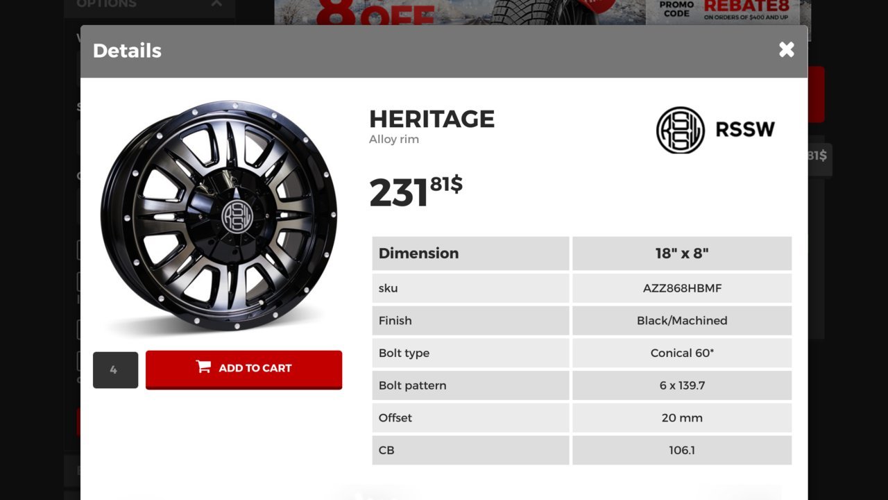

    I’d assume he’s talking about the RRW wheel above. Not too sure why he said “till they actually make a rim for the new gen”. Our truck comes with the most common bolt pattern on the road! Wheels are all over the place and in almost every width and offset wanted. It’s a blessing and a curse to have so many choices.

    They are the 7’s and -12 offset and 17’s
    I said till they make one for the new gen as in RRW. I know there are plenty of brands that make a “rim for the new gen” but im referring to RRW specifically. I really like the style of the 7 and having it be a hybrid beadlock is a huge plus. Most people would not want a -12 or -24 offset wheel (that’s what they currently make). These rims are technically for the Tacoma but since the new tundra has the same bolt pattern and can fit 17’s these will/should fit. But I’d personally like to see a 18 with 0 offset or other variety to meet peoples needs.

    I get it and it makes sense, Toyota has never required a lot offset to move out. I understand some wheels won’t have the offset you’re looking for as well. The cool thing is all wheels are only made by a couple of manufacturing companies. Which means most wheels are the exact same except subtle differences for copy right stuff. Take a look at the Black Rhino Sandstorm. It’s made in a 17x8 +30 and +10.
