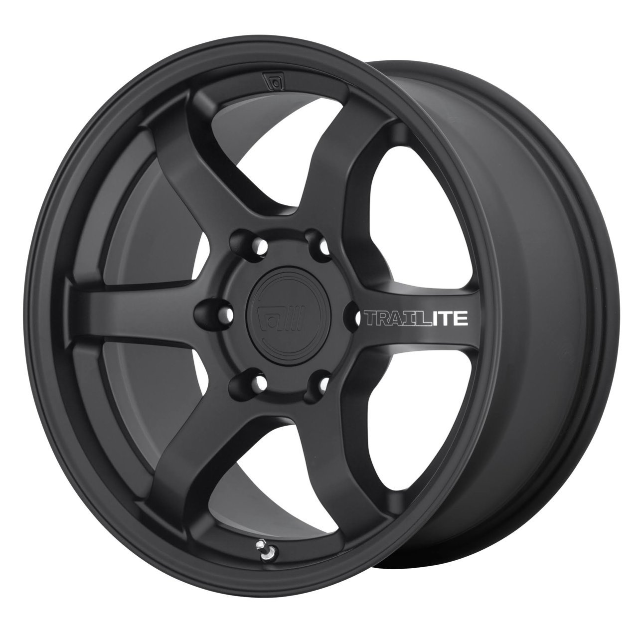

    Ordered 5 of these today, still waiting on my allocation though…
