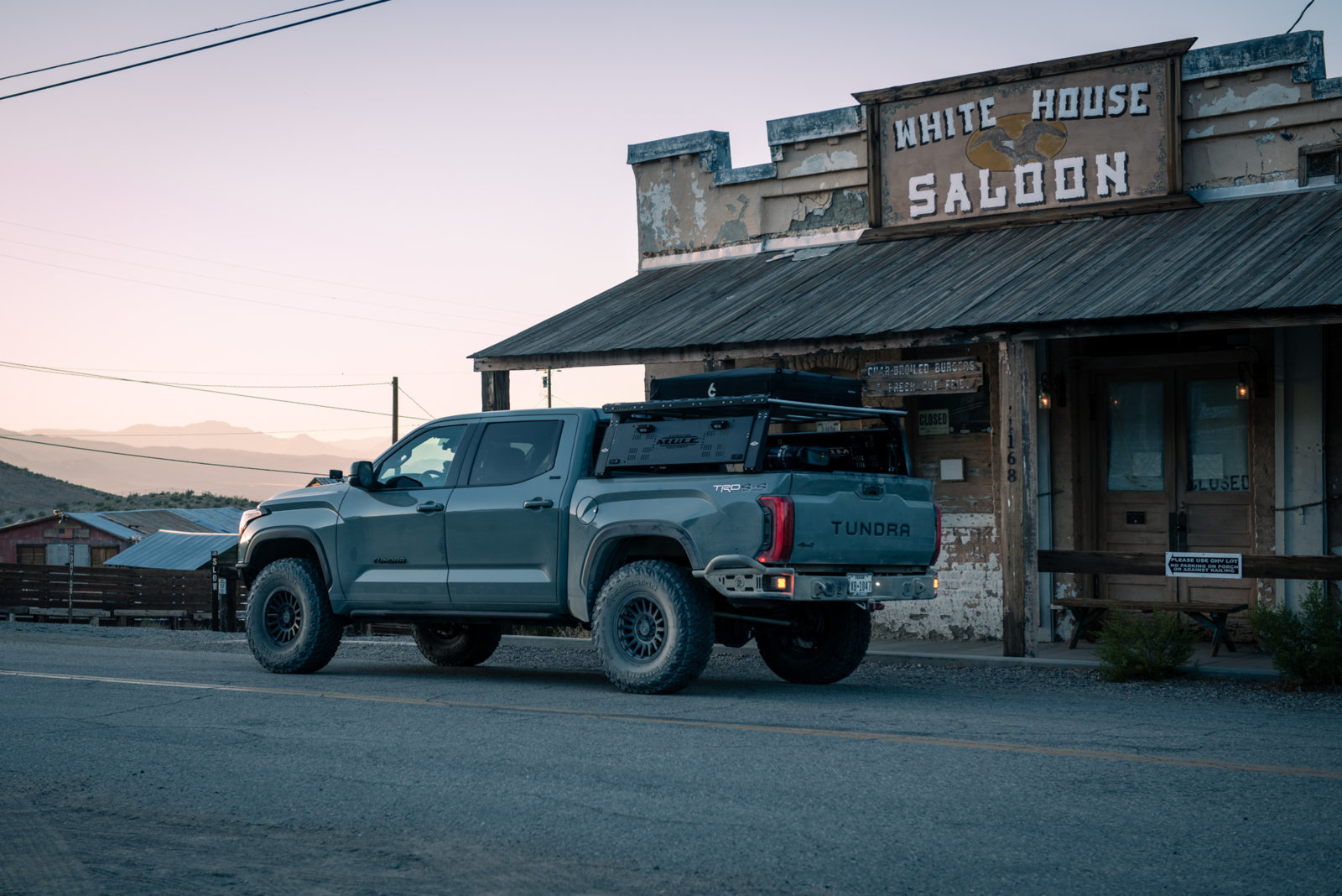

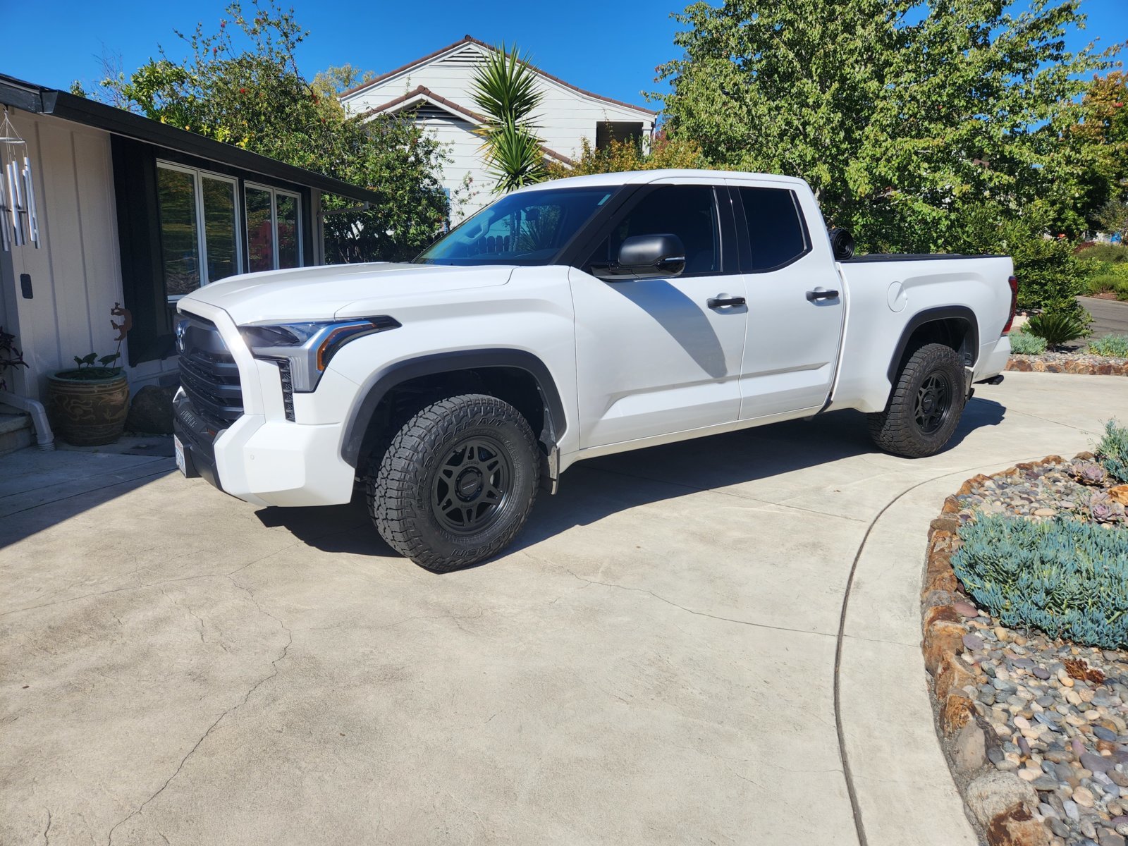

    I just mounted Method 706's 17" +35 with 285x70 and I really like the look. It just pokes out a little bit. My only regret is I should have gone for the bronze color.
    4mm likes this.

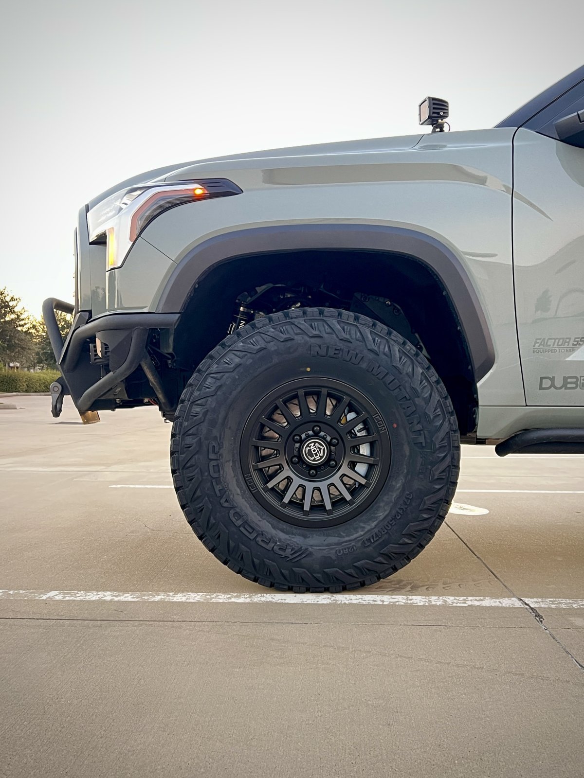

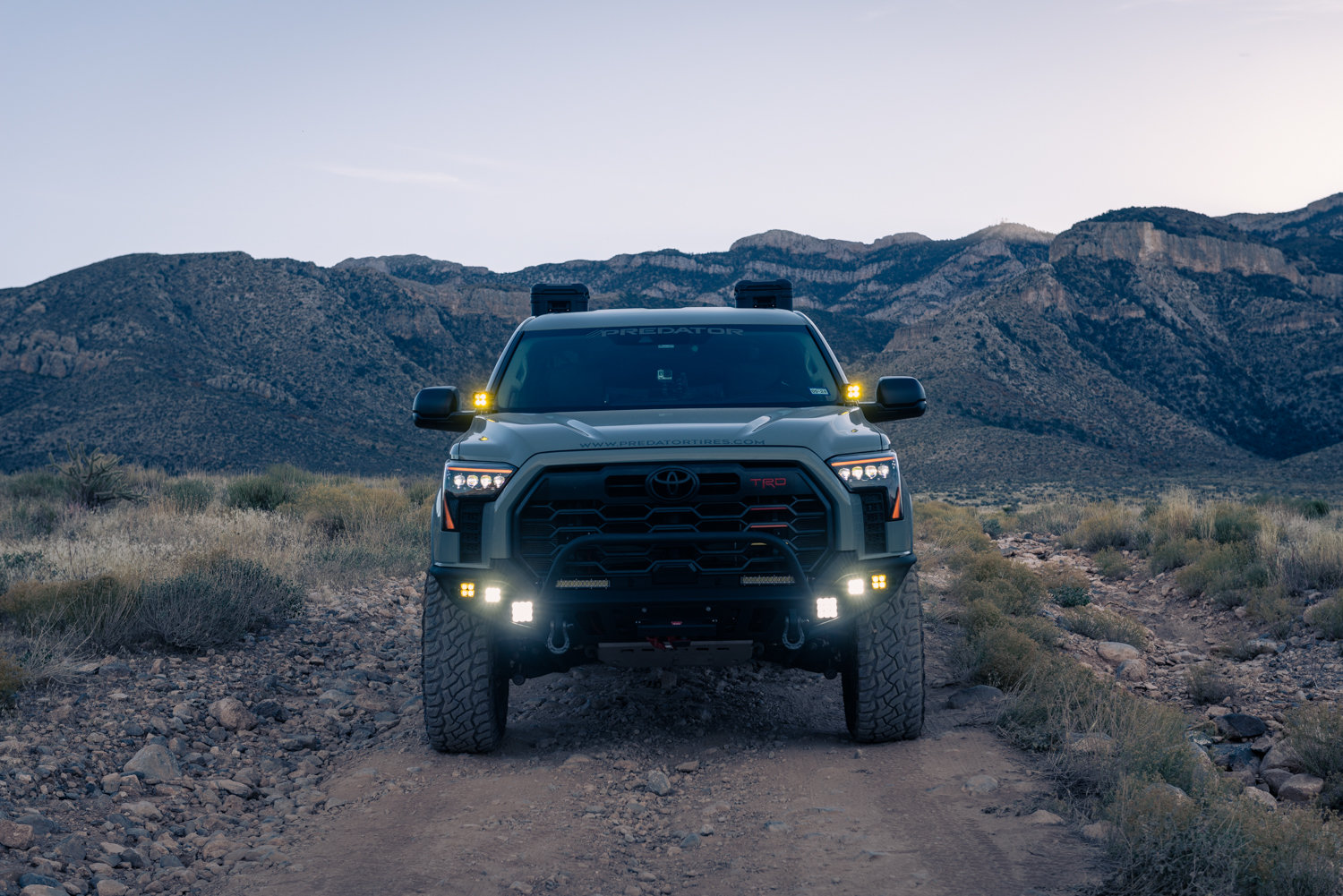

    ICON Recon 17X8.5 +25 offset wrapped in 37X12.50R17 tires. Pokes roughly about 1/2-inch.
    mve and ARCOVT23 like this.

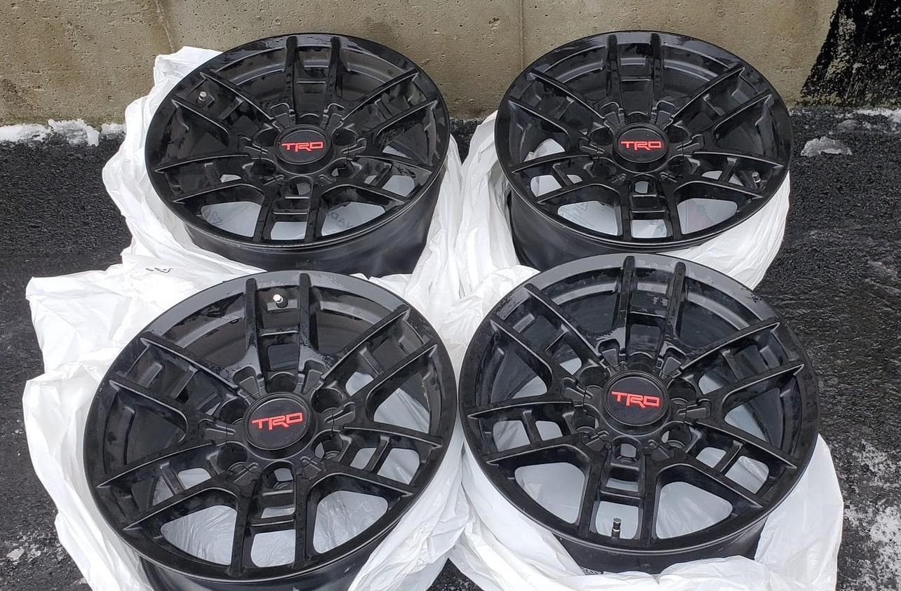

    Has anyone tried wheels off a Tacoma like these TRD ones? I know they are the same bolt pattern and are 17 inches. New truck on the way so want some new rims and tires.

    2020 Taco pro OEM wheels are 16” and will not fit.
    Actually all 15-23 Tacoma TRD pro OEM wheels are 16”.

    They aren’t the taco pro ones. They are actually 17inches. I know the job bore size is a little larger

    Oh I see. Hard to tell replicas these days.

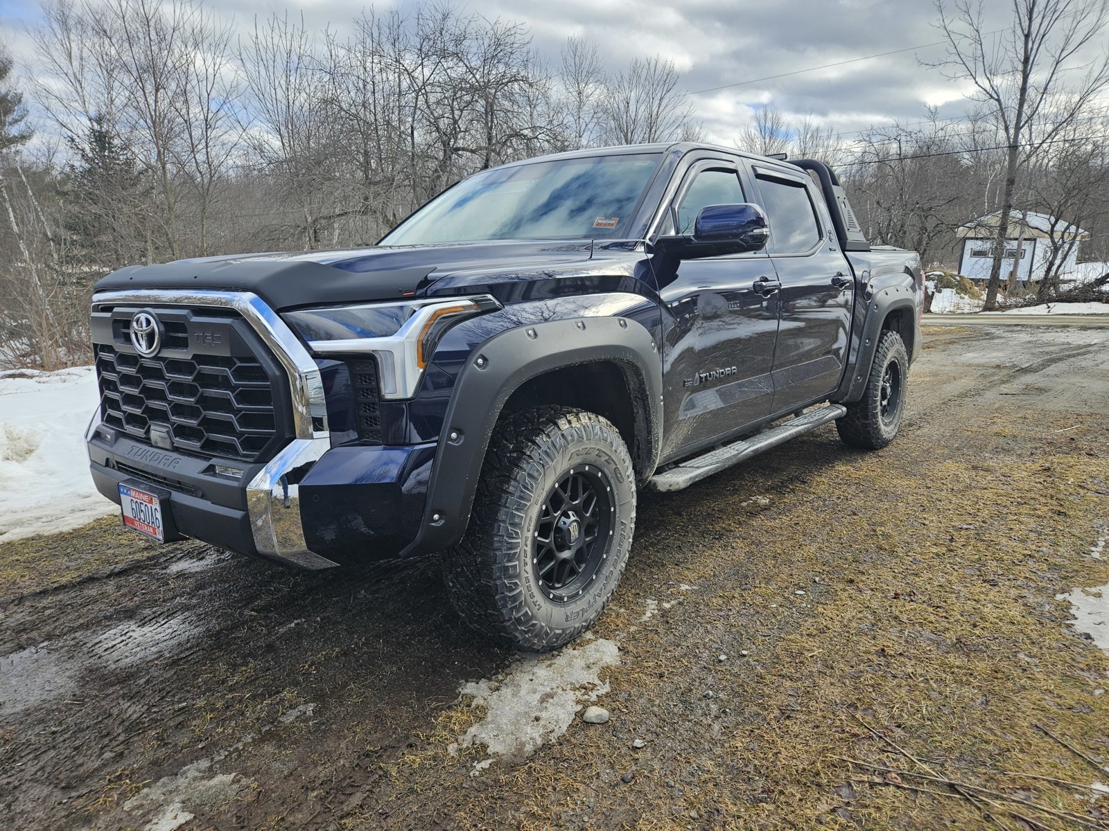

    I just ordered 265/70R18 Wranglers on DX4 rims with -12 offset. I have aftermarket EGR flares that stick out about 3 inches and 1.75 inch leveling. If the stock rims are +60 then I'll be getting about 72mm of change - that's about 2.8 inches. Am I getting this right? Is -12 offset ok?

    Cancelled that order. -12 offset would stick out too far for my taste.
    Instead I'm getting XD Grenade 18×9 +18 offset and 285/75R18 Nitto Ridge Grapplers.Will post pics after I get them.

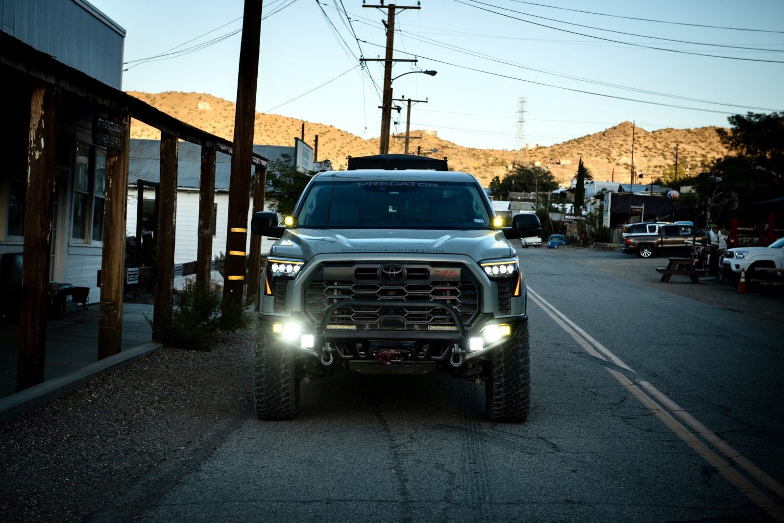

    Just had the new tires and rims put on. 285/75R18 Nitto Ridge Grapplers on XD Rims with +18 offset.

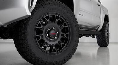

    Anyone know if the new 2024 Tacoma TRD Wheels (PTR56-35242-F1) will fit the 3rd gen Tundra? I know almost nothing about wheels so was wondering if they would fit and if I would get any poke/rubbing with 295/70/18 tires? I was thinking of getting the Tundra Pro wheels but having a hard time justifying $900 per wheel, plus I kinda like the look of these.

    I’m sure it would work. I have these low cost wheels on our LC.
    ABlackBird[QUOTED] likes this.
