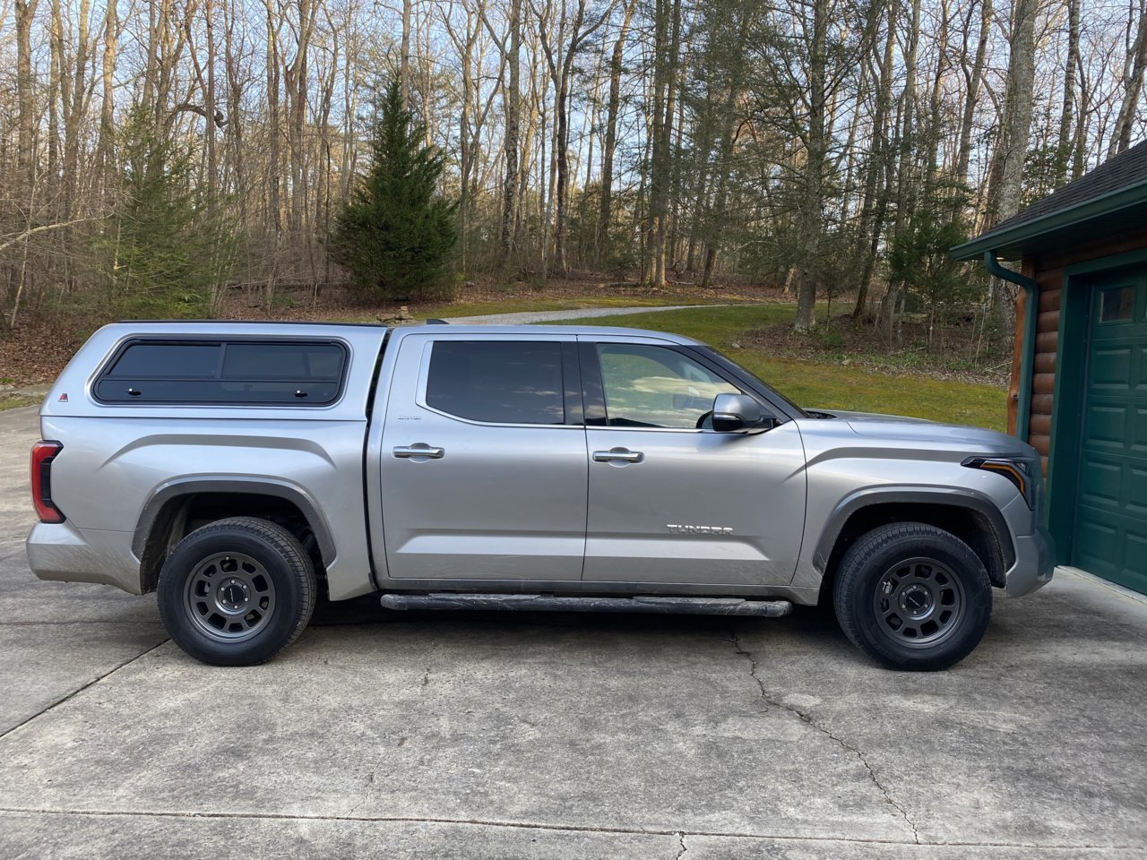

    pawner
    pawner New Member
    Jan 23, 2022
    #73570
    51
    Chattanooga, TN

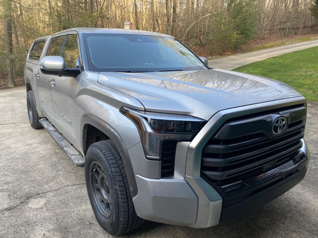

    2022 Tundra Limited with Leer 100XR
    Contrary to most popular setups on here, I got aftermarket rims but stock tire size to keep the plush ride quality, not lose any power, and not have to recalibrate speedo.
    Method 705s 18x9 with 18mm offset.
    Michelin Defender m/t 275/65/R18. Stock is 265/70/R18 but discount tire messed up the order by 1 size. I decided to keep since it's nearly identical in sidewall height, and 275s have just a tiny bit more grip.
    Significantly better ride quality than the stock 20s I have to say.
    Lastly, I ordered some custom metal decals from etsy that say "TOYOTA" to cover up the MR center caps in an attempt to keep the OEM look. Not sure how it will turn out though

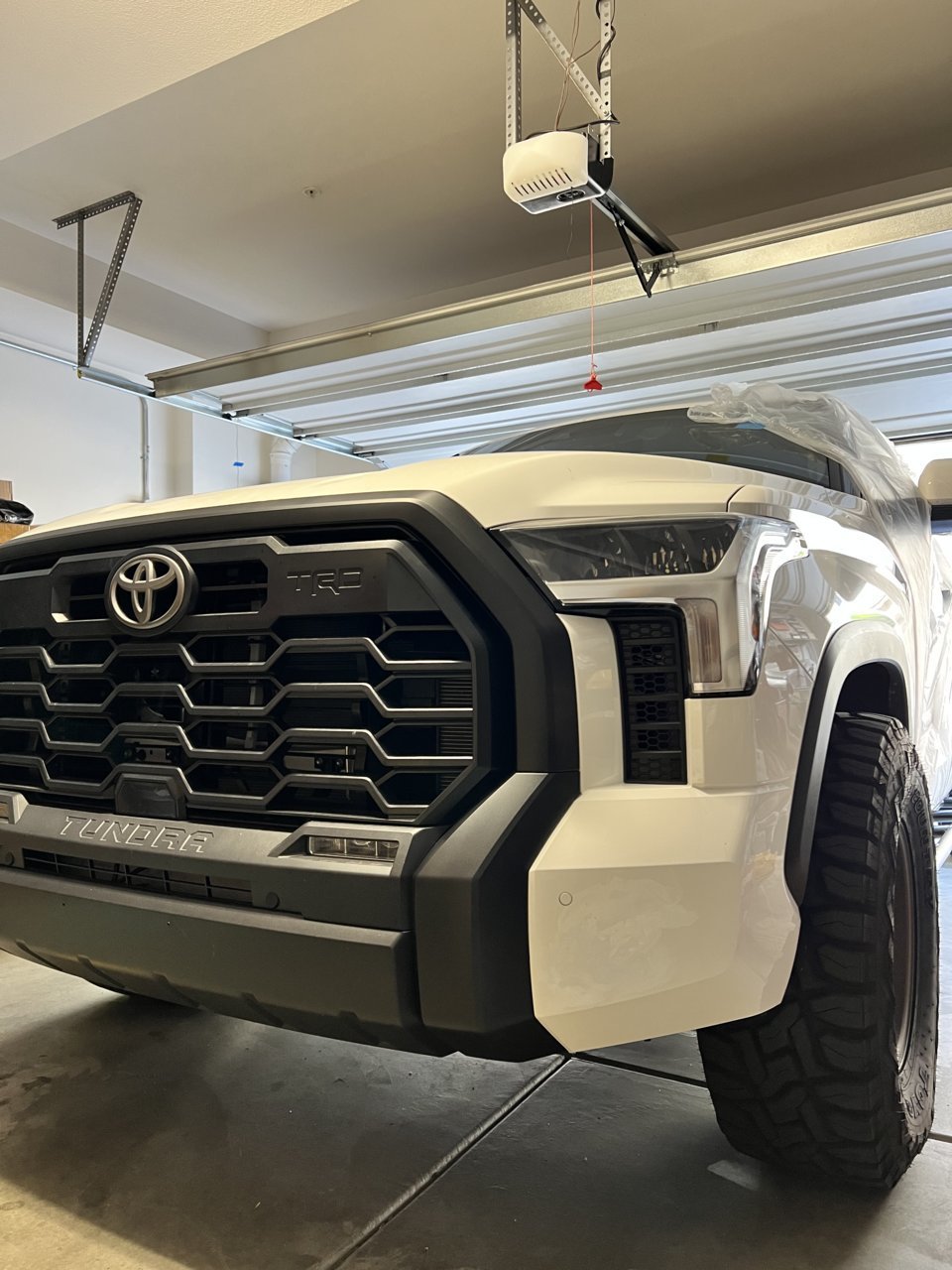

    Here is pics of my truck. It has a Ready Lift of 3"/1.25 with 33×12.50×20 on 20x9 +1 Offset Fuel Rims D744 I believe.
    It was rubbing a bit in front so I had to remove the mudflaps. I'll add some fender flares or aftermarket mudflaps to help the paint on my truck.

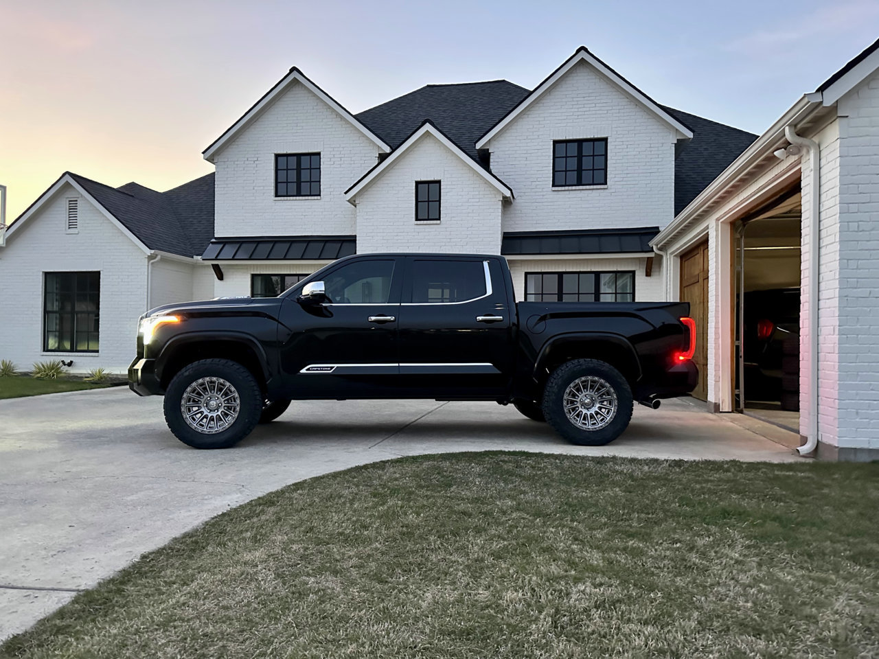

    TexAg03
    TexAg03 New Member
    Apr 4, 2023
    #94957

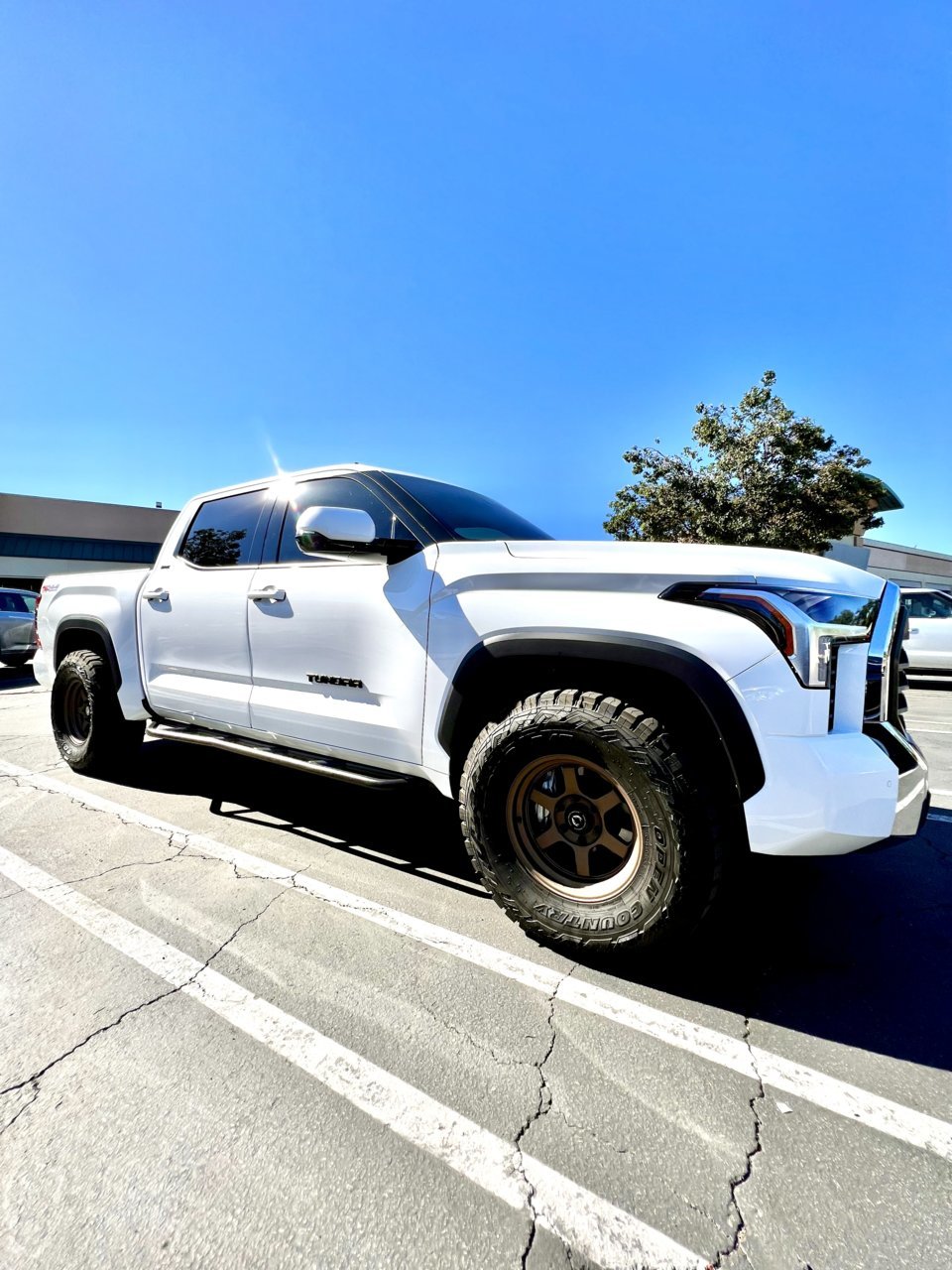

    3
    BJ
    2022 Tundra Capstone

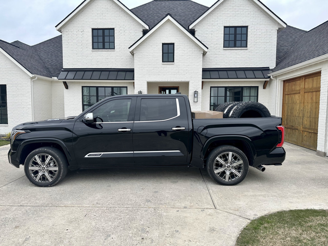

    3" Readylift SST Supsension 20x9 Platinum Fuel Cycle Wheels 315/60/20 Nitto Recon Grapplers
    I went with the 20x9 Fuel Cycle Wheels, 1mm offset. Tires are Nitto Recon Grapplers, 315/60/20. I chose this size vs the traditional 35x12.5's because they weigh 57 lbs vs. 70 lbs and are slightly larger. Lift is Readylift SST 3" lift. The rear 1.25" lift wasn't enough for me, swapped out the 1.25" for 2" rear spacers. Now rear sits .5" higher than front. No rubbing after pinning back inner fender lining.
    Before:
    After:
    Bucng8r, 2010bigdog, U Sh00k and 10 others like this.

    100% Stock
    first Capstone I see/read about that doesnt have rear air. Looks awesome!

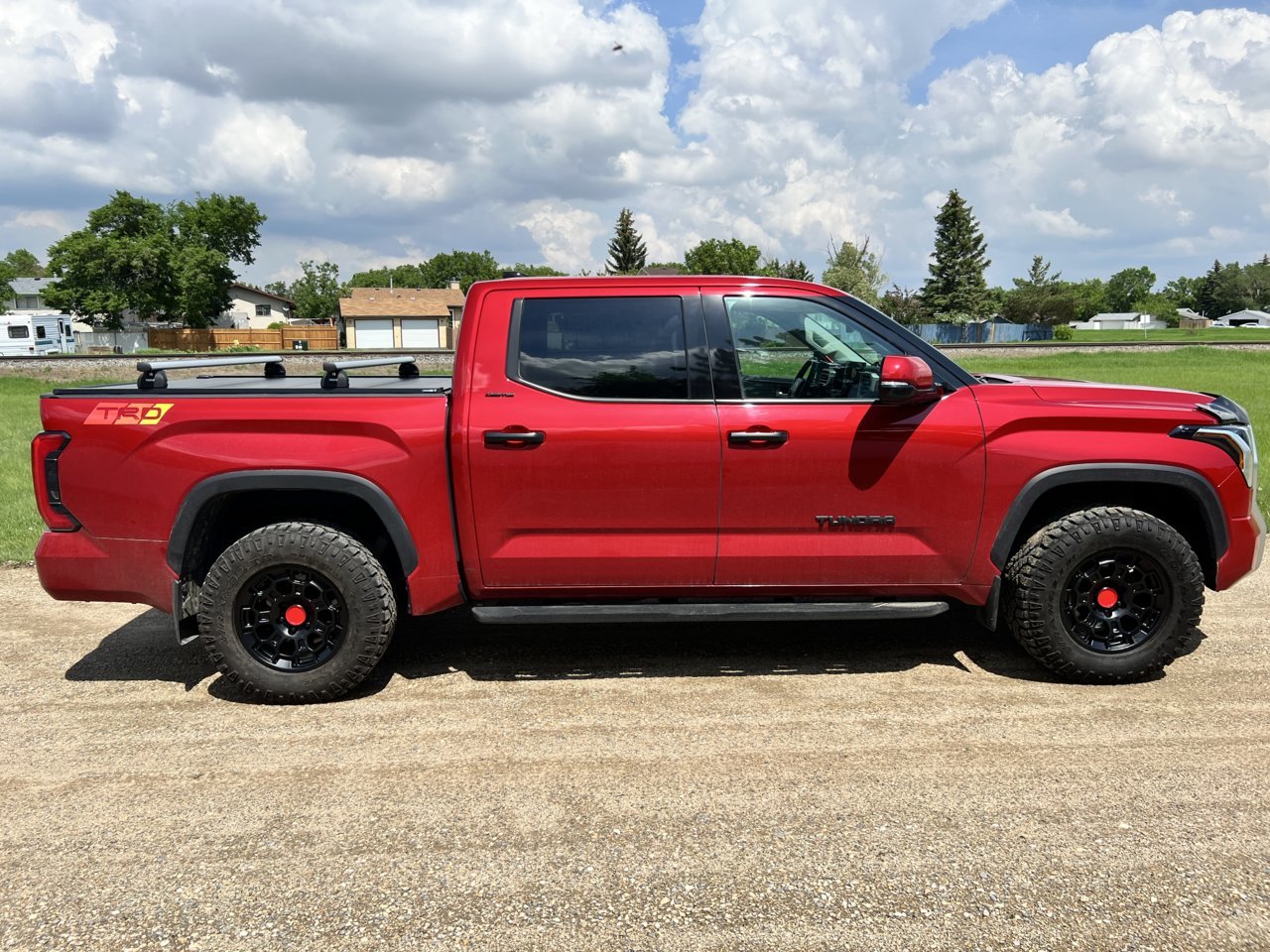

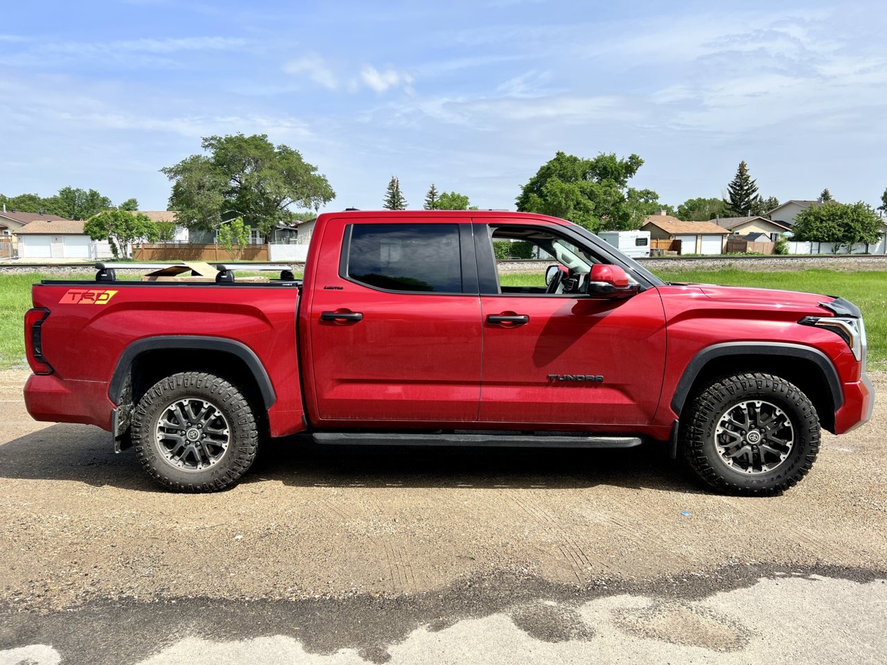

  21. Jun 10, 2023 at 4:37 AM
    #501

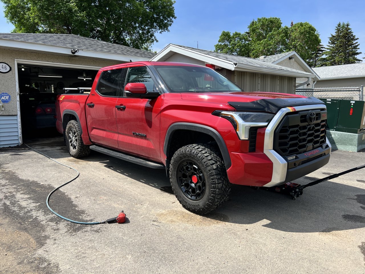

    Mrconnsmythe
    Mrconnsmythe New Member
    Jan 15, 2022
    #73194
    201
    Saskatchewan, Canada
    2025 Tundra Ltd TRD OR WCP

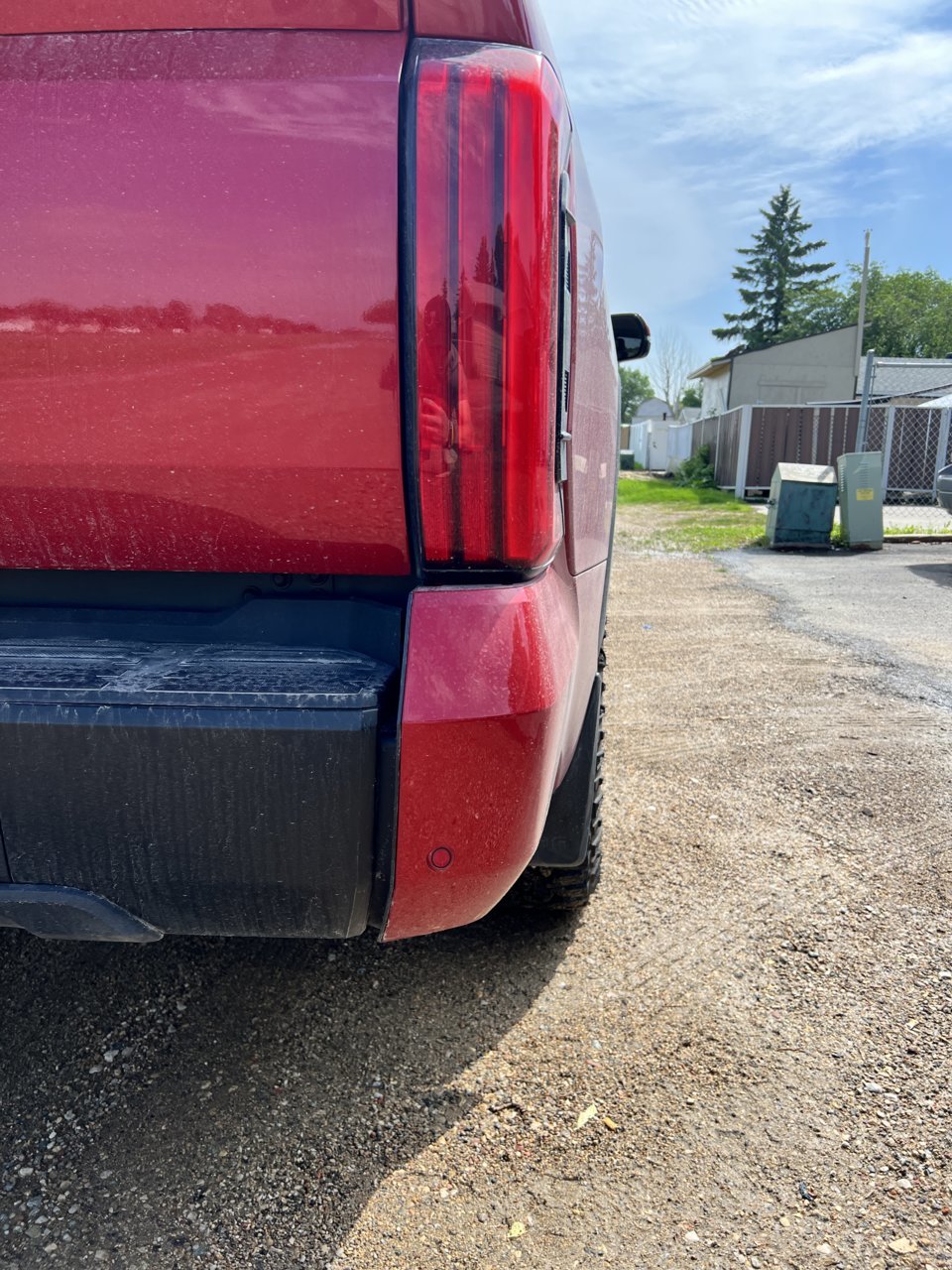

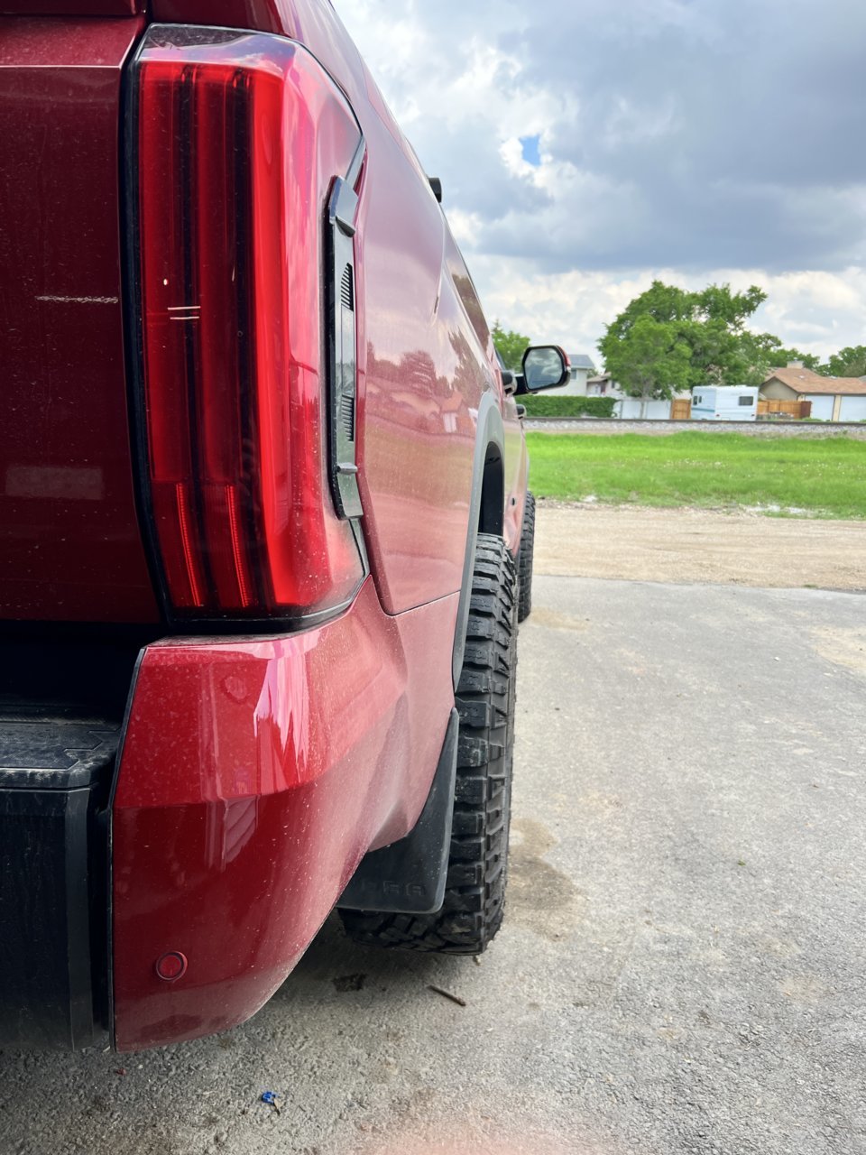

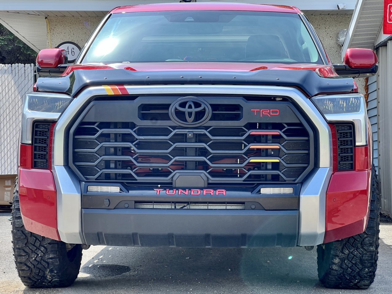

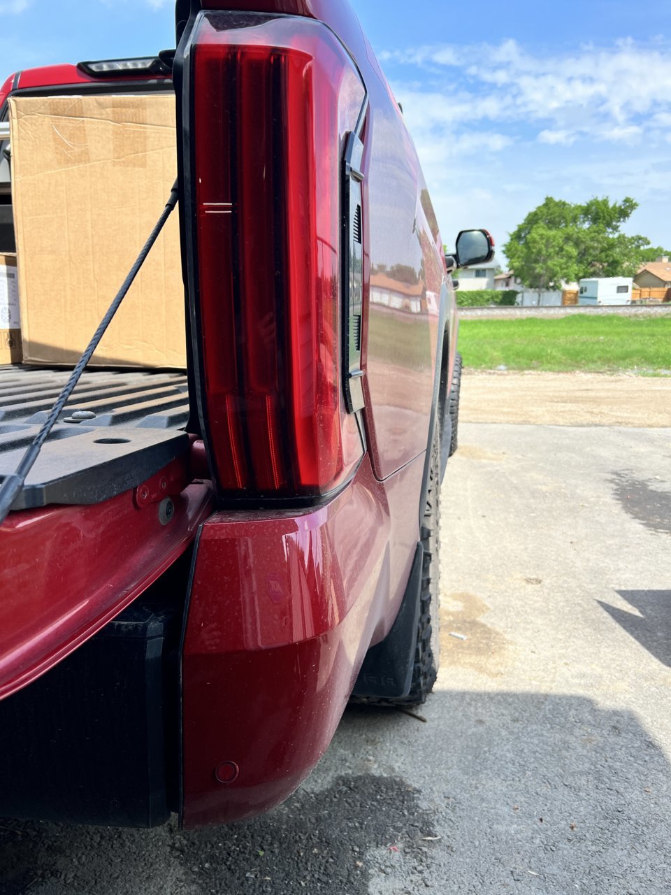

    Went from OEM +60 to +15 on some new rims. Love it waaaaaaaay more now, completely more aggressive IMO....If I had my exact number for off-set, I would probably say +20 to +25, but no off-set choice with these aftermarkets. Next up will be mud guards to protect a bit more of the paint now.
    TRD L Power and Yaboy like this.
  22. Jun 10, 2023 at 9:20 AM
    #502
    TSS Army Green
    TSS Army Green New Member
    Mar 14, 2022
    #75838
    148
    Looks more aggressive now and looks really good. Which rims are those and can you provide a link to it? What tires and size you went with?

    Where did you get the hood protector? looking
  24. Jun 10, 2023 at 2:37 PM
    #504
    Mrconnsmythe
    Jan 15, 2022
    #73194
    201
    Rims are from OEPLUS (https://www.oepwheels.com/)
    Tires are 295/65R18

    I keep seeing the red/orange/yellow inserts on the grille, but cannot locate them. Link? Good looking rig by the way

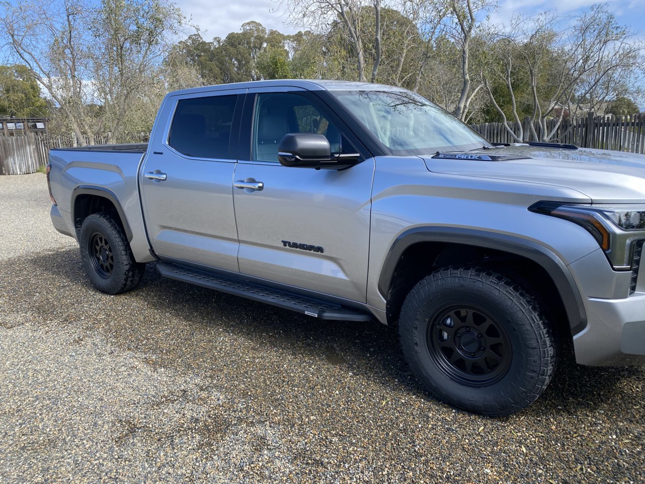

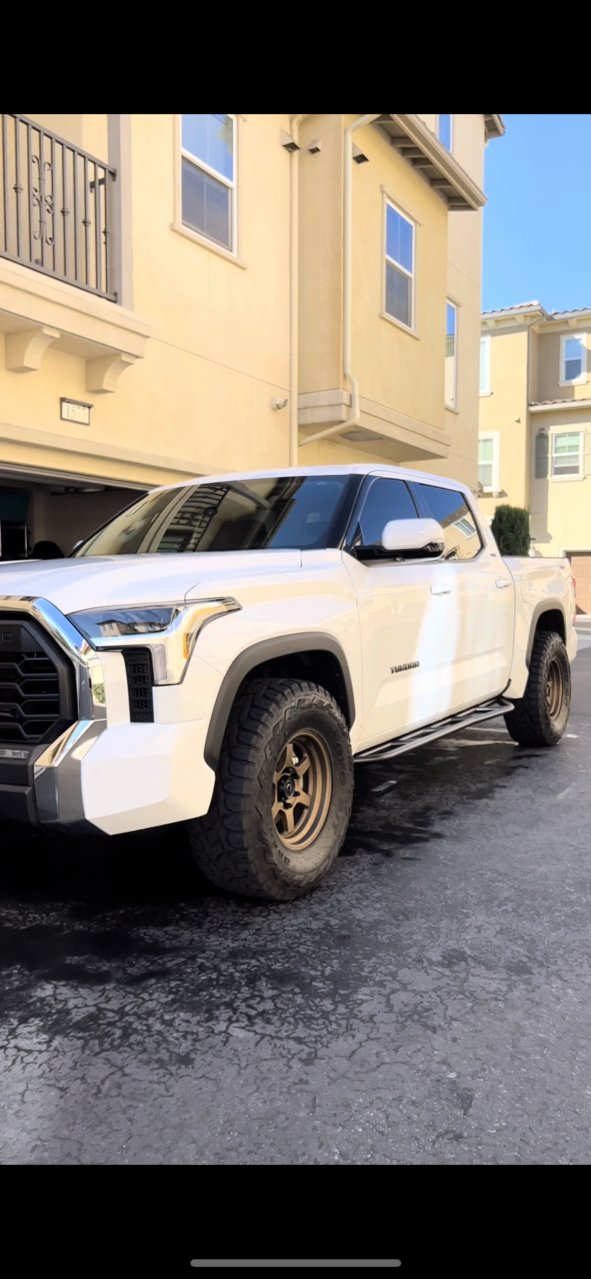

    SoCal
    2022 sr5 trd 4x4
    Running 17s love them
    Blackhorn bh-01 17x9 +12
