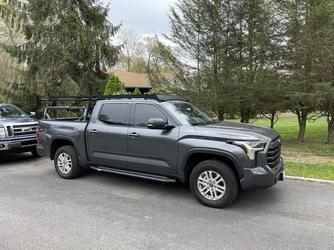

    Finally got these mounted after fedex lost not one, but two separate packages (original order and then replacements). 17x8 +5 trd pro sema replicas. 305/70r17 cooper at3 xlt
    D2945710-BCB5-4D7B-9FD3-A546EDEB1CEC.jpg 72CD78B9-2F67-4E12-B01A-67A4350FB578.jpg 4CFDC025-8B1A-447C-B951-F0D0AF9EA7C3.jpg
    still waiting on my procomp coils and some other odds and ends. Happy with the look and performance so far.

    Is that the slimline GoRhinos (4” wide) or the Regular width ones ?

    slimline rb20’s. I prefer no running boards but the wife is only 5’3” lol and my 6 yr old needs a running start to get in even at stock height. Welding up some custom brackets though as the go rhino ones drop down too much imo.

    rear platform is prinsu as well. The Yakima overhaul Is not technically a 22 setup, I had bought the rack with intention of Installing on a retraxone, but it took forever to get the tonneau. I ended up removing the side deck rail systems and installing it with the clamps. I have the tonneau now, but Yakima has nothing in stock currently and I can’t get the tonneau mounting kit. Side bars took me months to get. Also have been waiting for smaller 60”
    Cross bars.
    I’ll be happy with the setup when I have everything in hand. During ski season I put on low crossbars to transport skis. The tslots on the retrax makes that easy.
