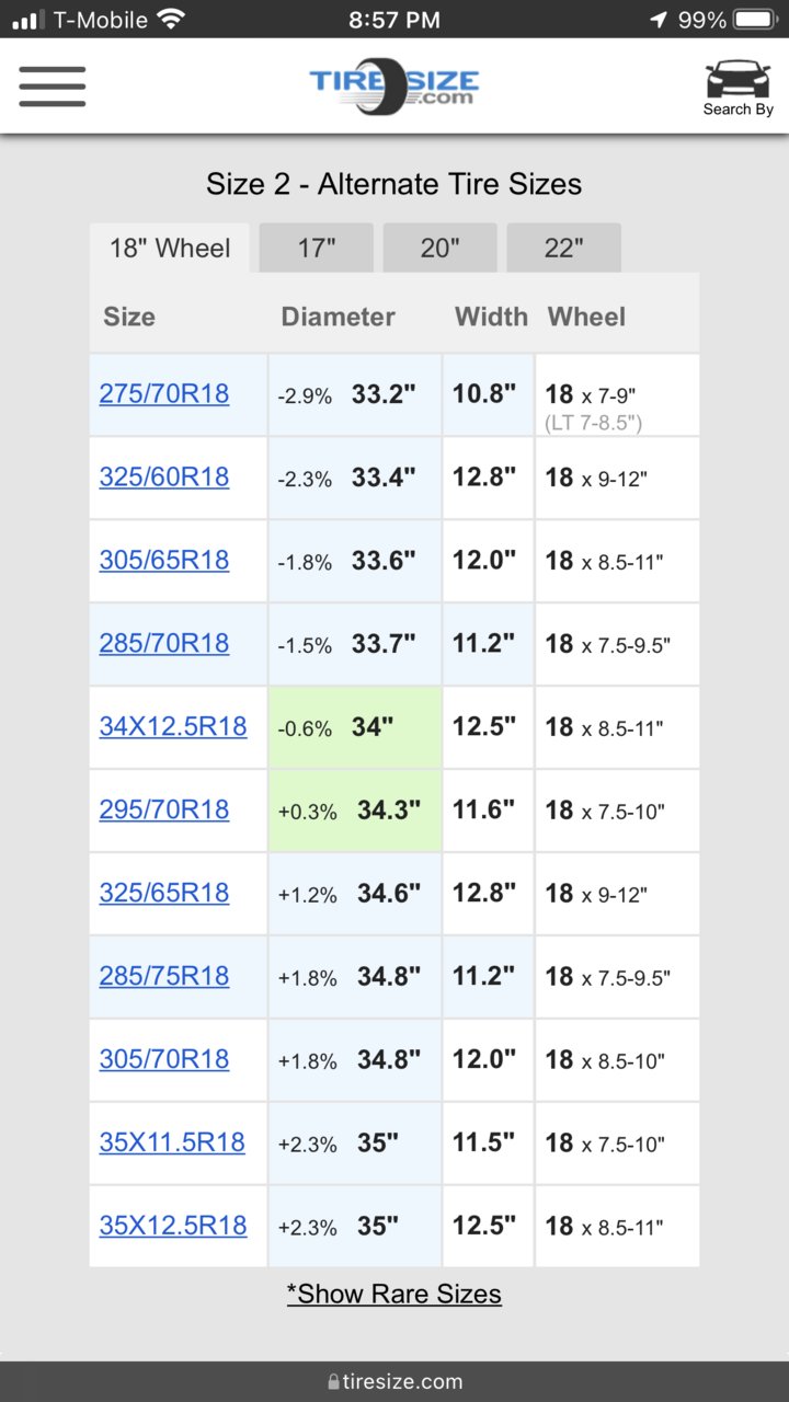

    I couldn’t find any 275/75/18 tires (may be a unicorn) but did find some similar size 34-ish sizes if that’s what you are looking for (see the 3 tires left of the green area below from 285 to 295).
    Wheel width itself is less of an issue between 7-9 though I would probably stick with at least 7.5 or 8 at the minimum to give yourself tire options in the future.
    That website by the way (tiresize.com) is your friend so go in there and experiment a bit :thumbsup:
    A size that fits with the stock rim/suspension is 295/70/18s and options are a plenty so that would be my pick for that size you want (I run them myself on stockers (see below))
    They are a hair under flush and if I were a spacer kinda guy and liked the stock rim I would just do a 1/4” spacer and call it a day.
    I can’t comment on Tundra specific aftermarket wheels with better offsets however…maybe someone else can help out there.
    Otherwise it’s a friendly bunch on here with great info (I learn something new everyday) so don’t be afraid to search and/or ask.

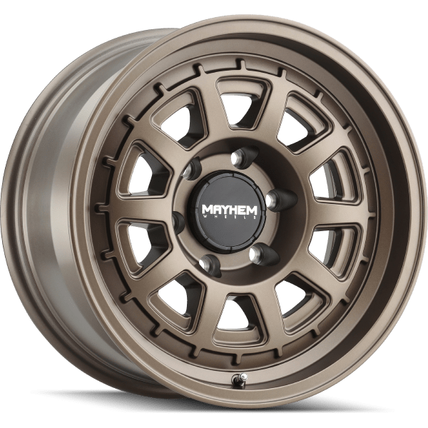

    Found a set of dark bronze Mayhem rims i was interested in, they only come in a ZERO offset. If i run these with the 295/70/18 are they going to stick out a lot ? Don't mind a little poke but not looking to get too aggressive...anybody running this setup?

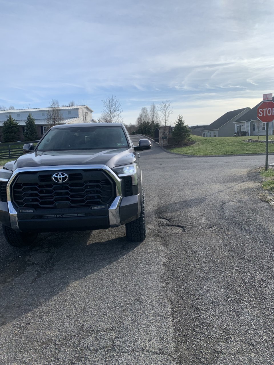

    85B1FE1A-F5A1-4F0A-AF45-969A27C48BF2.jpg 98573C23-3FFF-4E81-A127-5B7B7601C952.jpg
    Here’s the same wheel and tire set up as you with a +20 offset so figure you’ll stick out 3/4 of an inch more on each side than this

    Oh...ya I think that might be a little more than I hoped for. I like the rims, maybe I can try to split the difference and go with a 285

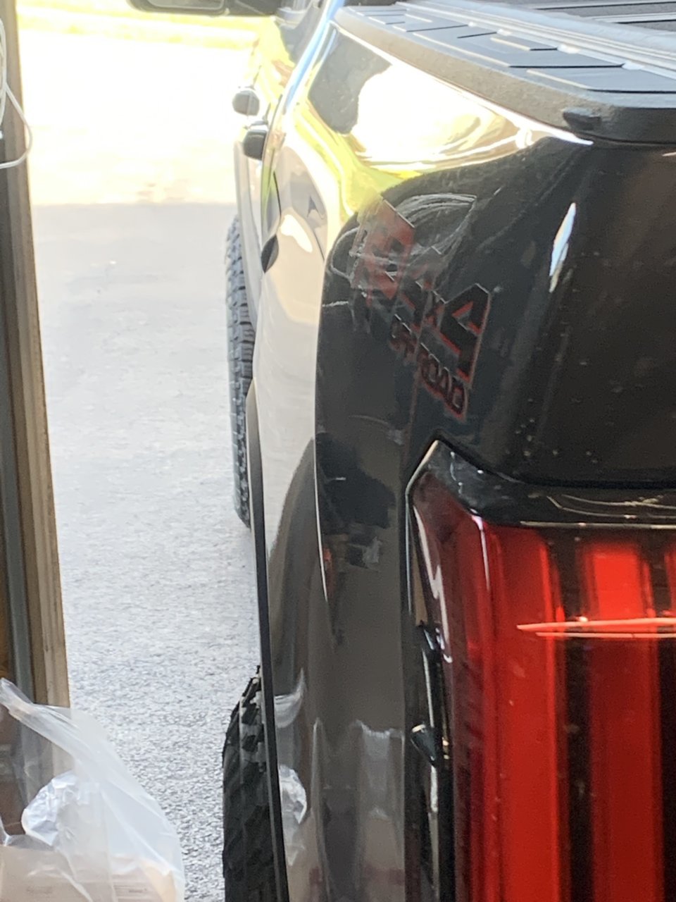

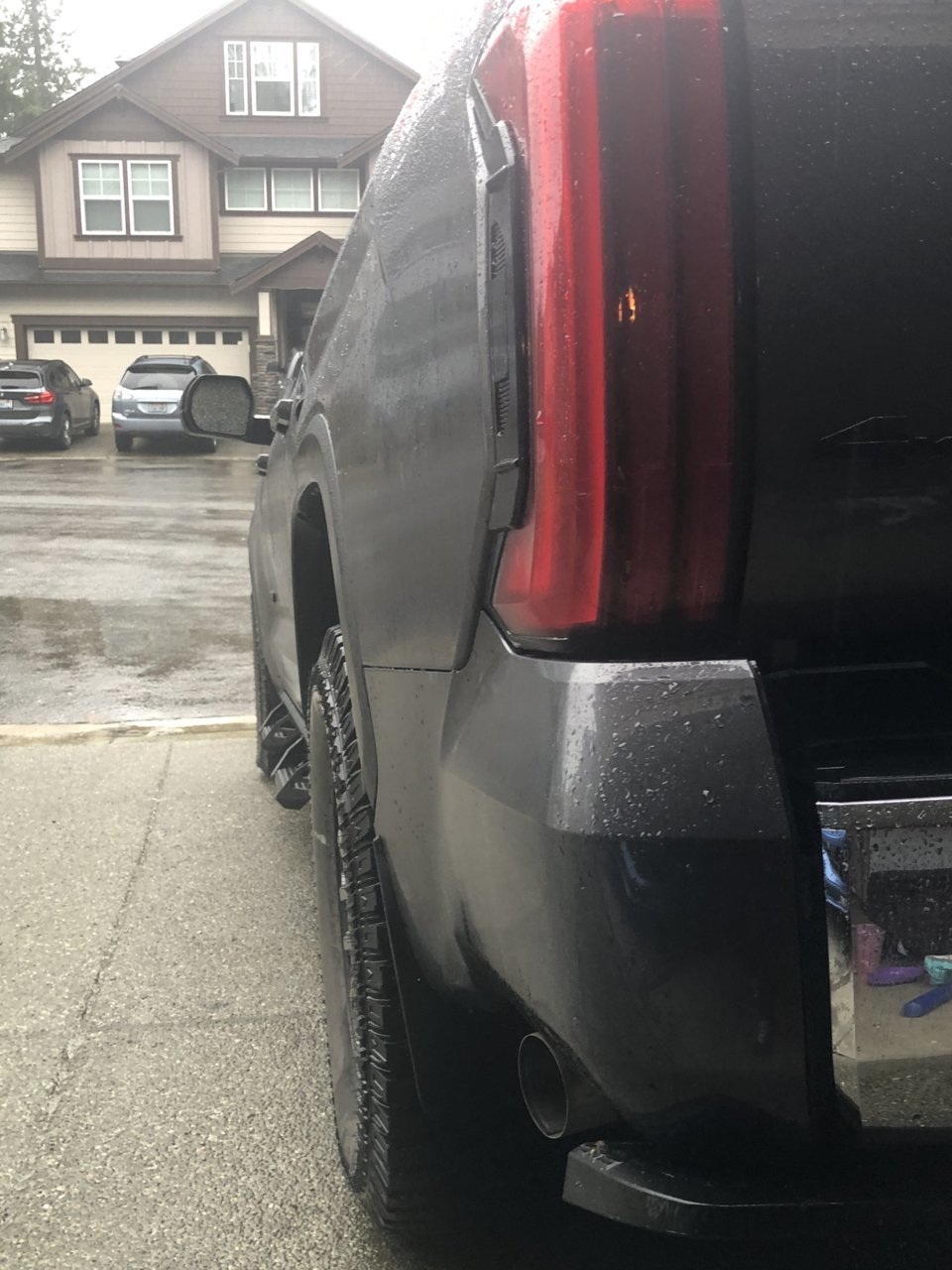

    Its the offset of rims/wheel of itself that determines how much poke you get. The lower the number -10, 0, etc…the more it sticks out.
    Going down from a 295 width tire to a 285 will buy you about .3” in tire width but it still mounts on those 18X8.5 or 18x9 wheels so you won’t see much of a difference.
    Beloiw is what 0 offset looks like. These tires are ~1/2” wider on each side but that’s barely noticeable as the poke was determined by the wheel offset

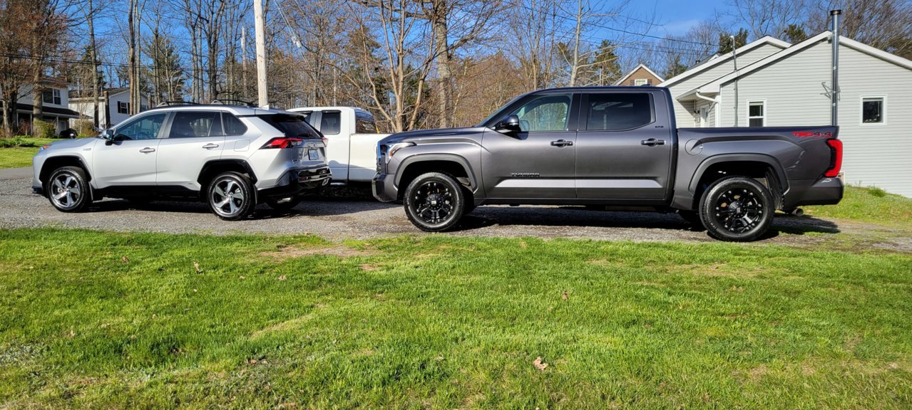

    Got lucky with my old wheels from my f150 being dual bolt pattern and fitting on my new Tundra:
    XD 778 Monster
    20x9
    18mm offset
    Tires nearly worn out Michelin LTX AT/2
    Will hold me over til' SCS Ray10s come in 18" 6 bolt!
