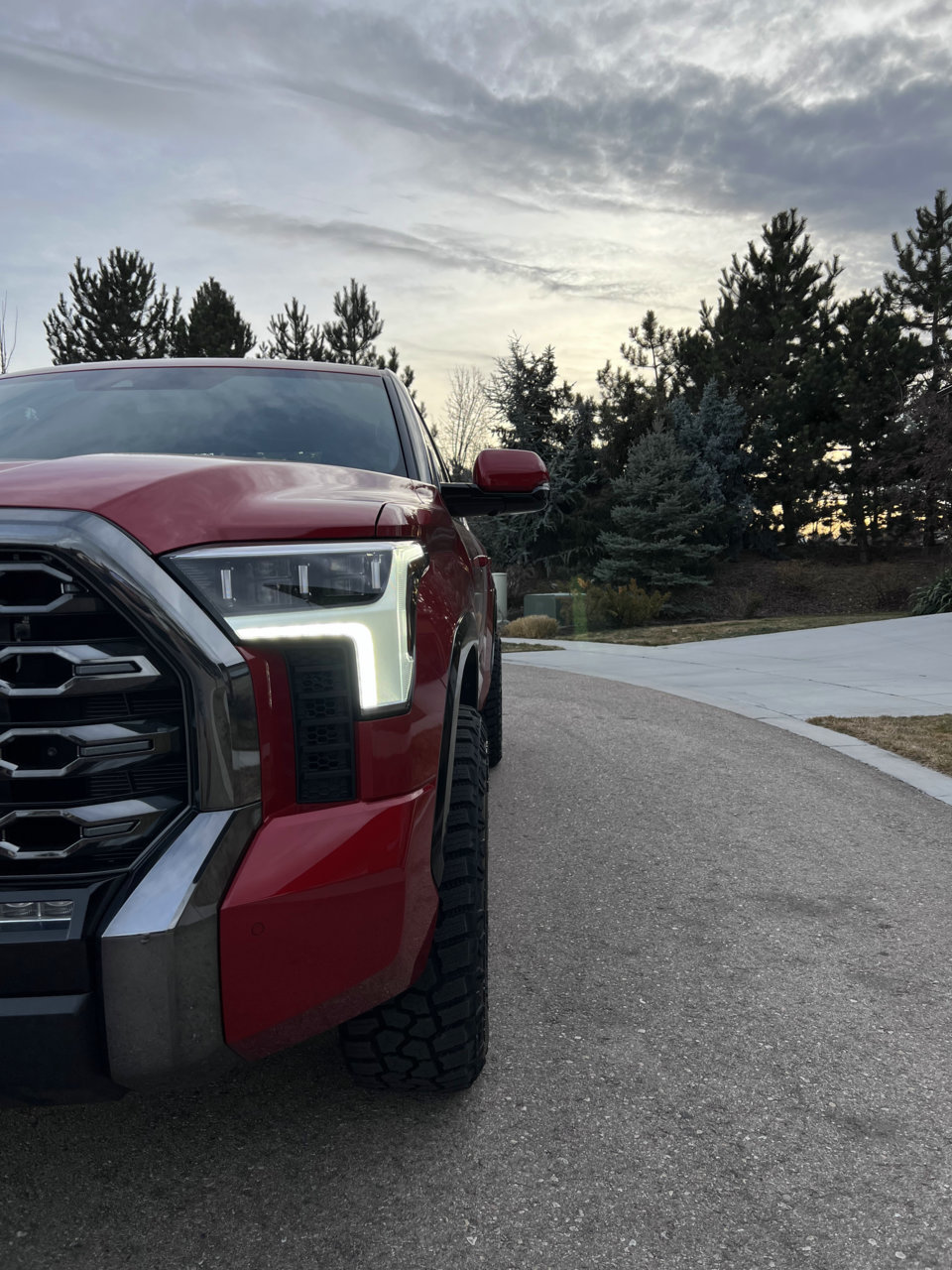

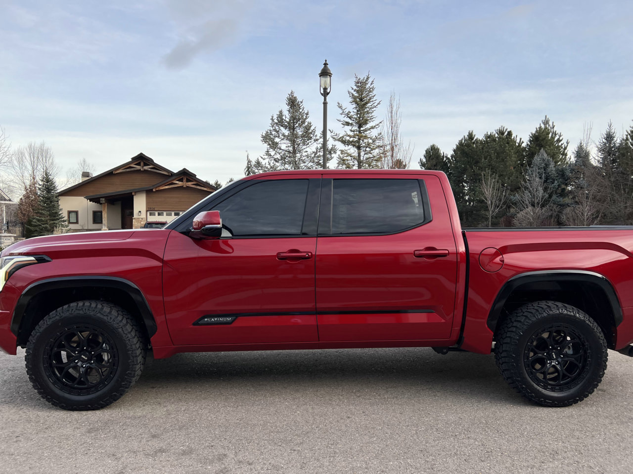

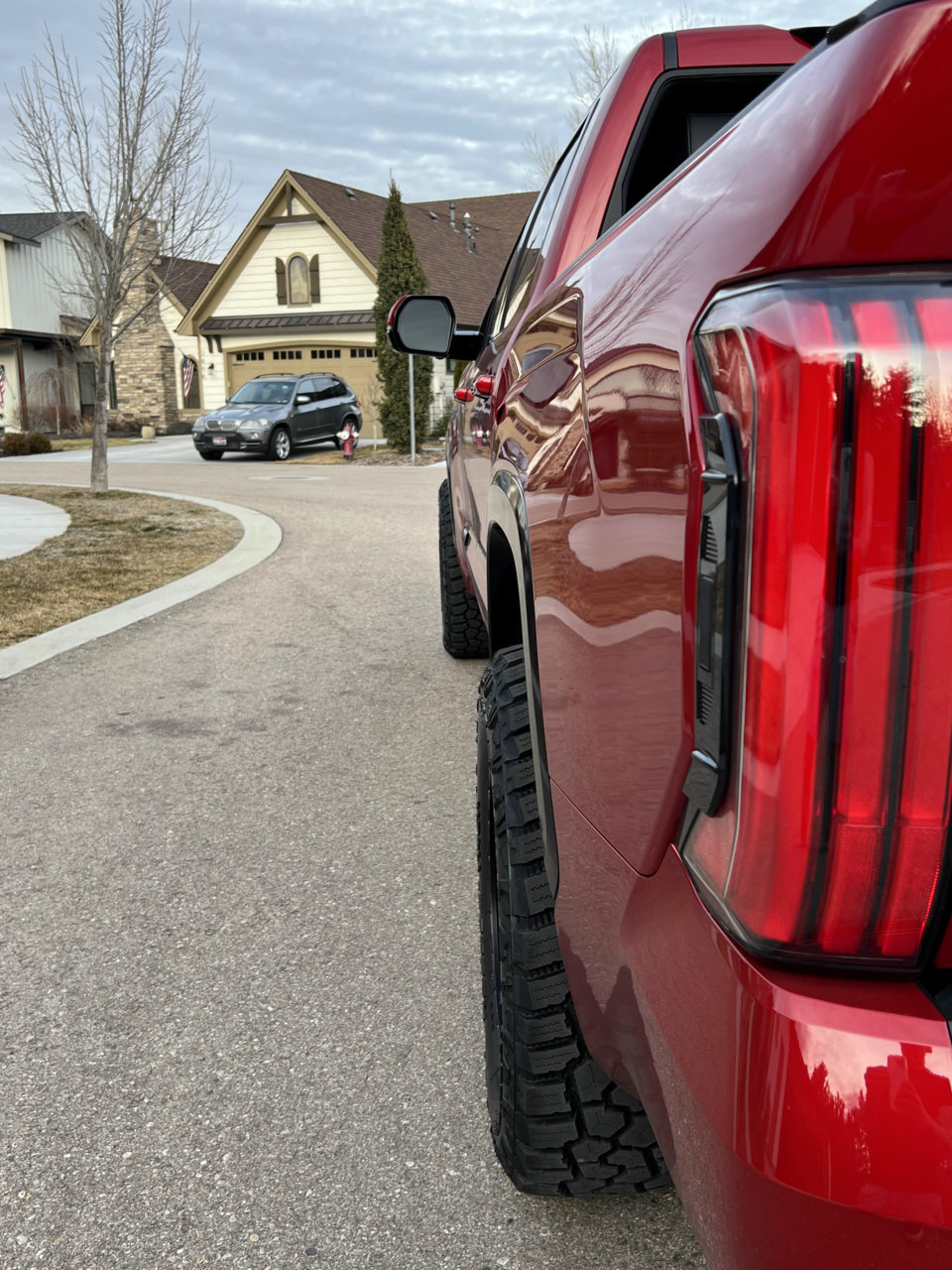

  22. Feb 23, 2022 at 8:55 PM
    #352
    hairychestedfrog
    hairychestedfrog New Member
    Dec 21, 2021
    #72095
    111
    Idaho
    22 Tundra SS Red Plt CM
    This is mine, 20x9 +20, I think +1 would be aggressive.

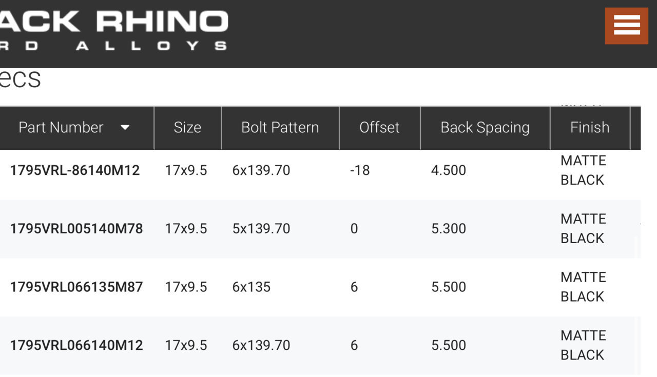

    But I also found another wheel that I am also looking into from RTX:
    Looks like the RTX are spot on but without websites updated for configuring to the new Tundras, I am trying to make sure they fit before ordering anything.
  28. Feb 25, 2022 at 1:11 PM
    #358
    Rwaters
    Rwaters New Member
    Jan 4, 2022
    #72634
    563
    2022 Tundra TRD SR5 Crewmax
    The RTX would definitely be the way to go over the Black Rhino you chose, in my opinion. The BR part number you posted has a 4.5” backspacing, which is aggressive. It’ll stick out for sure #savethepaint
    Mrconnsmythe[QUOTED] likes this.

  30. Feb 25, 2022 at 8:43 PM
    #360
    bigjuice
    bigjuice Spring hath arrived…
    Dec 8, 2021
    #71582
    1,141
    WA State
    2024 Terra TRD Pro
    I think they have 2 Black Rhinos with a very similar part # (one with the -18 offset (4.5 backspace) and another with a 6 offset (5.5 backspace)…the one he pointed to actually is the 6 offset which is still aggressive but there are guys here running 0 offset so you might take a look and see if that similar look suits you.
    You definitely do not want to go with that -18 however :eek2: (in my humble opinion)
    I second the motion of going for the RTX also (smoother looking wheel though I can’t tell how heavy they are)
    …it still has an aggressive offset of 10 (assuming you are going for the 18’s ) but that’s a little less poke than the 6 offset Rhinos and awhole lot less than -18
