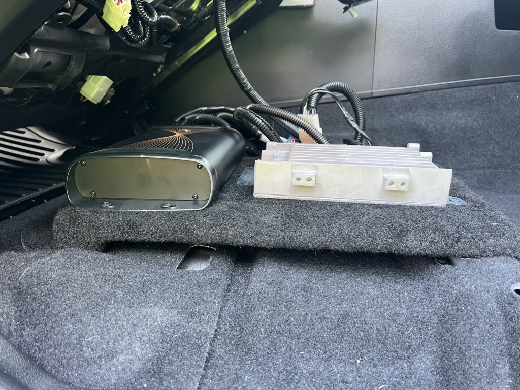

    #42331

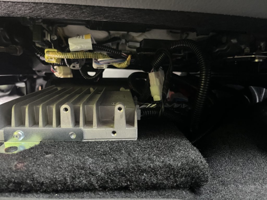

    In the current version of the Tech12Volts setup, the factory amp remains and the new amp is after it? No DSR-1 required?

    Partially correct. Yes the Factory Amp does remain and no additional DSP is needed since the new amp has one built in.
    Keep in mind that 2 of the 3 oem connectors are plugged into the new amp. 1 of the 3 oem connectors is plugged into the factory amp. There are 2 connectors that go from the new amp to the factory amp. So technically, I believe the new amp is now installed before the signal gets to the Factory amp.
    Also, I cant believe I waited this long to get this amp! I am very impressed how this little amp brings the factory system (along with the upgraded Sub / Enclosure) to life.

    Thank you for the explanation. Makes sense now. Definitely giving myself analysis paralysis with all these options and info.

    Yes that's looking like the right move. I'm just trying to understand the function. So in that setup, the 8 channels are 2 dash and 4 doors, and then 7/8 are bridged for the sub(s)?

    I don't think 7/8 are bridged, but what ever he does powers the sub very well.

    Channels 7 & 8 are separate. One goes to the sub and the other goes to the center dash speaker. I don't think the center dash speaker does much, so bridging it for the sub may make sense if it can be done.

    Tinted windows, go rhino D6 side steps and shorty antenna, Bilstein 5100's rears, 6112's fonts set to 2.5" Rocktrix RT111 18x9 -12offset NItto Terra Grapplers G3's 275/70 R18's. Amp from James @ Tech12volts FRAC Harness
    The wiring looms really cleaned up wiring, looks great

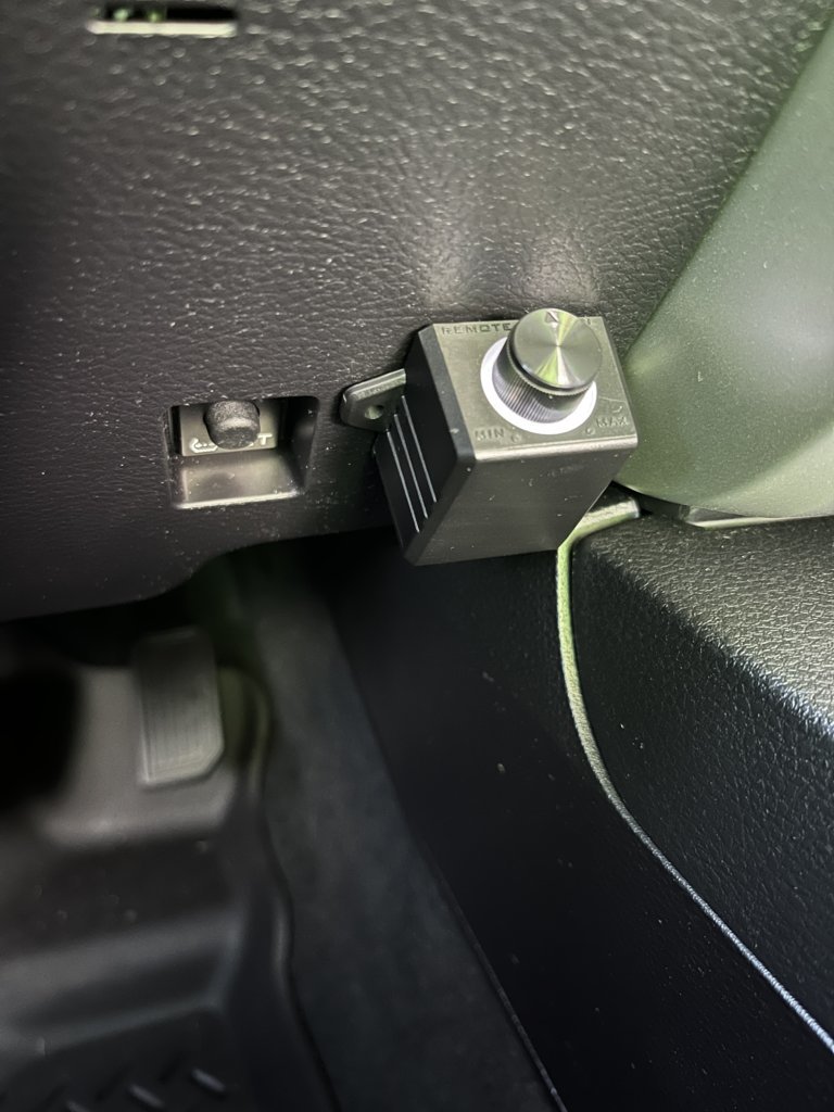

    Just plug and play for me. Most of my listening is XM, I adjust the base knob as needed when changing from one genre of music to another. I am happy with the results. Install was easier than expected ! When does that ever happen ?
