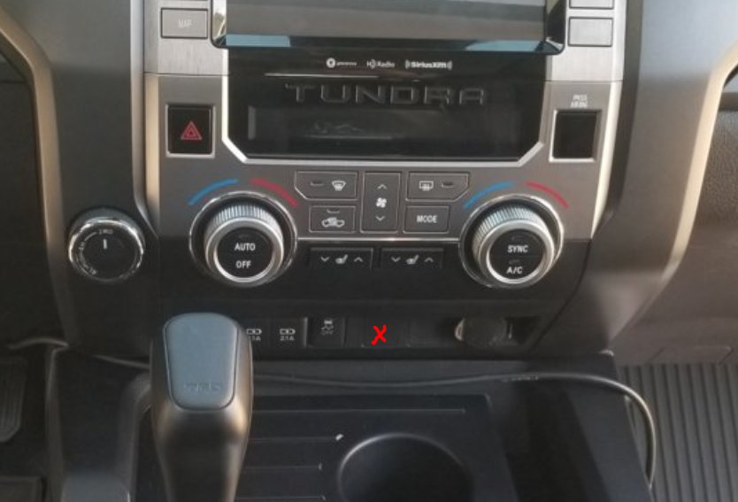

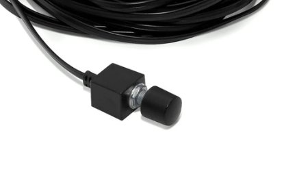

    I don't currently have my bass knob installed, but when I get around to it I plan on putting it here through one of the blanks. I did a similar thing in my F-150 and ran it through a little removable panel near my knee:
    I guess it depends on the knob, but for my JL one, you can easily take the knob off, and then I just drilled a hole in the panel, ran the shaft through the hole (lol) and then used the included nuts to tighten it down to the panel. JL knob looks like this for reference:
    Ends up looking very stock/not noticeable. I'm planning to eventually install these seat heaters:250-1870-TOY Seat Heater Toyota Vehicles w/ Custom Switch - M&R Electronics Inc.
    They have a switch for the Toyota spots there and I plan on moving the USB switches etc. around so that they're in the middle and heat seater switches are closest to driver and passenger seats

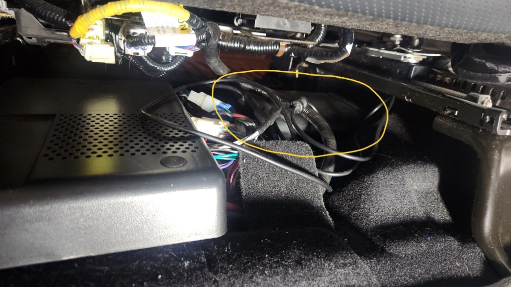

    Here's a pic under the seat. It's hard to see the new amp because it sits down low on the floor. Taking pictures of the settings will be hard to do since you have them for each channel. I've shared my settings with others on here and can send you the file to load into the amp.

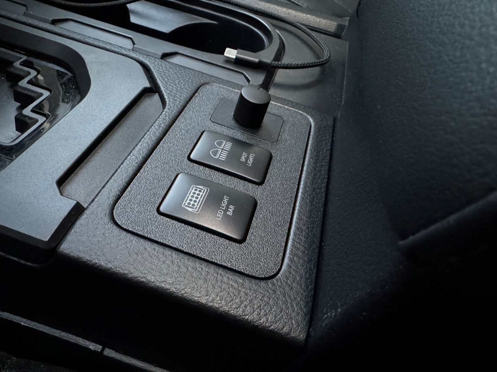

    This was the best spot I could find to put my bass knob.

    Is the bass knob that comes with the JBL/Infinity amp? I couldn't get mine to fit in a switch blank. That's exactly the location where I want to put mine.
  29. Dec 31, 2024 at 2:20 PM
    #179
    IMXPLRN
    IMXPLRN New Member
    Mar 20, 2022
    #76072
    653
    Rescue, CA
    2020 Tundra Limited on 35's
    This is the bass knob for a JL amp. It was a very tight fit and I had to modify the blank to make it fit
