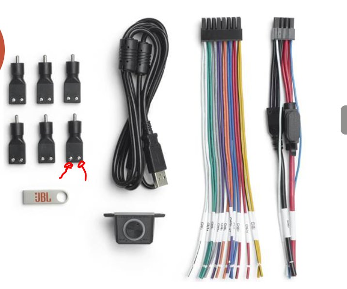

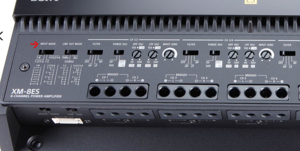

    While I'm in the business of asking lots of questions about how this works...I see 6 RCA inputs for these amps in the pictures, but am expecting 8 channel outputs from the OEM amp. Can any of these very satisfied owners comment on how the JBL amp accepts the OEM signals? Know which of the 8 outputs to connect?
    Cross posting from here: https://www.tundras.com/threads/plu...-2015-1794-stereo-system.144017/#post-3723885
  24. Oct 3, 2024 at 9:39 AM
    #144
    Snert
    Snert New Member
    Jan 31, 2024
    #111218
    739
    2021 SR5

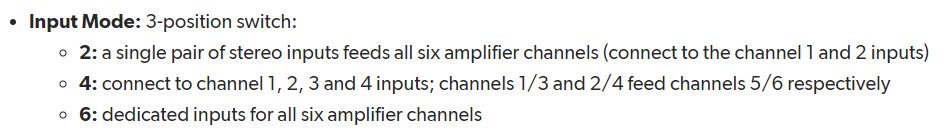

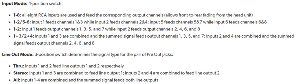

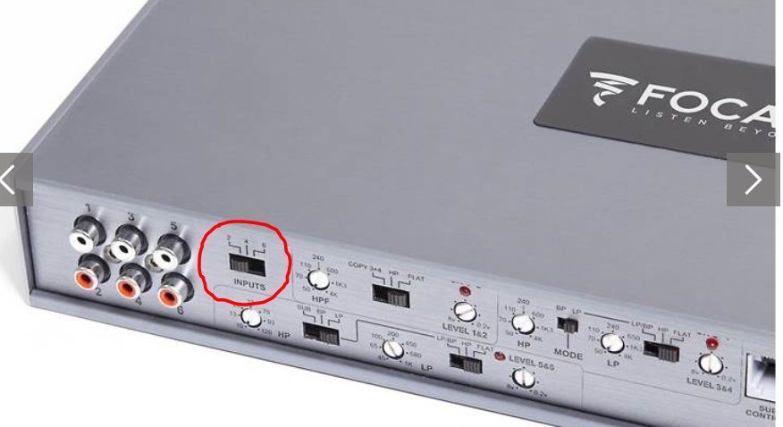

    Posted in the linked thread but answering here as well for anyone else curious. In short, amps don't always need a 1:1 input/output ratio and can often times "copy" the input signal from 1 input channel to multiple output channels.
    When using a higher channel non-DSP amp, the amp will often have a physical input selection switch. A lot of amps will have 1:1 input/outputs, but some may only have 3:4 inputs/outputs. Some amps will also have RCA pre-amp outputs to send signal to another amp, a mono sub amp for example.
    Here's a Focal 6-channel amp as an example:
    or this Sony 8-Channel with additional explanation of how the pre-outs work:
    On the JBL DSP4086, rather than via a physical switch, this is all handled digitally in the software for the amp. Some non-DSP amps will also have signal summing, i.e. that ability to combine multiple signal inputs into one signal output. DSP's/DSP amps can do this as well so that you can have a full range output signal.

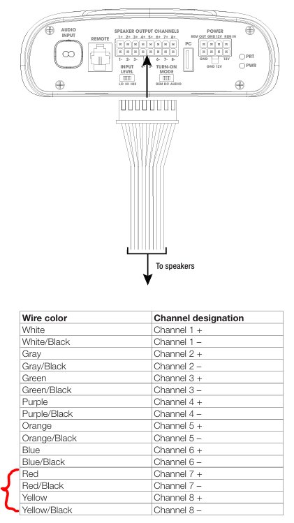

    Alright I have an update, and a set of questions. Hoping @Snert is still around and interested in solving everyone else's audio problems :fingerscrossed:
    I chickened out on trying to program the DSP myself and do all of the right input/output signal summing. I bought one from James and it arrived last weekend. I ran power, hooked it up, and am not getting any sound on the Subwoofer. All the other speakers work, they are much louder.
    The tricky bit here is that I also have a separate mono AMP that was powering the sub before, connected via LOC. I've attached a picture for reference, all the orange components are aftermarket and the blue ones are OEM. When the whole setup is connected as it's laid out in the picture, the mono amp does not turn on and there is no sound coming out of the subwoofer.
    When I eliminate the DSP and associated harness and just go Headunit -> OEM amp -> speakers, the Mono Amp turns on and powers the Sub. To me, that indicates the issue is that the remote wire for the Mono Amp isn't getting any signal when it's hooked up to the DSP outputs.
    Me and James (over the phone) connected a laptop to the amp and the tune that he put on it looks to be normal.
    Any ideas about why an amp like this would not output any signal on one specific channel? There is a 'bass remote' this amp comes with that I have plugged in and turned all the way up...but otherwise James and I are at a loss as to what's happening. He's sending me another AMP (the legacy of fabulous customer service for Tech12Volts continues) but I'd rather just fix this one if I can.

    Still here lol. What LOC and mono amp do you have? Few different things at play to consider. It sounds like you're on the right track that there's somehow now a remote wire issue. With the DSP amp now feeding the mono amp, you probably actually don't need/don't want the LOC depending on what your mono amp is. If your mono amp accepts high level inputs, you could get a set of speaker wire to RCA adapters, connect those to the Sub channel outputs on the JBL DSP amp, and have those feed directly into your mono amp. You can test the the mono amp in this setup by using a small length of speaker wire as a jumper from your JBL DSP Amp's (+) power terminal, over to your mono amps remote input. Just make sure as always to disconnect your battery negative cable before doing any power wiring testing. Your mono amp should then power on (and stay on all the time so you don't want to leave it wired like this) but you could then test and see if the signal is coming out of your JBL DSP amp or not. I'd be surprised if it's not and I think it's more likely there's either a small power issue or signal wiring issue that's causing the lack of signal. Wires on the harness might be wired incorrectly or there might be a setting on the DSP Amp or on the LOC.
    How do you have your LOC powerin gon, dedicated remote wire or some form signal sensing/auto turn on?

    I have the Kicker 46CXA400.1, which does accept high level inputs.
    I also have Kickers 46KISLOC2 LOC, and I'm using the blue remote wire off of that to turn the amp on.
    I am following your idea to jump power from amp to amp to force remote turn on...but I'm hung up on how to feed the DSP's channel 7 (Subwoofer) to the mono amp without cutting into the harness (which I'd like to avoid until I'm sure it solves the problem). In theory I could grab this from the ends of the factory subwoofer harness behind the passenger seat, but the existing set of conditions make me think that there won't be signal there (or the LOC would already be working as intended).
    As I type this I realize I can probably use wire taps on channel 7 right next to the amp...are there any possible long term consequences for those?

    I forgot from looking at this amp before that it actually comes with speaker wire to RCA adapter plugs so you should already be in luck! The little grey dots below should be set screws so that you can attach the black RCA plugs to the ends of your colored speaker output wires.
    You can look at the harness how it orients/plugs into the amp to see which colors are which channel, but from the manual it looks like Ch 7 and Ch 8 are red and yellow respectively:
    I think from another person who bought the JBL DSP amp from Tech12Volts I remember that person did not have a an additional sub amp, and the way Tech12Volts wires it up is so that the factory amp is retained to use the factory amps sub channel, because the JBL DSP amp's sub channels are the same power rating as the rest of the speaker channels, i.e. 40w @ 4 ohms, 60w @ 2 ohms, and since it is not bridgeable, that wouldn't be enough juice for a sub, so Tech12Volts uses the DSP function of the JBL amp to clean up and make the signal better before sending it to the factory amp to up the power. In your case, I'm wondering if it's set up like that and the reason you're not getting signal to your mono amp is that the signal is being routed to the factory amp instead.
    If all the other speakers are working correctly, and you can get the mono amp to turn on, then connecting the RCA adapters to your red and yellow wires on the JBL DSP amp, and then using those newly created RCA ends to plug into your Kicker mono amp should work, and you'll then have the the "good" clean/tuned/DSP'd signal for the sub channel coming off the JBL amp to feed your Kicker amp.
    Let me know if that makes sense and if not I can draw up a little wiring diagram to illustrate.
