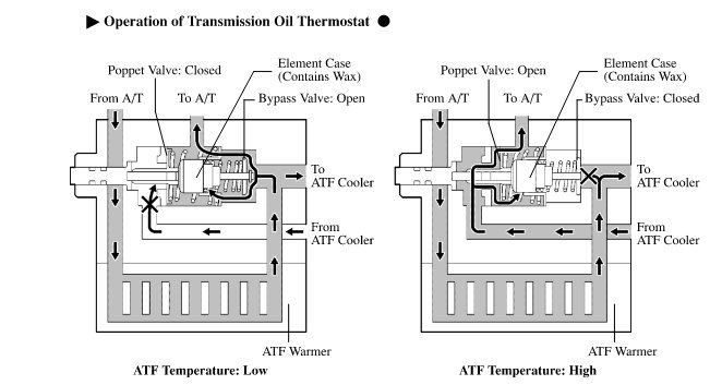

    here's what I'm presently pondering...
    no cooler - I ran 220's unladen - flat road. sometimes - 240 in Africa-type Houston summers.
    cooler un-pinned- I ran 195 no matter what the weather.
    cooler pinned - I run 165
    my quandary -
    It would appear the cooler never opened given the above data
    or if it did, it opens and closes a lot. you would think that once the thermostat opens, the trans temp will drop to 165.
    but when it's un-pinned it stays very stable @ 195.. explain that.
    and (pinned open) it also appears that the Trans heating up has a strong correlation to the engine temperature, because once I've been driving for say 15 minutes....the trans is stable @ 165-ish - regardless of ambient temp.
    I don't tow, so I can't speak to that variable.
    wait - I did tow a small covered trailer from Houston to Belton...the trans rose & stayed @ 201 with unpinned cooler. explain that one.
    and for the cherry on top - I use Valvoline maxlife. I've done 2 D&F's with 80k miles on it.

    I can't explain why yours is staying at 165F, other than the cooler is really effective at heat transfer. I keep mine unpinned and let the thermostat open and close. It opens around 195F and temperature drops to 185F and hovers around 185F-195F. Before I was well into 220F without the cooler. The fluid is always "warmed" by the warmer puck, regardless of whether or not it is pinned. 165F does seem really low though.
    nobodyintexas likes this.

    The thermostat can be in a mid position and trans fluid can flow to both the ambient cooler and the liquid to liquid cooler/warmer. There is no on/off like operation, it's variable. Think of it the same way your engine thermostat works. Would you ever remove your engine thermostat to allow it to run cooler? Of course not.
  16. Nov 15, 2023 at 6:44 AM

    Do you monitor engine oil temps?
    Agreed with @Ruggybuggy that the thermostat isn't necessarily an on/off switch. What I have noticed since running a cooler (I do not pin the T-stat open) is that my transmission pan temp tracks engine oil temp at ±<2ºF. This is a function of the internal oil puck. This is how the transmission gets up to operating temp. Pinning the T-stat open simply prolongs this process because the cool air flowing over your radiator works against the warm engine oil flowing through that puck. And maybe it prevents it from occurring altogether if you're just doing easy short trips.
    I guess my main point is, if your engine oil doesn't get up to 195ºF-ish, then I don't think your transmission will get there, either.
    The benefit of the external cooler I observe is that the pan temps never run away from engine oil temps like they did before. And I'm a broken record on this part of it: when this transmission was designed, EVERY tow package-equipped truck came with one. I just want mine to work as originally designed, even if the 2019-2021 trucks have different lockup programming.

    The other part to consider is what fluid is being sent to the thermostat. It appears as though the fluid exiting the torque converter goes straight to the thermostat/cooler, which makes sense. Send the warmest fluid directly to the cooler.
    When im on the highway, 80mph, TC locked in 6th gear, i'll see 194F pan temp and TC outlet temp. If i go up a slight rise, TC unlocks, TC outlet temp may jump to 200-205F, pan temp does DOWN. I can watch as the pan temp will cool down to upper 180s. TC locks again, temps both settle back at 194.
    If i'm sitting stationary in gear, TC outlet temp will be mid 190s. Pan temp will cool to 177F-ish.
    Thats why i installed a giant trans cooler, no need to pin the thermostat. Just drive the thing.

    you make a good point...I do monitor engine temp via SG3, and it is a normal 195-ish. which is part of my temp delta conundrum.
    I would have bet a $1 that the trans would rise to 195 with it pinned....it would just rise slower.
    on my recent 400 mile road trip, the trans never rose above 170. ponderous.
    once we get some colder air here in Houston...we maybe might get to 32...i wonder if it will still stay at 165-ish. If so, I'll unpin.
    but the real mitigating factor is getting under there and removing the cat shields. not fun.

    I guess my conclusion is that your cooler overpowers the internal puck with the T-stat pinned.
    I'm running one of the original Hayden kits that Genuine Cooling Systems offered back in Fall 2020. I understand that various kits since then have run larger radiators.
    If I wanted to be really paranoid, I would be concerned with the moisture issue over the long term if my transmission never got up to the temps at which water vaporizes.
