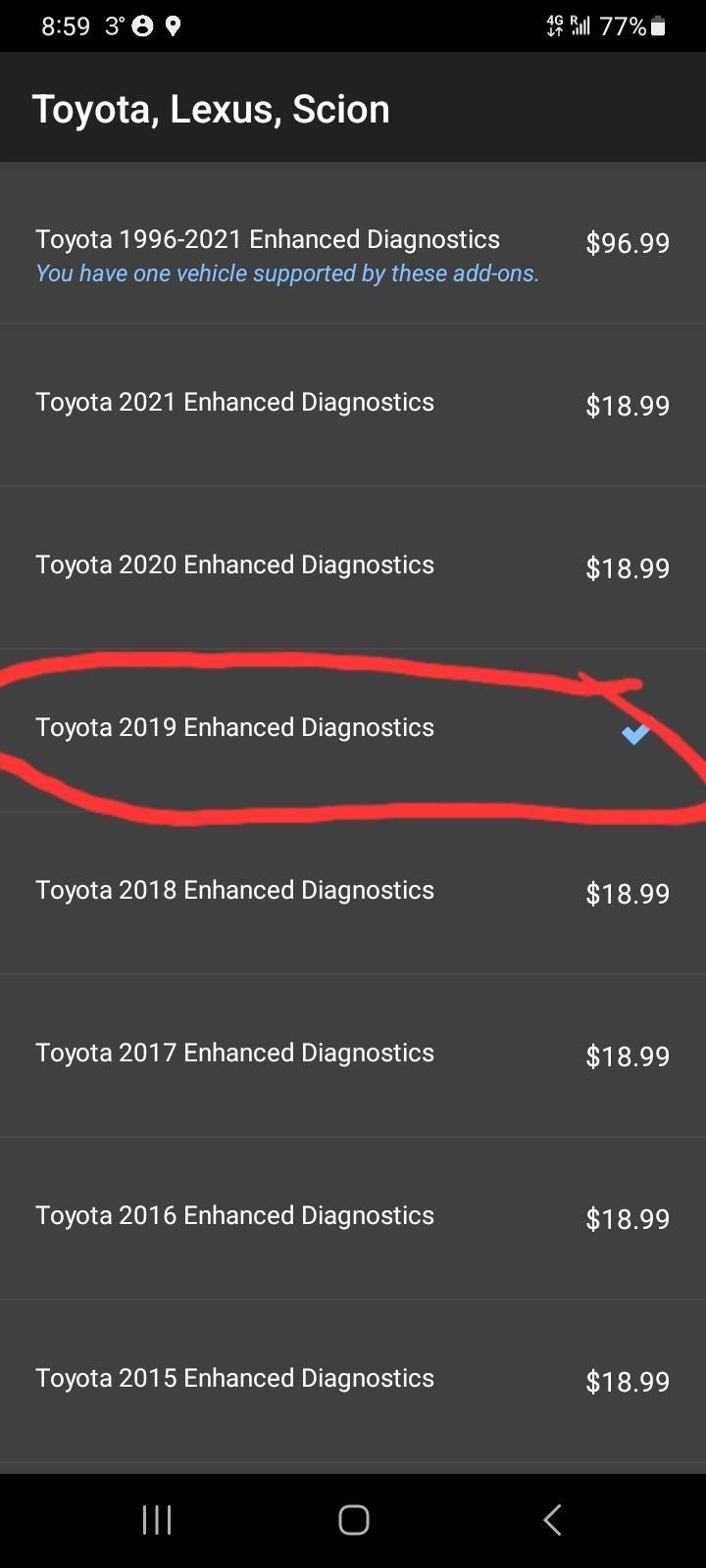

    @Ruggybuggy where do you find the ATF degradation in OBD Fusion? I have the enhanced diagnostics but don’t see it anywhere in the diagnostics menu when I run the report.
  25. Nov 8, 2023 at 4:40 PM
    #25
    Tbrandt
    Tbrandt I read it on an internet forum, it must be true.
    Jul 26, 2021
    #65976
    508
    Tristan
    Kansas City
    2021 SR5 DC TRD Off-Road
    Kenwood DMX907S + Maestro iDatalink RR2 Kenwood DRV-N520 dash cam Kicker Door Speakers TRD rear sway bar Firestone airbags + Daystar cradles Setrab oil cooler, OEM thermostat and hard lines Century High-C topper Bedrug Helmholtz resonator on stock exhaust Sound deadened + insulated cab Platinum 20s, hwy tires Viair 400P
    I found it. Had to go to the PID Values tab under diagnostics and add the ATF degradation estimate through the menu.
