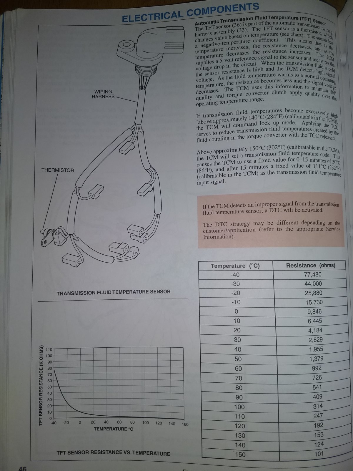

    Oh yeah, it does. At 150 C the temp sensors are out of range, it switches over to a preprogrammed ATF temperature, because it can not trust the input anymore. In some TCM firmware modification it does the switch permanently after a few overheating events.
    I read my Tundra today and found the counter to be 2660. D&F it 2 times, the first one was of brown color, which indicates burnt fluid.
