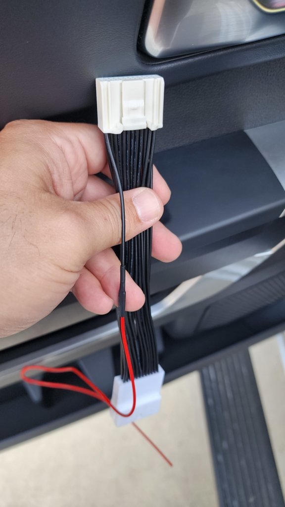

    38

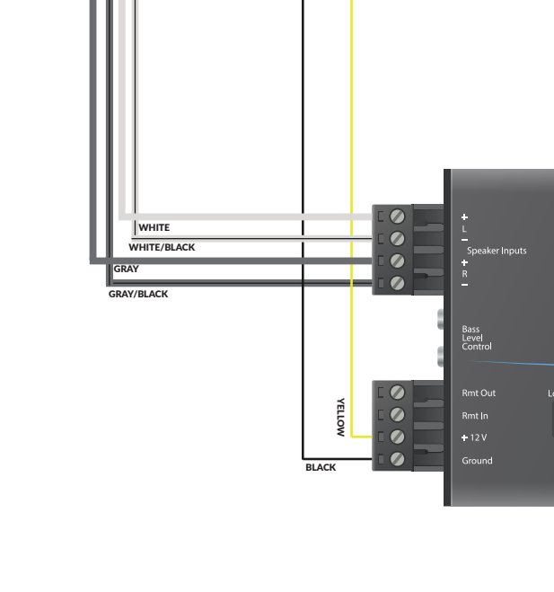

    Now the question is, which is better? In terms of diagram provided or color coded. AAH is cheaper for sure.
    AAH or TT?

    "Need" is subjective I suppose. The ONLY reason you would need to have the 24-pin harness is to avoid splicing into the factory harness for switched 12V+. That's the only wire that gets used in that harness.
    I wanted to have the ability to go back to stock without a trace. No wire tapping/splicing into factory harness at all. So I opted for both.
    The ship notification from AHH was in my inbox today. Hopefully I'll have them in a few days and I'll report back here.

    You could skip the 24 pin and get an Add-A-Circuit for much cheaper. Additionally, most amps nowadays have signal sensing turn on, although it's been kind of hit or miss for me on some amps.
    AHH is $68 for the 30 pin, $25 for the 24 pin.
    Taco Tunes is $49 for the 30 pin, $40 for the 24 pin.
    Not including shipping, both options are about the same unless you were to get the 30 pin from TT and do an add-a-circuit for $5-$10.
    The $139 price listed on TT is a little deceiving, that's the price for the LC2i Pro only, with harnesses and LC2i Pro they have it for $280.
    LC2i Pro vs regular LC2i main difference is in frequency response, LC2i Pro 20Hz - 50kHz, LC2i 33Hz-100kHz. For a sub amp I'd say the Pro is worth the extra $30 for the lower bass response, also comes with a remote knob.
    Could also go the DSP amp route and skip the LOC + Amp setup, or rather than combine them into one, since just like most new amps having some form of signal sensing turn on, most new amps also accept high level inputs so you're really only using an LC2i for the AccuBass function. Kicker Key mono amp does auto-dsp that's supposedly pretty solid, Sony has a 6 channel XM-GS6DSP you could use just the sub channels of in bridged mode. Cheapest route is definitely the Kicker Key, the Sony would be about the same cost as an LC2i Pro + mono amp, and then higher end the AudioControl D-4.800 bridged. Really depends what kind of subs one's looking to add.

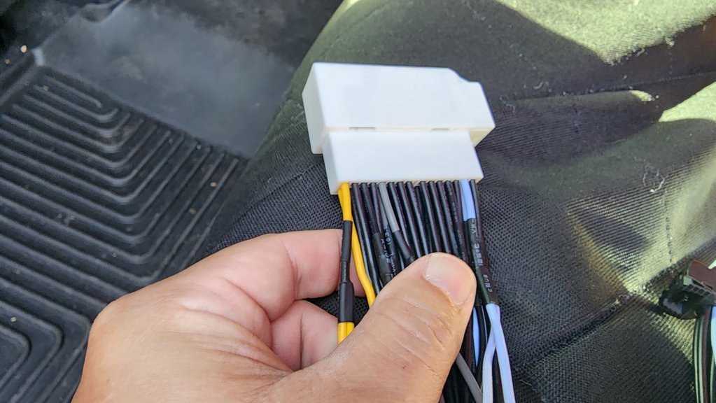

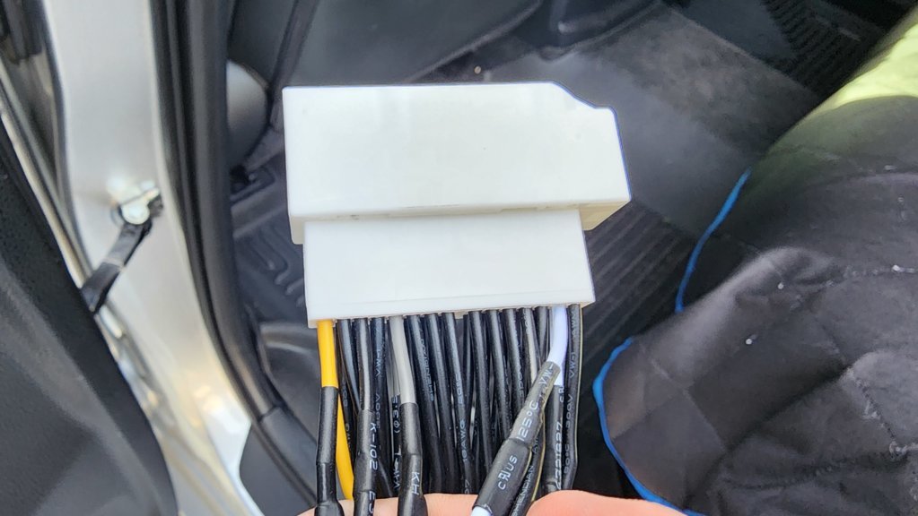

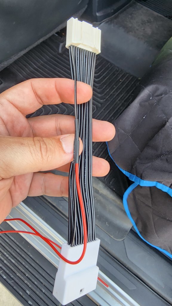

    I did...ill snap some pics tomorrow. I have both harnesses and lc2ip in the truck

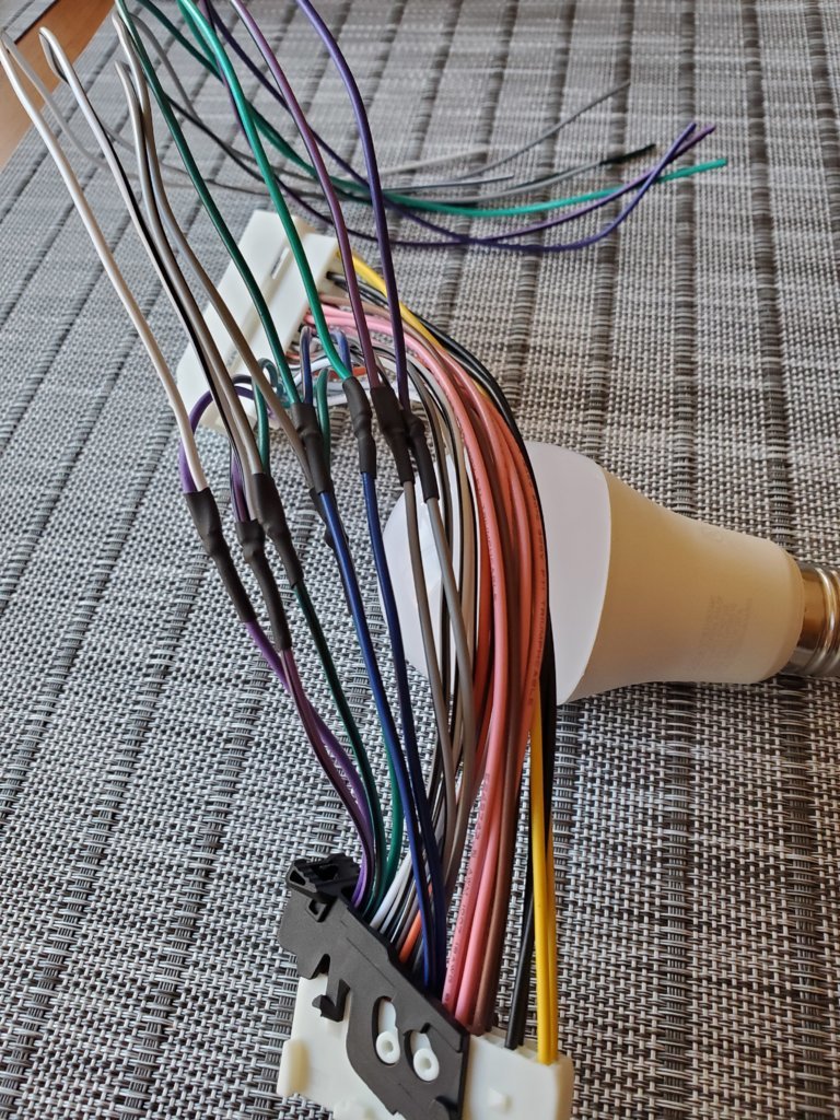

    Observations and questions on 30 pin harnesses; AHH vs. TT:
    Here is my 30 pin jumper harness from AHH. (26 of 30 positions populated.)
    (I did not take a pic of my AHH 24 pin harness. With the exception of slightly more wire length, it appears to be EXACTLY the same as @eddiefromcali 's TT 24 pin. All black wires, and a single red breakout pigtail.)
    Back to the 30-pin. What I am questioning is the color-coding on the wires and the differences in which wires are broken out between TT (eddie's) and AHH (mine).
    What I assumed to be O.E. colors on the jumper portion of the harness, (but now have serious doubts) AND the broken out pigtail wire colors. I'm sure there's reason to this rhyme somewhere, but the colors look all over the place.
    I don't suppose anyone has an actual pinout diagram for the 30-pin JBL harness?
