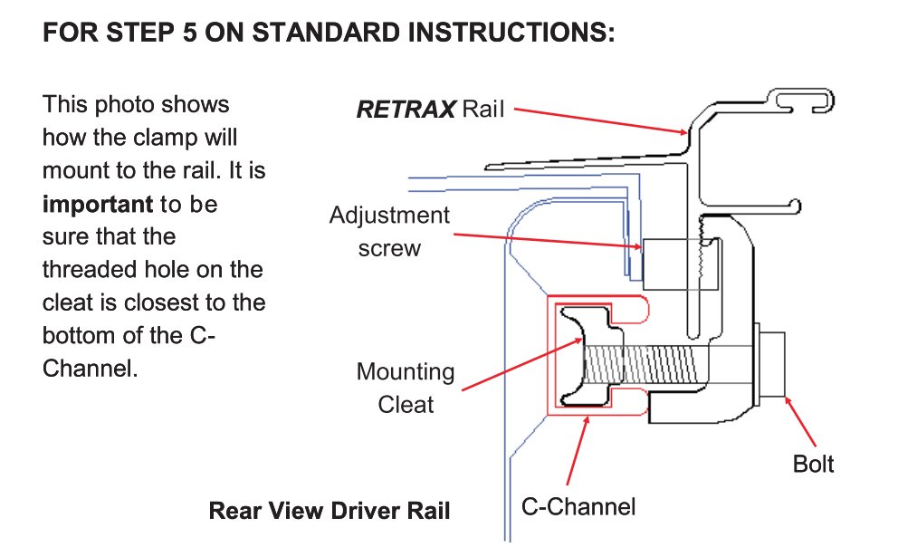

    Here's a picture of the clamp in the worst performing corner (rear passenger side). Many things have been tried, pushing down on the edge while pulling up, shims behind the nylon adjustment screws, makings sure the canister is supported while mounting the rails. These were all done by professional installers with the guidance of the manufacturer.
    I'm of the opinion that it is a design issue, not install issue. If the channels the bearings roll in needs a rise, it should be built into the rail. Or, where the side rail attaches to the canister it should attach with the rise built in there instead of attaching square. Or, the brackets that hold the rail should attach securely to both side of the rail and have an adjustment bolt/screw in how it is mounted to the utility rails that provides controlled adjustment of the angle.
    You can also see the c-clamp should have more clearance over the small ridge below the nylon screws, because if the side rail is appropriately far from the side of the truck the clamp hit that part of the side rail and pulls the side rail down (eliminating the rise). In order to avoid that contact the side rail would be need to moved out farther, but then the rails would not be parallel and the problem whack-a-mole out in other ways.
    As a result of all of this the channel (where the water collects) is basically level. Then the bottom of the aluminum rail of the cover is right on the small lip, breaks the surface tension in that spot, and the water just starts to pour in. This happen when the truck is just parked level (most parking spots) with static water on the cover (not high pressure water at the rails or anything like that).
    I don't want to be too negative about it, but I do think I've given it a solid chance and it just doesn't seem to fit my truck.

    Yea absolutely, I can definitely see why you’re ready to throw in the towel!…only thing I’m noticing is the clamp, I would try one more thing…I have my clamps up against underside of the rails, literally push them up and tighten them down while holding them up against underside…I can see a little gap (looks like it anyway, a little hard to tell in pic)…just trying to think of anything to help ya, I’ve installed 4 of these covers on 4 different trucks of mine and never had that issue…but totally get why you’d be ready to trash it!…I can post a pic of my clamps if ya want, but I included the “small gap” that I’m referring to on your clamp…you can even call me if ya want, I’m happy to try to help (and no, I have no affiliation with Retrax….lol)…it’s kinda hard to explain in txt, but let me know if I can help in any other way, good luck man!

    Thanks for the suggestion! I re-installed making sure those mounting brackets are right at the top of the channel in the side rail, while again pushing & "twisting". It is actually surprisingly better than I have seen so far (almost to the point of what I originally expected). Thanks!
    I actually crawled into the bed and had my wife close me in while doing a water test and noticed a couple things. Most of what is left is water streaming in at the back corner. I can probably manage that, despite it being worse than I expect.
    The more surprising thing to me that I realized while in there are that there are a handful of panels (maybe 4 or 5) that have little screws in them and one of them in particular is leaking a steady drip from the screw (this is towards the end, but before the side rail). I've also noticed a few scrapes on the underside of a couple of the panels that I wouldn't expect in a brand new cover. Sorry for the quality of these screenshots... the videos are far more compelling, but don't share to the forum well.
    Now I'm kind of wondering if I just got a lemon in addition to the design challenges.

    No prob, glad it helped ya!…I agree, looking at those pics it definitely looks like something isn’t right from the factory…I would send them those, especially the pic of the screw leaking!…I’ve never seen that before, and that’s clearly not anyones fault…that looks like poor quality control on their end…hopefully they’ll realize something isn’t right and take care of ya!

    I'm thinking you got a defective cover. From what I have seen several places online, I am surprised Retrax isn't shipping you a new cover; that is a ridiculous amount of leaking! I have the same cover on my truck and agree with you, I think the rail design definitely needs a redesign. I can run my truck through a car wash and get only a few drips on the sides from high pressure water. The only thing that puzzles me is I often get 5-6 drips in the middle of the bed. I assume these are running across the bottom of the cover from the tracks. Nevertheless, nothing compared to what you are experiencing.
    My patience would be well past done if I was you. Retrax would have a cover on the way to me or someone would be getting that one back! The Retrax is the fourth cover I've had on my truck, LOL. I guess I'm hard to satisfy. Good Luck!
