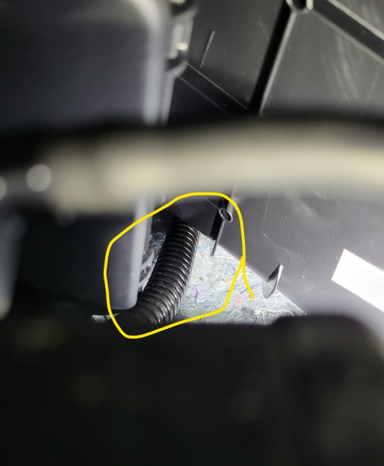

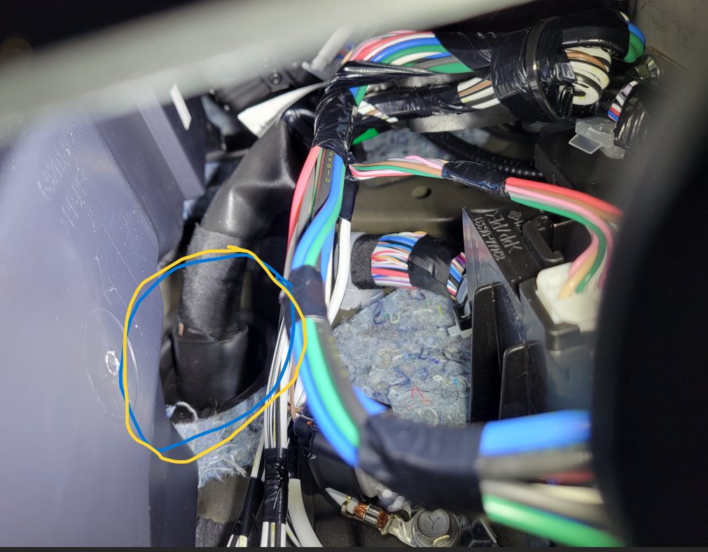

    I did not find a passthru on the drivers side, there is one on pass side:

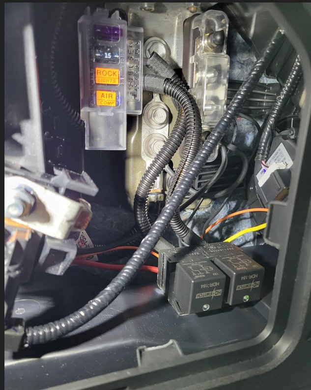

    For my light bar, I ran the cables (in loom) under the kick plates then under the carpet into the seat box.

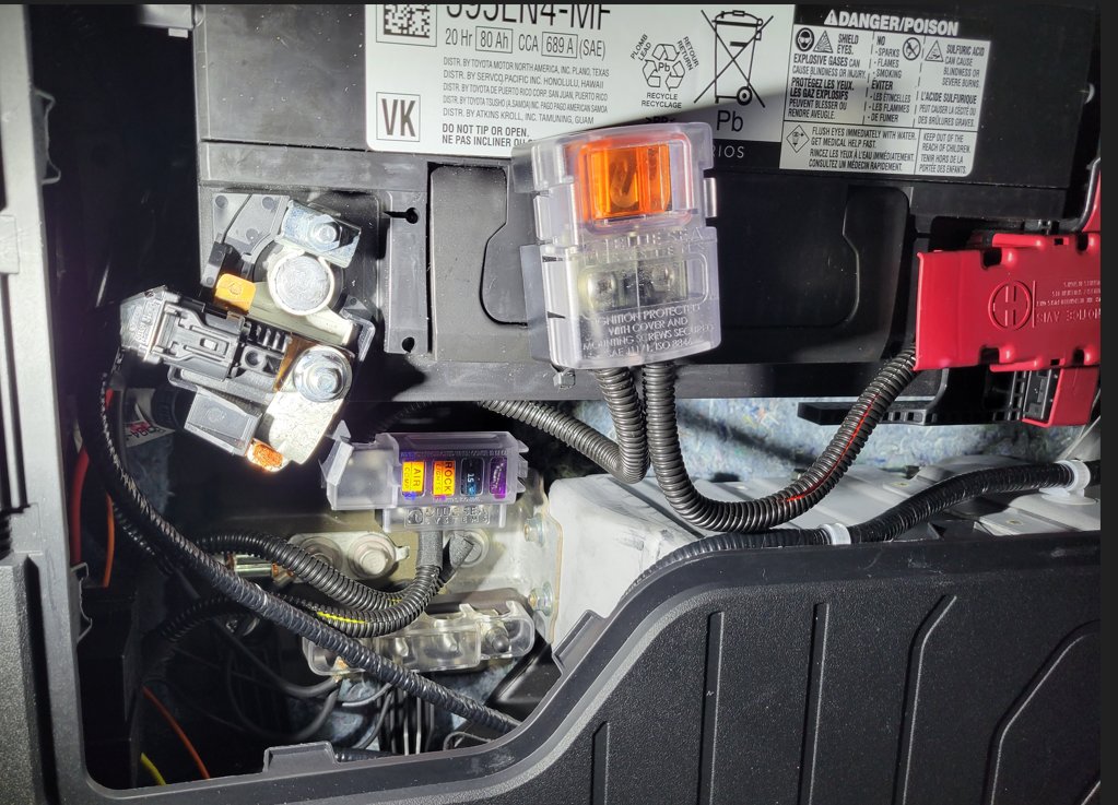

    I did add pos and neg busbar/fuses/relays.
