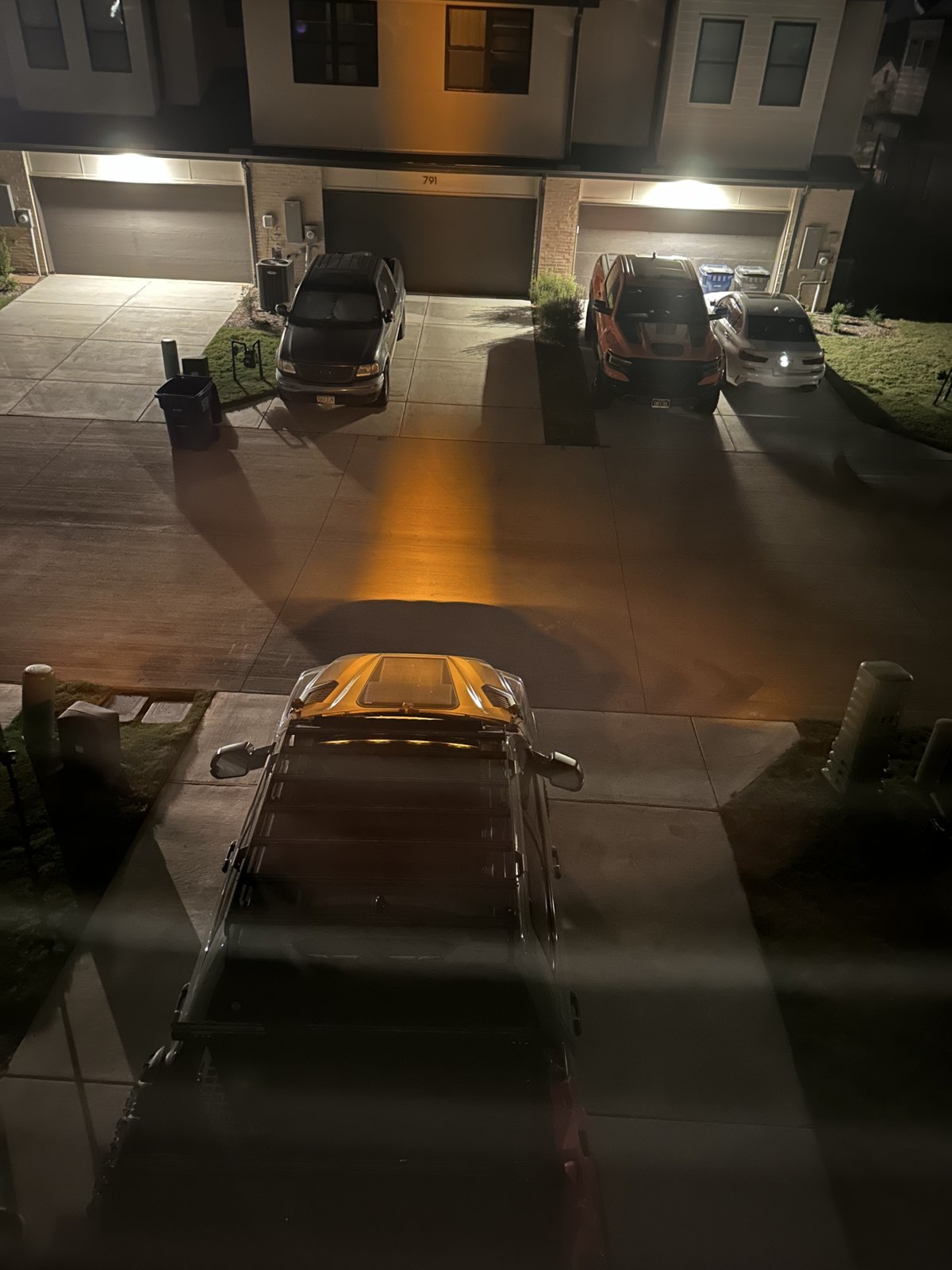

    Any help with diagnosis much appreciated.
    I have a Baja designs S8 on top of my prinsu rack, with DRLs tapped to fuse to always be on with ignition. It is directly connected to battery and switched with an aux beam for the actual lights. I’ve noticed the DRLs only, will randomly turn on at night, around 2-3 minutes at a time. Maybe 4-5x or more overnight. I took it to my local dealer to trouble shoot, they said they fixed the issue but just noticed again tonight. Last time this happened while overlanding, I opened the door with ignition off and noticed my auxbeam was fully powered, and I was able to fire up both my main lightbar as well as ditch lights.
    any idea why this could be happening?

    Hey @NHKTundra,
    I would suggest doing a bench test on the S8 to make sure everything is working properly. If you are seeing any strange issues with the bar please feel free to contact us and we can help further the diagnosis. Another thing I would check is to make sure all the grounds are good and there are no loose wires anywhere.

    Hey @NHKTundra,
    What fuse are the DRLs tapped into? I recently noticed on my vehicle the interior lights turn on when I walk up to the vehicle with the key in my pocket. Maybe the fuse you have tapped into is getting power when the vehicle senses the key is nearby?

    So the 3rd gen Tacoma guys had this happen with allot of aftermarket lights. Has something to do with the truck periodically running something like a diagnostic (auto evaporator check) while the vehicle is off and it has to do with the fuse you use.

    Thank you both gents. My local installer finally figured that it does have something to do with some sort of emissions check, could be the same as the evaporator. They said the fuse they had tapped into carried that line.
    Hopefully all fixed!

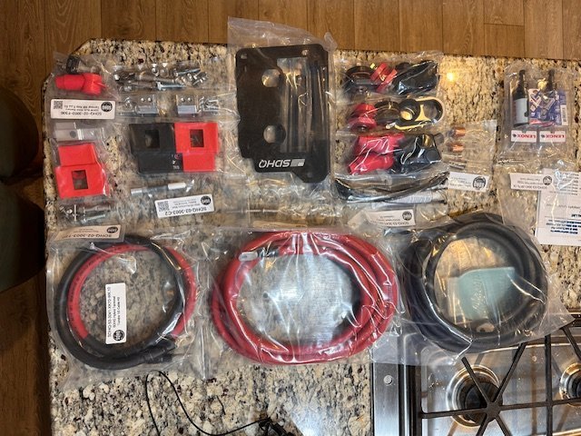

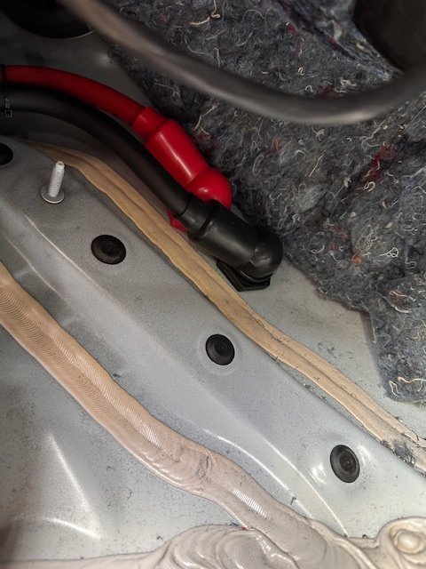

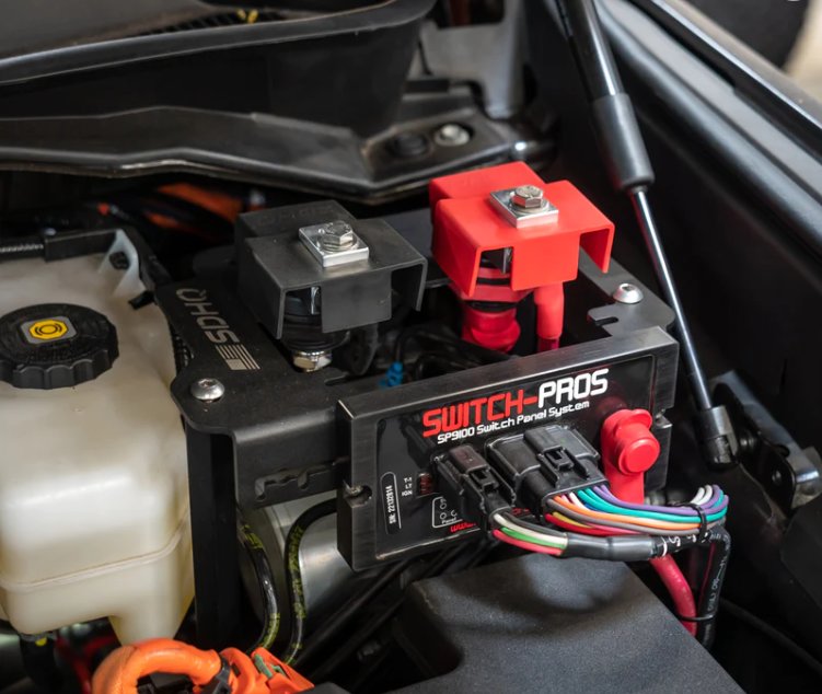

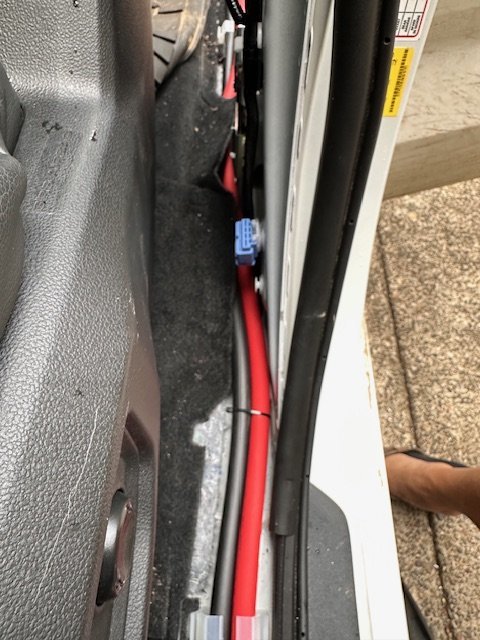

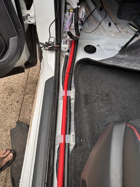

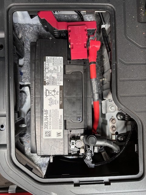

    Hey everyone,
    Regarding Winch installs, there are three solutions for properly running power in your hybrid Tundras:
    1) Run power to the fusebox and tap into the middle terminal which is the direct run to the main battery,
    2) Run thick gauge power and ground wires from the front all the way to the battery location in the cab, and
    3) Install SDHQ's under hood power solution kit
    Arguments about each of the above solutions are as follows:
    1) An offroad vendor suggested the use of tapping directly into the fusebox. While this is the easiest and most convenient, I'd caution this approach as this is only rated at 150 amps. While the center connection is rated for 350 amps, some winches like a Warn can pull a full 420 amps under full load.
    2) Running thick ga wire from the bumper to the rear cabin will be long and costly. When I contacted Warn's support department, they don't recommend a power run longer than 78" nor do they recommend running 1 or 0 gauge.
    3) The SDHQ under hood power solution seems to be the best option for us at the moment. I'll post a link to the video here, but at nearly $1k, it's a pricey solution that brings power to under your hood making our issues go away.
    Here's some pics of my SDHQ install:
    Screenshot 2023-10-23 151251.png IMG_2055.jpg IMG_2059.jpg IMG_2060.jpg IMG_2061.jpg IMG_2062.jpg
