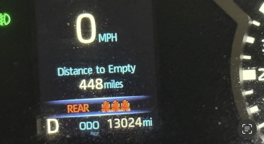

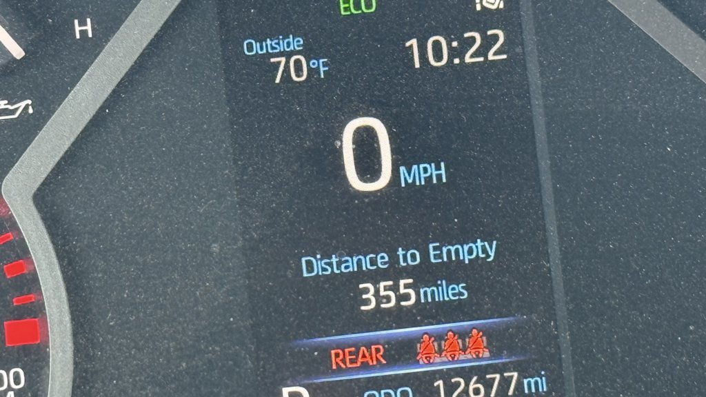

    I have an interesting observation. After having the TSB-0038-25 flashed today I decided to fill up. I have the analog fuel gauge with digital estimated driving range shown. Usually when I fill up for the last 3 years my maximum range is 350-365 miles. Today for the first time ever my range is listed as much higher, 448 miles. I have never had this high a range. Seems a big coincidence to have this happen immediately after a flash. IMG_0304.jpg IMG_0467.jpg

    The range is dynamic and calculated on your current avg all time mpg. Same dash as you, after the update mine did the same but went down. Its first two years I was in WA averaging 18/23. When I’d fill up the estimated range was 500 or better. Now back in So CA it only shows 425-450. (hills and signals every 1/8th of a mile)

    The learning was reset when the combination meter was flashed. It will correct after a few full tanks of gas.
