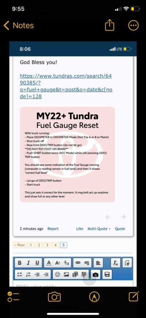

    DRP
    DRP Old Member
    Aug 20, 2023
    #102452
    1,015
    Dave
    2023 1794
    No permanent fix as far as I know. This should work to reset it though.

  7. Apr 13, 2025 at 5:53 PM
    #37
    PNW Tundra Mike
    PNW Tundra Mike Tired and ReTired
    May 29, 2023
    #97791
    1,261
    Back in So Cal
    2023 Tundra Limited TRD-OR CMax 5.5’
    MX4 Tonneau, Talon's Trans/Cat Shield, Vantrue Cam
    This problem affects a lot of trucks 22 to 24. I haven’t found temp to affect it at all. Happened from Summer to 20°f in Winter for almost 2 yrs now every time it’s parked nose up in the driveway at 3/4 of a tank. Much faster reset I use is shut the truck off on a level surface in D with just one Start/Stop button click. This leaves the main power on. Watch the dash and you’ll see the oil pressure reset and then the fuel gauge drop from full to its correct level. Shift to N, start back up and you’re good to go. Toyota has still refused to acknowledge this problem across 3 yrs of the Gen3. Seems to have mysteriously disappeared in 2025 models.

  11. Apr 15, 2025 at 11:53 AM
    #41
    DRP
    DRP Old Member
    Aug 20, 2023
    #102452
    1,015
    Dave
    2023 1794
    Our trucks shut off while in gear all the time at stop signs. I wouldn't worry about it. Funny thing is that Tundra Mike's procedure doesn't work for me. I have to use the one i posted earlier.
  12. Apr 15, 2025 at 2:49 PM
    #42
    dano9258
    dano9258 New Member
    Nov 27, 2023
    #107569
    137
    2024 Limited 4x4 OR Pkg
    MX4 Cover
    I just tried this method and it didn’t work. I have a digital display if that helps. I did the odometer button method and that did work.
  13. Apr 16, 2025 at 9:31 AM
    #43
    PNW Tundra Mike
    May 29, 2023
    #97791
    1,261
    Back in So Cal
    That’s right. Some with digital have reported that before. Thx.

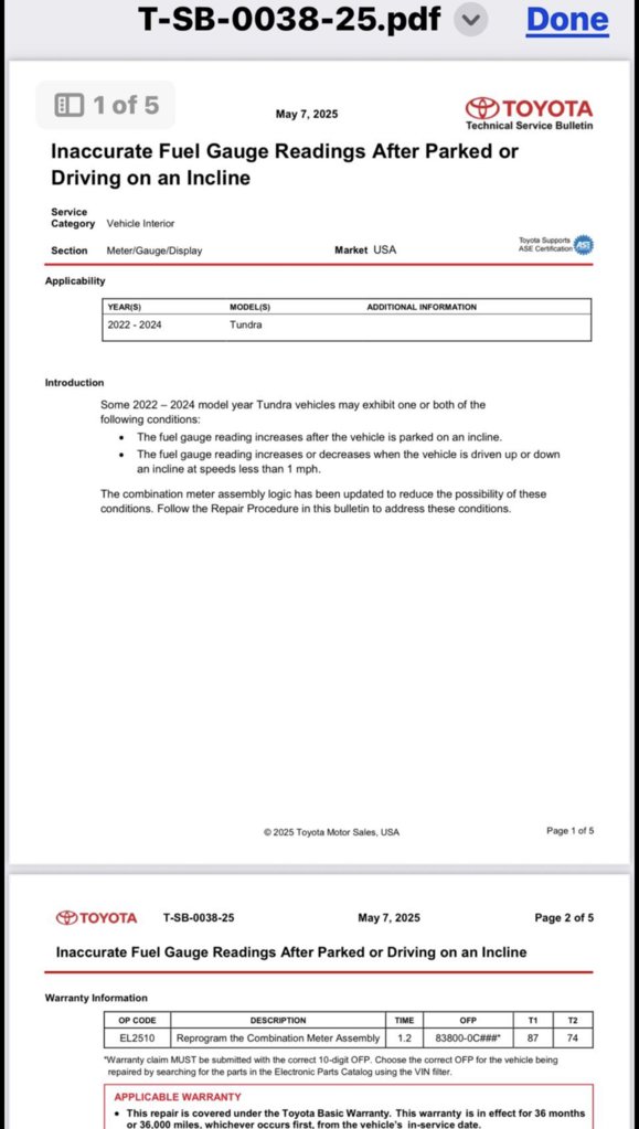

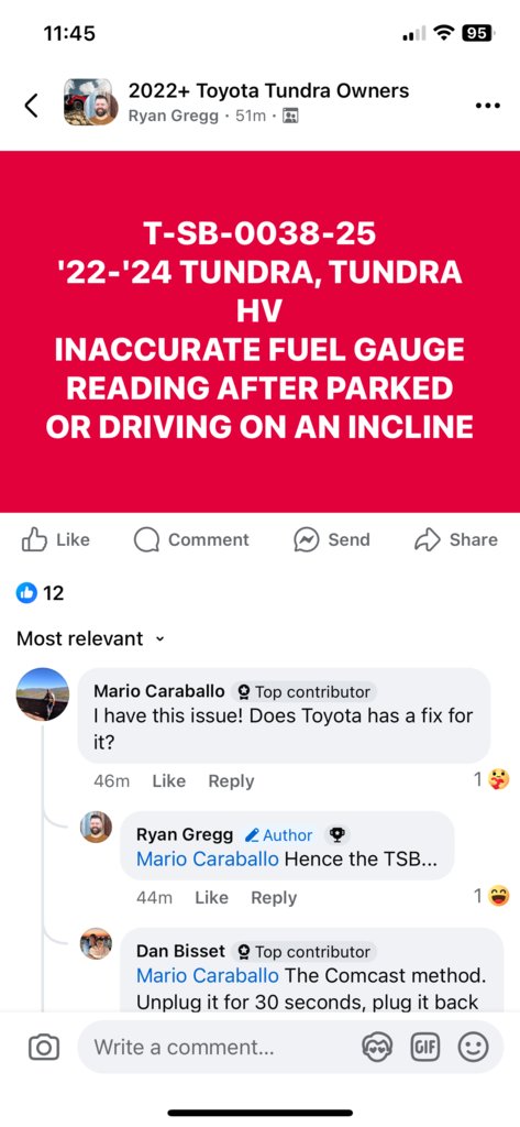

  17. May 7, 2025 at 12:03 PM
    #47
    trazerr
    trazerr New Member
    Jun 5, 2020
    #47579
    546
    Oregon
    2024 Toyota Tundra Platinum LR
    Yeah, just looked again and Ryan dropped off the HV part in his title. Sucks to be a hybrid owner. First no engine recall and now no inaccurate fuel gauge fix.
  18. May 7, 2025 at 12:06 PM
    #48
    dano9258
    dano9258 New Member
    Nov 27, 2023
    #107569
    137
    MX4 Cover
    Wait, there is a fix now!?
  19. May 7, 2025 at 12:09 PM
    #49
    sudobash
    sudobash New Member
    Jun 13, 2024
    #118355
    1,064
    Yes.
    T-SB-0038-25
    It will be a Combination Meter Reflash, much like T-SB-0022-23 that was suppose to resolve this.

  23. May 8, 2025 at 1:31 AM
    #53
    PNW Tundra Mike
    May 29, 2023
    #97791
    1,261
    Back in So Cal
    I don’t have a TIS account with Toyota. Anyone have the actual text of this TSB?
    TIA !!
  24. May 9, 2025 at 11:29 AM
    #54
    Pine_Cone67
    Pine_Cone67 New Member
    Oct 23, 2024
    #124723
    160
    2024 Tundra Limited
    Someone posted 1.5 pages on a FB group. Hoping the entire doc will be made available soon..

  25. May 9, 2025 at 12:23 PM
    #55
    sudobash
    sudobash New Member
    Jun 13, 2024
    #118355
    1,064
    That's a great way to get a letter from Toyota.
    It's a simple Combination Meter update. Same as the original TSB for this issue.
