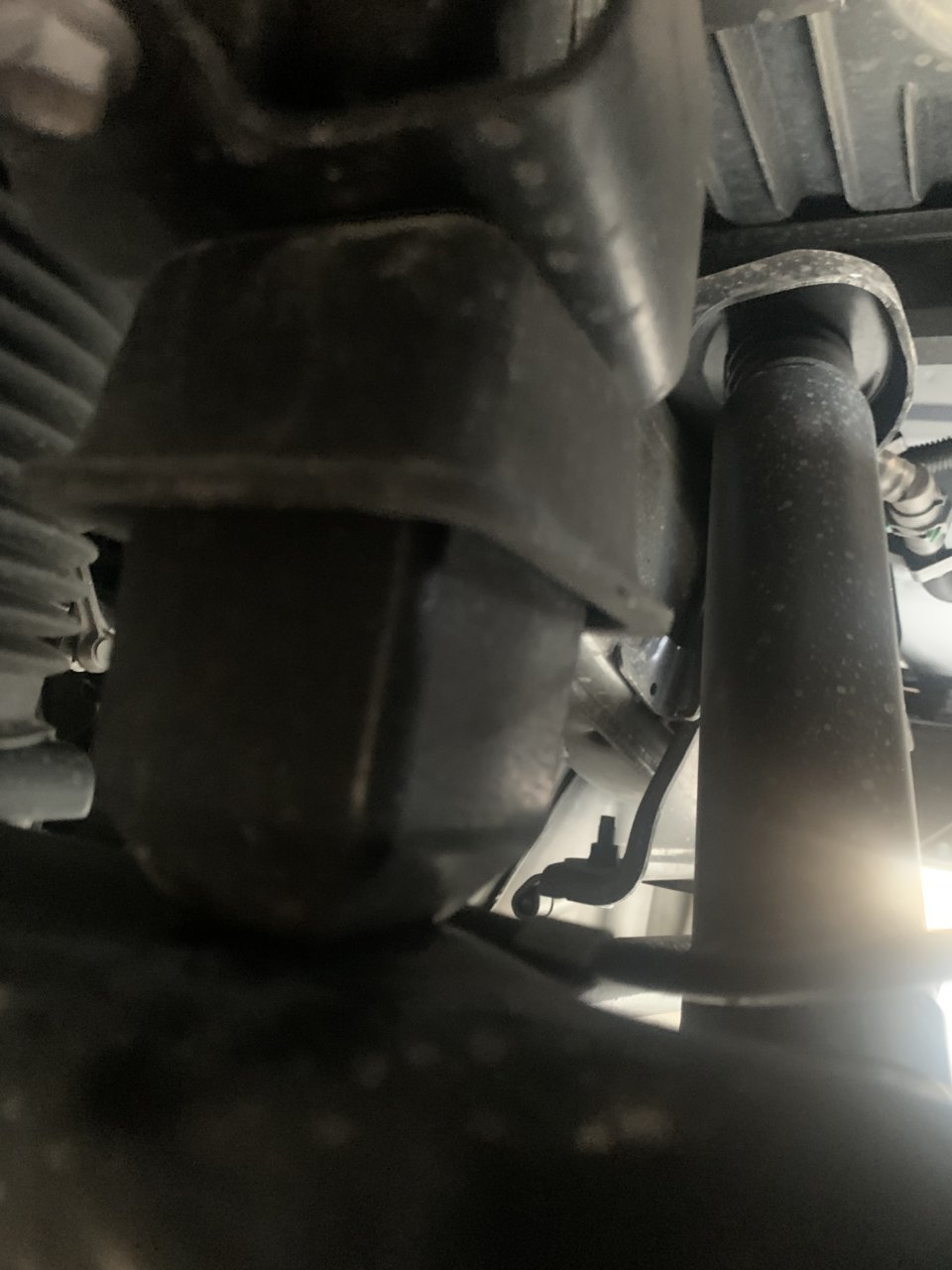

    Got the TSB 0070-22 for the ride height done, not sure I should have done it. I might have to get it put back to where it was. The ride now is a bit rougher, before the ride was good and only when I hit some specific bumps did I feel the bump stops. Not really happy with how it ended up.
    Edit: yeh the fk’ed it up, gotta take it back

  22. Mar 23, 2023 at 5:30 PM
    #52

    obgod3 New Member
    May 14, 2018
    #15308
    197
    NC
    2023 Tundra Limited
    After the did the TSB LOL this is what it looked like….they are idiots. 581E8614-3F74-4FA4-9C99-69AE75BE2670.jpg
    Hella Krusty likes this.
  23. Mar 23, 2023 at 5:36 PM
    #53
    99ways2die
    99ways2die New Member
    Mar 30, 2018
    #14012
    630
    I don't see a problem.
    ...now it really won't bounce anymore.
  24. Mar 23, 2023 at 5:44 PM
    #54
    Hella Krusty
    Hella Krusty New Member
    Dec 8, 2022
    #88103
    1,719
  25. Mar 24, 2023 at 4:19 AM
    #55
    obgod3
    obgod3 New Member
    May 14, 2018
    #15308
    197
    NC
    2023 Tundra Limited
    Well Im back at the dealer this morning, when I used language like “unsafe vehicle” they moved pretty quickly, I wasn’t nice I let know all you have to do is read and left the TSB paperwork for them. They got one shot at this, I wont leave before crawling under the truck. More to follow.
  26. Mar 24, 2023 at 7:03 AM
    #56
    Hella Krusty
    Dec 8, 2022
    #88103
    1,719
    Take 10mm wrench with you when you go under, push lever all the way up and tighten. Get in truck and cycle the air system. All way up then down thenneutral. Should be at new ride height then. If not repeat up down then drive around the block
    obgod3[QUOTED] likes this.
  27. Mar 24, 2023 at 7:33 AM
    #57
    obgod3
    obgod3 New Member
    May 14, 2018
    #15308
    197
    NC
    2023 Tundra Limited
    Update; Im all set. Done correctly. Next time Ill do things myself but end of day its under warranty and they need to get it right. I was a bit of a dk, let them know if you read the TSB it actually tells you how to do it right. Crawled under the truck with them stand there to verify. LOL Service advisor was awesome BTW.
