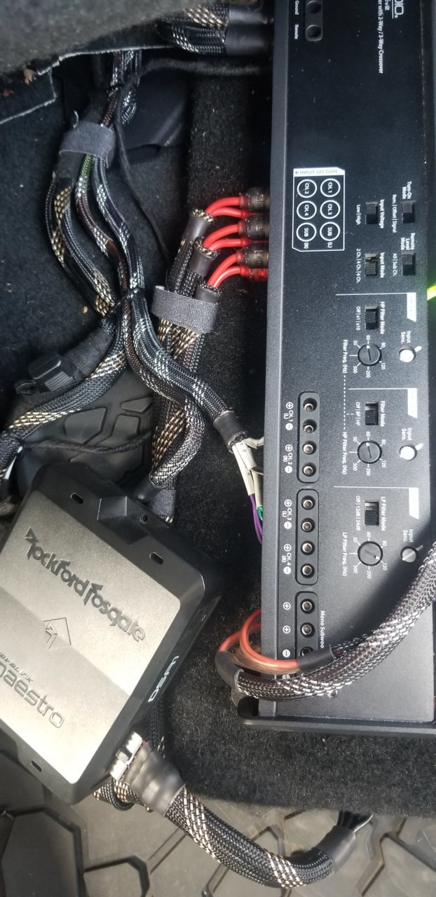

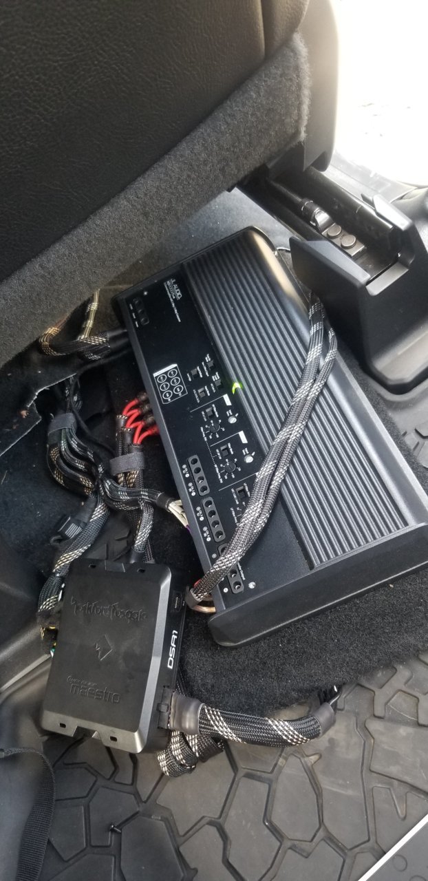

    15
    Got a chance to look under the seat and found one of the sub wires was loose and the amp was not powering on. Refit the wire and everything is working again... wondering if i should still update the dsr1. Normally when i would get the issue i would still see the volume numbers even tho i had no audio and a restart would fix it. This time no volume numbers when turning the knob... so maybe the loose wire was preventing the amp from turning on and i may still have the intermittent no audio...
