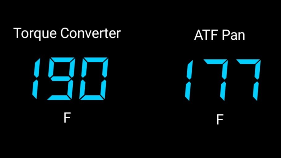

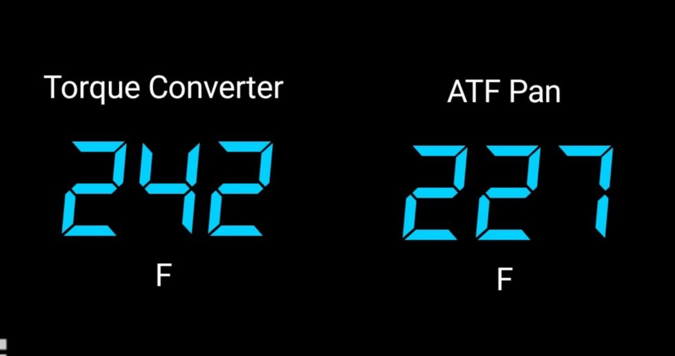

    Mine is a 2020 and 220's-230's was avg trans temp during normal driving, no towing.
    Adding the cooler dropped temps a solid 50 degrees.
    Before cooler:
    After cooler:
