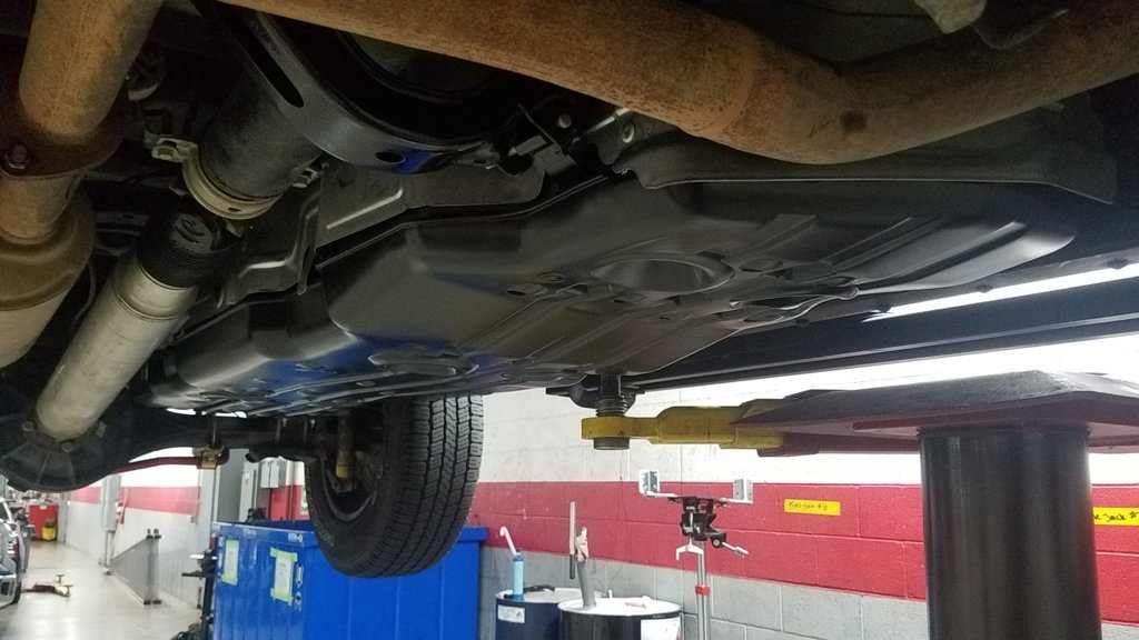

    You are correct, but with a little elbow grease the 38 gallon tank can be installed into any 2007 and up Tundra. Like you said, I had to move the brake lines and space the E-Brake pivot up and we welded the front tank crossmember in and I also changed the straps to the ones with built in studs so I could use the OEM skid plate. the only things I cant fix is the MILES TO empty in the combination meter. The 2010 was never offered with the 38gal so the calculation isn't there. I just know I have an extra 120 miles on top of what my miles to empty says.

    I upgraded my 2016 to the large tank, it’s not a piece of cake but if you are mechanically inclined and have the appropriate tools you can do it yourself. It’s a little harder on a 2014 vs 2016 and up as the 14/15 need holes drilled for the crossmember and the e-brake cable needs modification.
